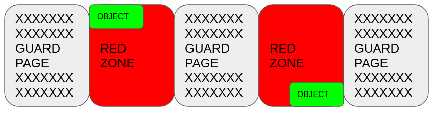

Kernel Electric-Fence (KFENCE) is a sampling based memory safety error detector. It can detect OOB access, UAF and invalid-free errors involving SLUB objects. KFENCE has very little overhead and hence can be used in production systems but as it is a sampling based system it can take some time to detect errors. The only small overhead in KFENCE is memory overhead due to guard pages and this depends on the size of the KFENCE pool i.e. how many objects we want in the KFENCE pool.
KFENCE allocates objects from a pre-allocated pool of objects and after getting freed these objects reside in a separate list, rather than the freelist of that cache.
Each of the KFENCE objects exist at the beginning or the end of a page and are surrounded by guard pages on both sides. Also the remaining area of the page, that contains the KFENCE object, is treated as RED-ZONE.

As mentioned earlier a KFENCE object resides at the beginning or end of a page and is surrounded on both sides by guard pages. These guard pages have their page table entries marked as invalid and hence any access into these pages results in a page fault.
Now suppose we have a KFENCE object at the end of a page. An OOB access for this object would land in the succeeding guard page and cause a page fault. KFENCE uses this page fault to report errors.

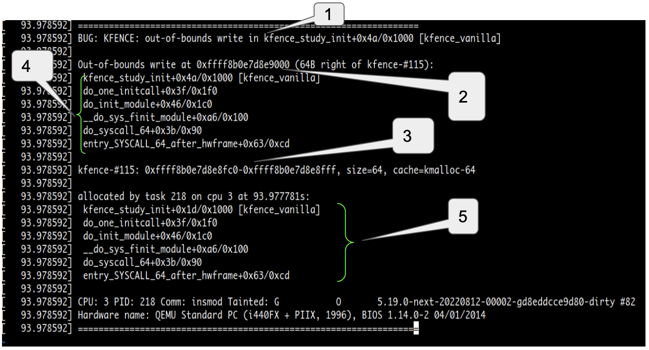

For example lets consider the following report:
Fig 2: OOB access reported by KFENCE
  1. Type of error and location of error detection
  2. Extent and address of OOB access
  3. Description of involved object
  4. Call stack leading to erroneous access
  5. Allocation call stack
In the above example  the kmalloc-64 object was residing at the end of a page. A 1 byte access at offset 64 from its start (i.e. 1 byte beyond the size of the object) landed into the guard page and caused a page fault. Now one may ask  what happens if we access the RED-ZONE preceding this object or if the object resides at the beginning of a page and OOB access lands into the adjacent RED-ZONE. An access into the adjacent RED-ZONE will not cause a page fault since RED-ZONE exists on the same page as the object. For such cases KFENCE checks the RED-ZONE at the time of freeing of the object and if the expected pattern is not seen in the RED-ZONE it reports an error.

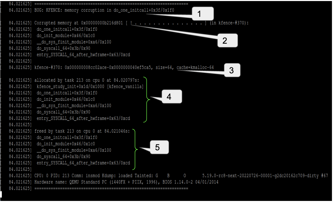

Here’s another example of a OOB access error reported by KFENCE:
Fig 3: OOB access reported by KFENCE as memory corruption
  1. OOB access (memory corruption) detection point
  2. Extent of OOB access (1 ! indicates 1 byte OOB access)
  3. OOB access for a kmalloc-64 object
  4. Allocation call stack
  5. Freeing call stack
In the above snippet a kmalloc-64 (i.e. 64 byte) object was allocated at the beginning of the page. We wrote 1 byte beyond this object but the error was not reported at the time of writing. The error was reported at the time of freeing the object (that’s why we can see the call stack corresponding to the freeing of the object).
Further if we compare it with the earlier OOB report we can see that this has been reported as a “Corrupted memory” error. This is because KFENCE did not catch this error at the time of access (write) but detected it later at the time of freeing. The one ! at the beginning of [ ! . . . . . . . . . . . . . . . ]  indicates that one byte was corrupted and the succeeding dots indicate that bytes after this corrupt 1 byte are all good. If the kernel was booted with no_hash_pointers we would have seen the actual value written at the corrupt byte.

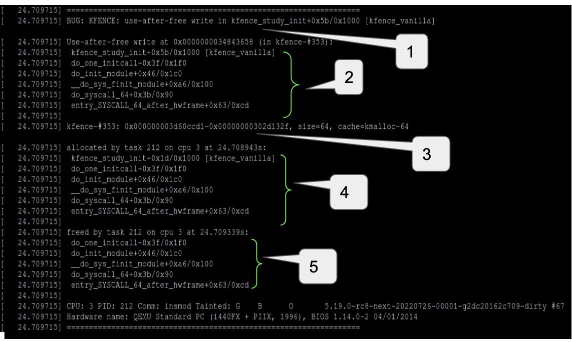

UAF access
KFENCE uses a page fault mechanism to detect a use-after-free (UAF) error. When a KFENCE object gets freed, the page table entry for the containing page is marked as invalid. So a subsequent access to the freed object causes a page fault which is then used by KFENCE to report errors. One example of a UAF report has been given below:
Fig 4: UAF error reported by KFENCE
  1. Type of error and location of detection
  2. Call stack leading to UAF detection
  3. Description of impacted object

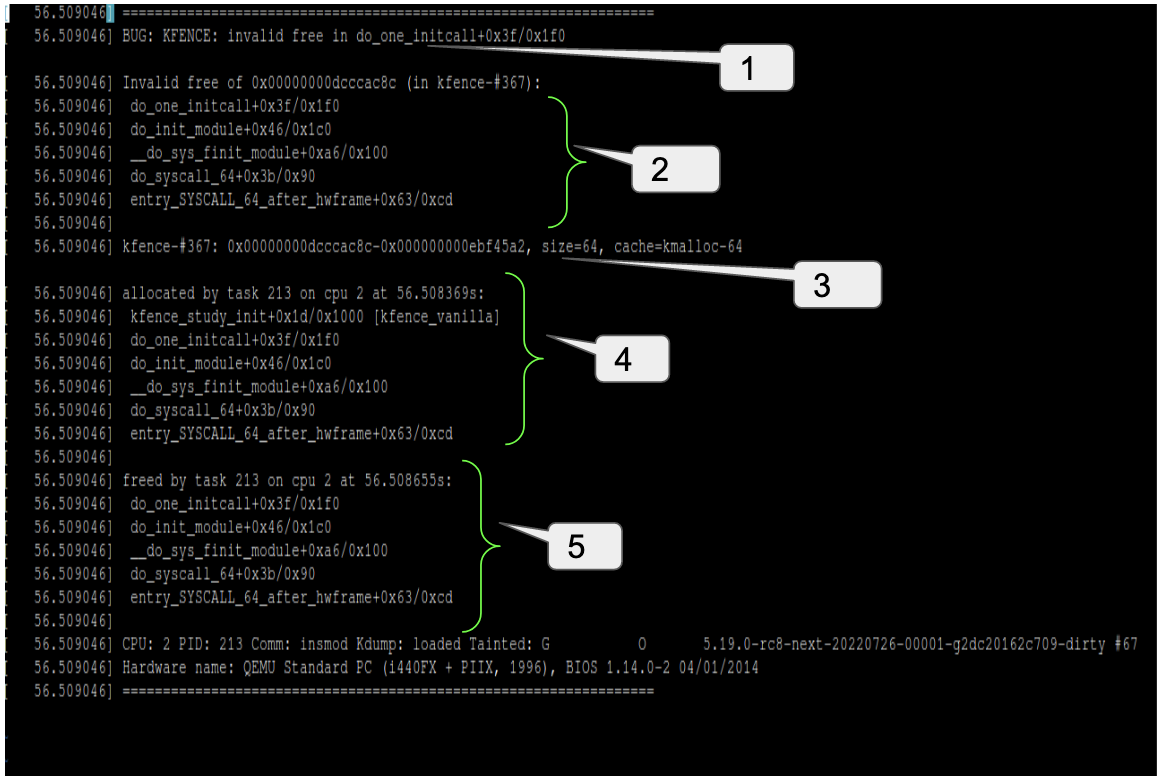

Double free and Invalid free
KFENCE reports both double-free and invalid free (pointer being freed, not pointing to a KFENCE object) as invalid free errors. For each KFENCE object, a kfence_metadata object exists and it contains several pieces of information about the corresponding KFENCE object. Two such pieces of information being the allocation state of the KFENCE object and its starting address. At the time of freeing a KFENCE object if it’s found that object is not in a KFENCE_OBJECT_ALLOCATED state or if the address being freed here is not the starting address of a KFENCE object, an invalid free error is flagged.
For example the following snippet shows that we are freeing an already freed object. We know the object has been freed because the KFENCE report contains the freeing stack trace and also the hash at the start of the KFENCE object (kfence-#367) matches with the hash of the address for which the error was reported (see the line beginning with “Invalid free of”).
Fig 5: Invalid free reported by KFENCE
  2. Call stack leading to invalid free
  3. Description of object for which error was detected
  4. Call stack for last allocation of this object
  5. Call stack for last freeing of this object
