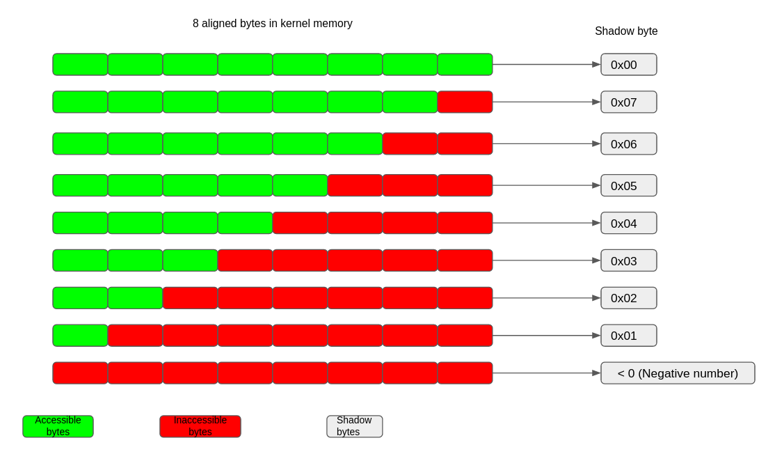

KASan shadow bytes
Fig.1: KASan shadow bytes

  1. Maintaining the state of an 8 byte chunk in a shadow byte

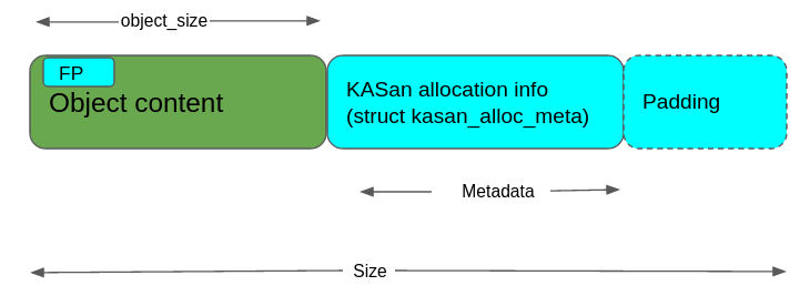

With KASan a SLUB object looks like below:
SLUB object layout with KASan
Fig 2: SLUB object layout with KASan
Like slub_debug, KASan makes use of the idea of REDZONE, but in a different way. With KASan an optimum REDZONE size is calculated based on the object_size. KASan uses the REDZONE area to store allocation metadata (i.e. information about the context that allocated and freed the object) so KASan makes sure that REDZONE is big enough to hold this metadata.
Important point to note here is that with slub_debug the content of the REDZONE is checked to validate the memory access but with KASan only shadow bytes corresponding to the REDZONE is checked to validate the memory access and thus it leaves the REDZONE area to be used for other purposes.

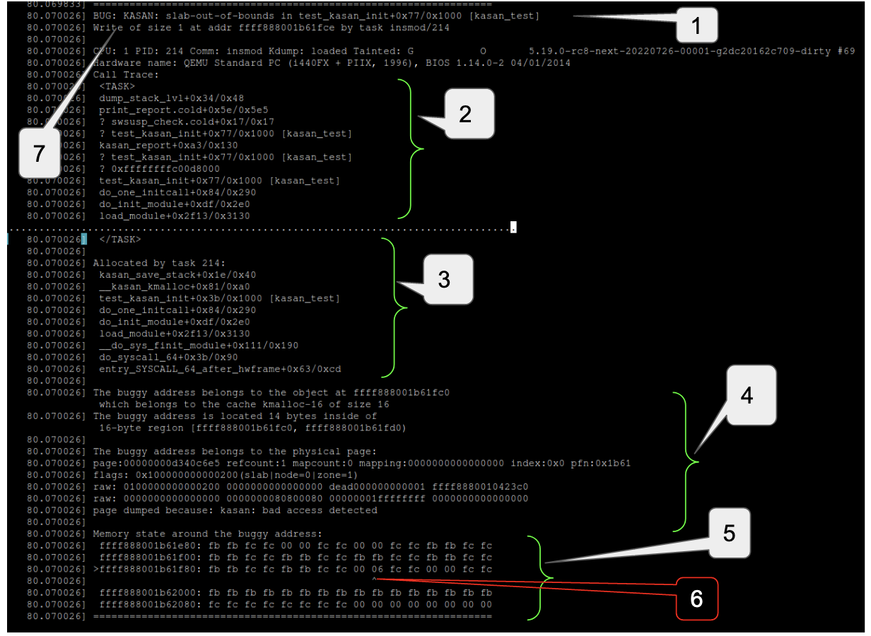

In case of OOB access, the KASan callback ends up reading the shadow bytes corresponding to the REDZONE and from the corresponding value, KASan is able to detect OOB access errors. For example the following snippet shows an OOB access error:
OOB access reported by KASan
Fig 3: OOB access reported by KASan
  1. Type of error and location of its detection
  2. Call stack leading to erroneous access
  3. Allocation call stack
  4. Description of address at which erroneous access happened
  5. State of shadow bytes for and around the address of erroneous access
  6. Shadow byte corresponding to the address of invalid access. 06 indicates that only the first 6 bytes from this 8 byte chunk are accessible
  7. Type, extent and address of erroneous access
As we can see in the above report, KASan reported an OOB access error because we are writing 1 byte beyond the size of the object. The report also mentions the problematic address. Looking at the state of the shadow bytes we can deduce some more information but for that we first need to learn how to interpret the part of the KASan report that describes the state of the shadow bytes i.e. the part of the KASan report that begins with “Memory state around buggy address”. Each line in this section of the report describes the state of the shadow bytes corresponding to the 128 bytes starting from the address given in the first column and from the second column onwards each column indicates the value of a shadow byte corresponding to an 8 byte chunk.
For example in the above snippet the first row of this section indicates the value of the shadow bytes for address 0xffff888001b61e80 to 0xffff888001b61eff, the second row indicates the value of the shadow bytes for address 0xffff888001b61f00 to 0xffff888001b61f7f, the 3rd row indicates the value of the shadow bytes for address 0xffff888001b61f80 to 0xffff888001b61fff and so on and so forth. Further from the first row we see that the shadow byte for 8 byte chunk 0xffff888001b61e80 to 0xffff888001b61e87 contains a negative value (0xfb) so none of these 8 bytes are accessible. Same goes for the next 8 byte chunk from 0xffff888001b61e88 to 0xffff888001b61e8f. Going further in the same row we can see that the shadow bytes for 2 consecutive 8 byte chunks, 0xffff888001b61ea0 – 0xffff888001b61ea7 and 0xffff888001b61ea8 – 0xffff888001b61eaf are each 0 i.e. all 8 bytes in these 2 chunks or these 16 consecutive bytes are accessible.
Further the 128 byte chunk in which erroneous access happened is marked by ‘>’ and the shadow byte is marked by ‘^’. In the above snippet we can see that the problematic access happened somewhere in the 128 bytes starting from 0xffff888001b61f80. Further in the same row the shadow byte corresponding to the chunk 0xffff888001b61fc8-0xffff888001b61fcf is marked with ‘^’ and has the value 06 which means only 6 bytes of this chunk were accessible (this is expected because we are dealing with a 14 byte object here, 8 bytes from previous chunk and 6 bytes from this chunk make those 14 bytes). So we can see that an OOB access error was reported because there were only 14 bytes available but code was trying to write to the 15th byte.
Even if we ignore (or can’t deduce) the state of shadow bytes, the KASan report contains enough information about the error source but having a clear understanding of shadow byte states helps in getting a much clearer picture.

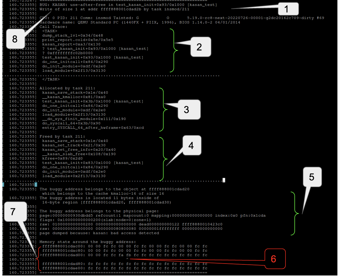

As mentioned earlier once an object gets freed, the shadow bytes corresponding to it are filled with the poison pattern 0xFB (KASAN_SLAB_FREE). If the freed object is accessed, KASan callback detects that the shadow bytes of this object contains the poison pattern corresponding to a freed object and KASan signals a UAF error.
Following snippet is an example of a UAF error report:
KASan UAF report
Fig 4: UAF error reported by KASan
  1. Type of error and location of detection
  4. Freeing call stack
  5. Description of buggy address
  6. Shadow byte for buggy address contains 0xfb (KASAN_SLAB_FREE) indicating that object is free
  7. Shadow bytes around buggy address
  8. Type address and extent of erroneous access
