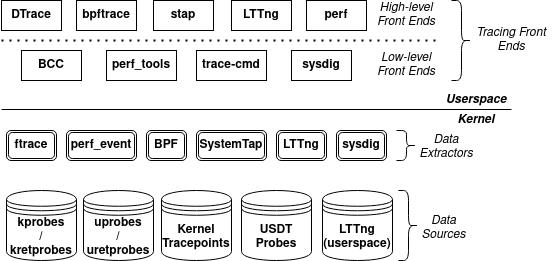

Tracing Terminology:
This diagram is essentially a big picture look into Linux tracing. It’s important to note that this isn’t a complete list of everything that is out there, and not every frontend uses every data extractor or data source.
This page doesn’t go over everything in the diagram above in detail. We’ll focus instead on the data sources, more specifically kprobes/kretprobes, uprobes/uretprobes, kernel tracepoints, and USDT probes. Understanding the different data sources and their capabilities is key to understanding the capabilities of a tracing frontend. For example, sysdig uses none of the data sources listed, and only has visibility on system calls.
One thing worth mentioning is BCC’s relation to the diagram above. As mentioned, BCC is a tracing frontend. A tracing frontend is an application that provides tracing techniques and capabilities (and sometimes sampling as well, like perf).
There are two categories to tracing frontends: low-level and high-level frontends. A high-level frontend is typically a more user-friendly tracing tool suite that you can use to get quick observability on your target. Some high-level tracing frontends are built ontop of low-level frontends, such as bpftrace being build on top of BCC. A low-level tracing frontend is typically more bare bones and less user-friendly, requiring a bit more work on the developer’s side to make use out of them. The benefit of low-level frontends is that you get a bit more flexibility and control over events, data processing and display (although DTrace and bpftrace can provide some of that flexibility and control as well).
BCC is considered a low-level frontend because, well, we have to write our own scripts to use it! In other words, there’s no command to call like there is for DTrace and bpftrace, we’ll be calling our own (typically Python) scripts instead.
One last note: in case you’re unfamiliar, BCC stands for BPF Compiler Collection. The BPF data extractor in the diagram above is this BPF. BPF (or eBPF) provides visibility both in kernel (kprobes/kretprobes, kernel tracepoints) and userspace (uprobes/uretprobes, USDT probes), making BCC a competitive and flexible frontend.

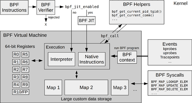

BCC (BPF Compiler Collection) was the first higher-level tracing framework developed for BPF (Berkeley Packet Filter). BPF was an obscure technology developed in 1992 to improve the performance of network packet filtering. In 2013, BPF was rewritten and further developed into eBPF (extended BPF) and included in the Linux kernel in 2014. This rewrite of BPF turned it into a general-purpose execution engine, increasing the potential of the BPF technology drastically.
 This new technology provides the means to run mini programs on a wide range of kernel and userspace application events, such as disk I/O or QEMU. Essentially, it makes the kernel fully programmable, empowering kernel and non-kernel developers to tailor and control their systems in any way they see fit (and BCC makes it quite straightforward to do this).
BPF is considered as a virtual machine due to its virtual instruction set specification (not to be interpreted as another machine layer on top of the processor). These instructions are executed by a Linux kernel BPF runtime, which includes an interpreter and JIT compiler for turning BPF instructions into native instructions for execution.
 BPF also uses a verifier that checks BPF instructions for safety, ensuring the BPF program will not crash or corrupt the kernel. However, it’s not perfect, as it doesn’t prevent the user from writing illogical (but executable) programs. An implicit divide by zero error, for example, would not be caught by the verifier. An unbound for loop, however, would be caught by the verifier.

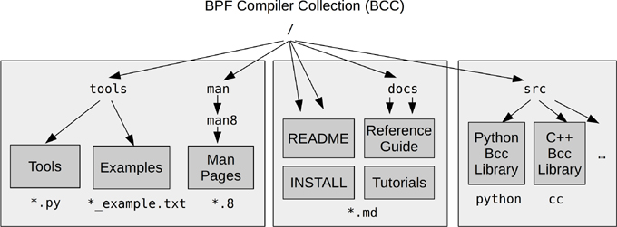

Other Features: Tutorials, Premade Tools, Reference Guide
Aside from all of the technological features that BCC has to offer, it also comes with a plethora of examples, tutorials, and pre-made tools. These are all very useful and you’re definitely going to want to check them out if you haven’t already.
There are two tutorials included in the BCC repository: a tutorial for using BCC tools to solve performance, troubleshooting, and networking issues, and a BCC BPF Python developer tutorial to get you started making your own BPF programs in C and Python. This is what we’ll be doing when creating some examples in the next section, except these examples are my own and meant to compliment BCC’s Python developer guide. That is, once you’ve gone through my examples, you’ll want to also go through the BCC developer guide’s examples as well.
- docs/tutorial.md: Using BCC tools to solve performance, troubleshooting, and networking issues
- docs/tutorial_bcc_python_developer.md: Developing new BCC BPF programs using the Python interface

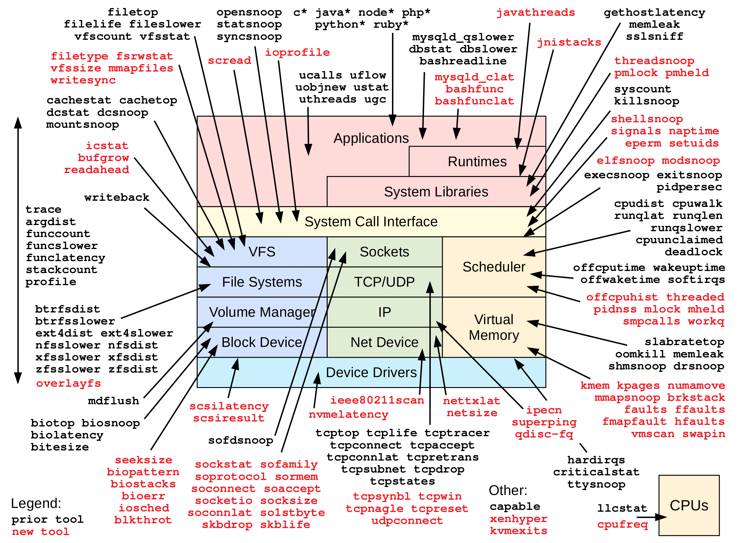

 The pre-made BPF tools that come with BCC can be found in tools/*, and there are lots of them! Each tool comes with their own *.txt file that acts like a manpage for that tool. Some of these tools include:
- tools/biolatency.py/txt: summarize block device I/O latency as a histogram
- tools/cpuunclaimed.py/txt: sample CPU run queues and calculate the unclaimed idle CPU
- tools/hardirqs.py/txt: measure hard IRQ (hard interrupt) event time
- tools/klockstat.py/txt: traces kernel mutex lock events and displays lock statistics
- etc. …
You can find the complete list of these pre-made tools on the front page of the BCC GitHub repository (README.md)
Lastly, we also have the BCC reference guide. It should be noted that you may not find everything in here and there are some missing API entries (i.e. bpf_usdt_readarg()). However, most of the things you’ll need are listed here, and if not explicitly, you can find example usages in the pre-made tools and examples to help you out.
- docs/reference_guide.md: reference guide to the BCC/BPF APIs
