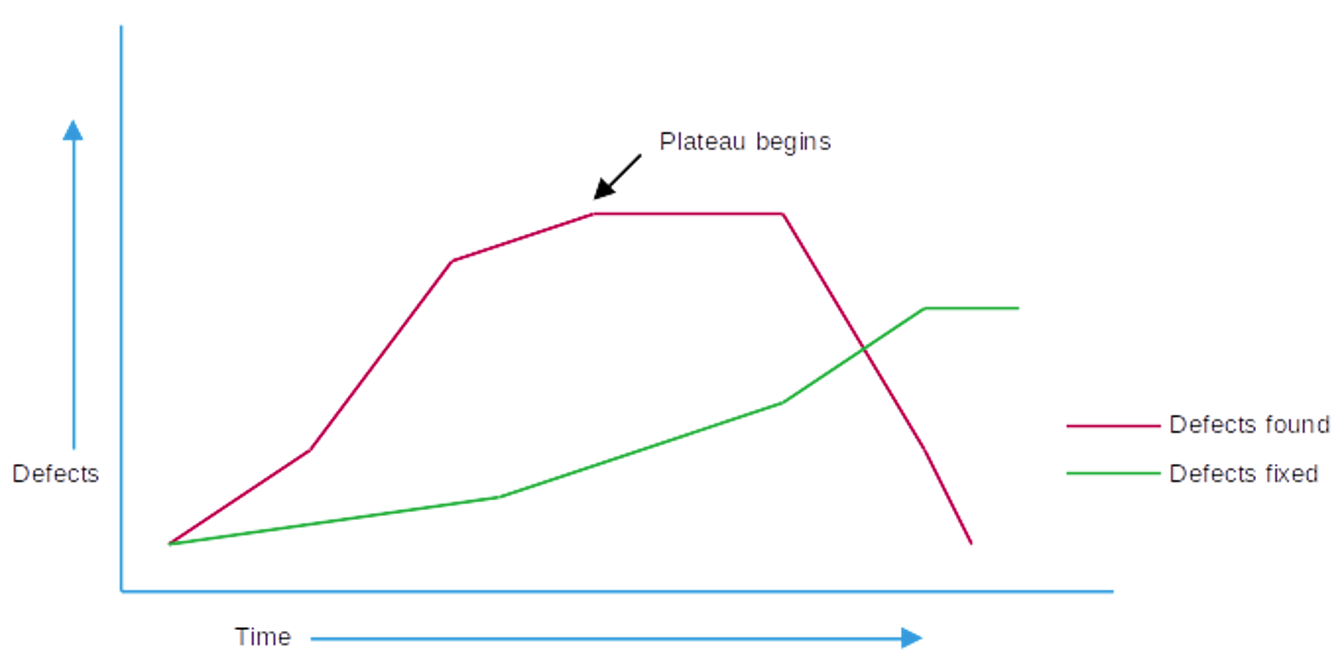

- Software quality. This includes defect tracking charts such as those shown in Figure 1, which measures rates of defects per release, team, and developer. However, realize that more-productive developers may also generate more defects as they complete more stories in a given time frame compared to others. Therefore, leverage tools that track defects to stories over time, essentially turning the measurement into a percentage, to get a more accurate view.
Figure 1. Software defect tracking chart
Also, bear in mind that rates of defects change over the lifetime of a project. Defects will ramp up early in the development cycle, and then they will plateau and drop off rapidly if they are fixed efficiently. I once had a manager who gained an accurate view of top performers on our development team not by measuring the number of defects but by tracking when the counts plateaued, how quickly the defects were resolved, and how often defects were reopened (indicating an ineffective fix was implemented).
