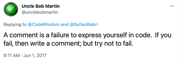

And because undervaluing is the rule, developers learn to blame comments rather than the culture that allows them to get out of sync with the code. This negative view is articulated by Bob Martin’s assertion that every comment represents “a failure to express yourself in code” (see Figure 1). Note that in his book Clean Code, Martin makes this curious statement and then spends 15 pages enumerating the many instances when comments are highly useful.
uncle bob martin tweet on comment
Figure 1. Bob Martin has strong views about comments.

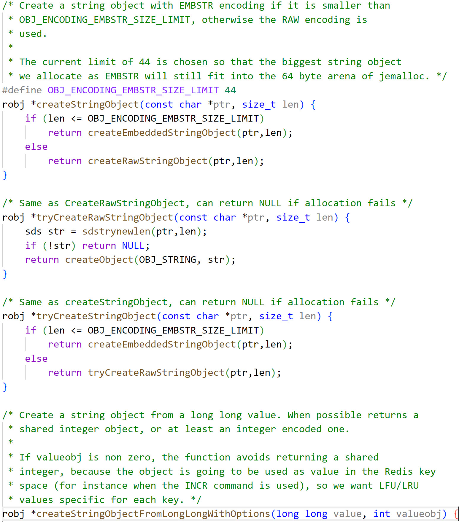

an example of excellent commenting
Figure 2. An example of excellent commenting.
