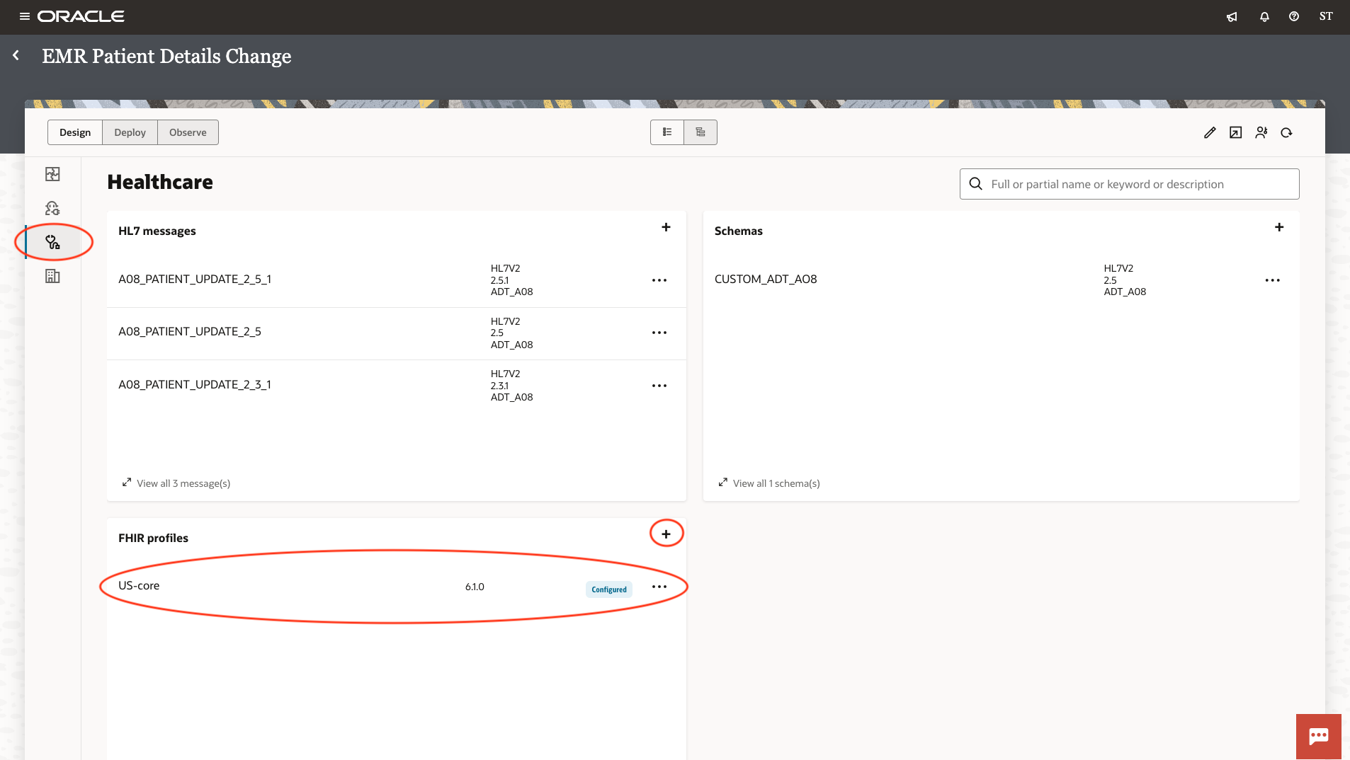

In this latest release, you can upload a FHIR NPM package (explained here) that contains the customized profiles that you want to work with in your integrations. We have tested the packages listed below with OIC, but feel free to try any package. We want to reach the point where you can upload any FHIR profile into OIC. However, due to the many different variations that can exist in the way profile customizations are made and packaged, some profile packages currently do not work. You can upload a package into OIC project by clicking the stethoscope icon and then the ‘+‘ button in the FHIR profiles section. See the screenshot below.
FHIR Profiles
