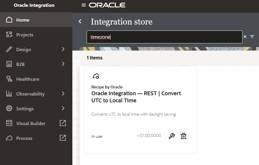

To get this recipe, navigate to Oracle Integration 3 home page, scroll to the Accelerators & Recipes section, and search with time zone. Select the package Oracle Integration — REST | Convert UTC to Local Time, and then click install. Once the Recipe has been installed, configure the REST connection as per recipe documentation and activate.
As per the JSON payload specified in the Oracle documentation, you can test your recipe. To get TZ identifier for your customer you may refer below link, or you may open the lookup ORCL-OIC_WORLD_TIMEZONE_LOOKUP in the recipe where time zone across the world had been consolidated.
https://docs.oracle.com/cd/B13866_04/webconf.904/b10877/timezone.htm
To test the integration, you need to pass the input datetime in UTC along with the time zone in required JSON format. After successful execution, integration will return source time, day light saving start date time, end date time & converted local time. In case the country doesn’t not follow day light savings then only returns source time & converted local time. Same integration can be reused from other integration or project to convert UTC time zone to local time zone.
