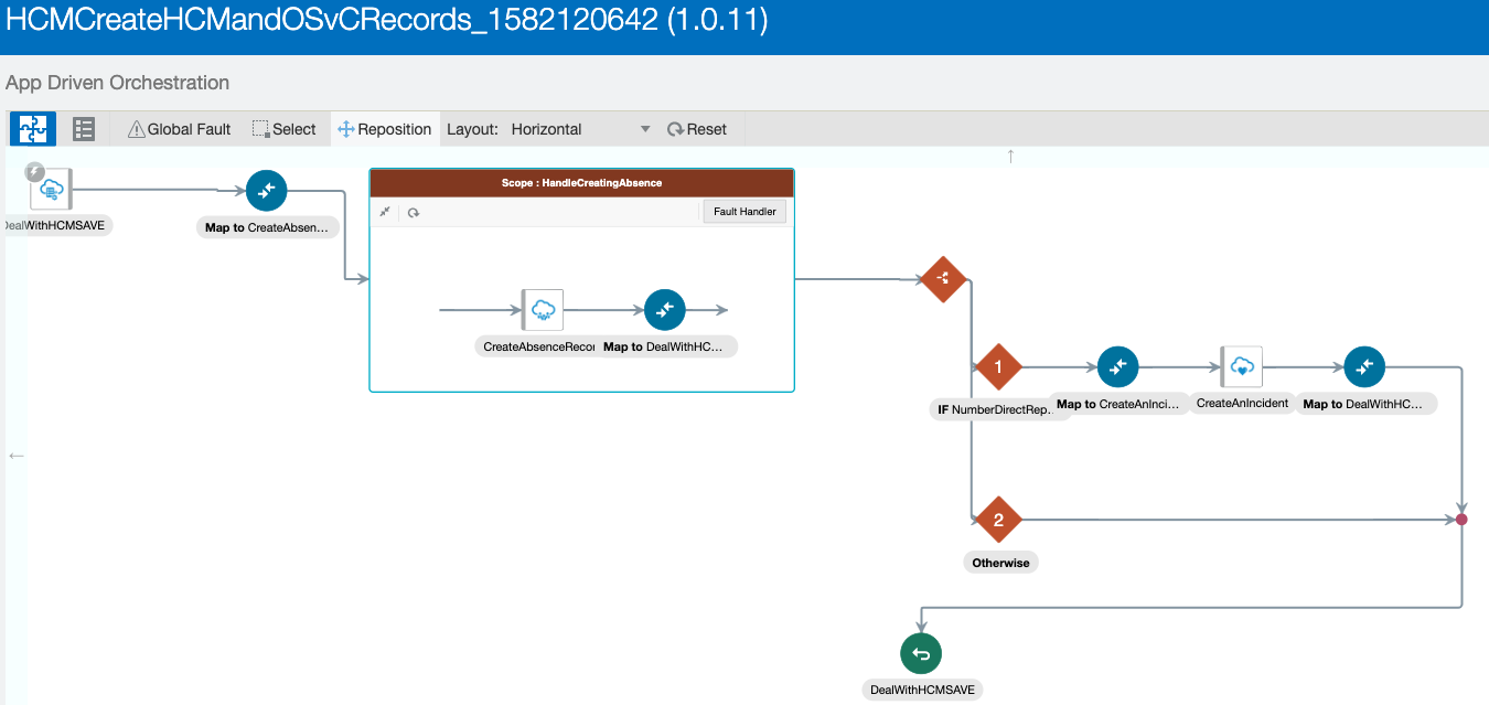

Next open the HCMCreateHCMandOSvCRecords Integration, as shown below
Edit the DealWithHCMSave step to update to use SAVE v1 operation
Add Tracking Info – PersonID and then save and activate the Integration.
Once both Integrations are activated then you can go back to the deployment in your Intelligent Advisor Hub and now you should be able to active the deployment.
