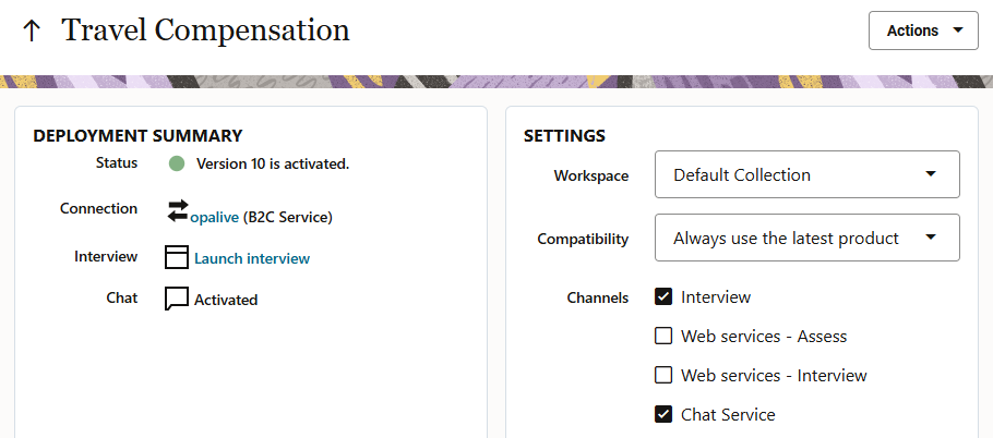

The process of defining a chat Intelligent Advisor interaction is pretty much the same as for an interview – simply define the screens in Policy Modeling, enable the Chat Service channel on your Intelligent Advisor Hub, and you’re good to go.
The Travel Compensation deployment in Intelligent Advisor Hub showing it enabled for Chat Service
The same interview can also be deployed through other channels as usual.
The Chat Service is a REST interface that once initiated will serve up one question at a time (irrespective of how many questions are contained on the screen) and present any informational text, until it reaches a final screen.

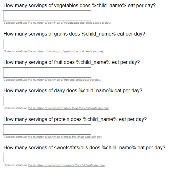

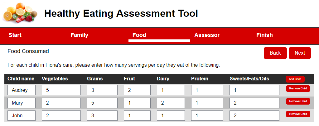

More specifically, the common structure of collecting entity information through a table is simply not going to work in chat.
For chat, you’re going to need to collect the entity as one input (here “the child”) and then collect the entity level inputs as individual questions.
You might like to use formatting to accentuate the slight differences in wording between each question. For example, How many servings of <b> protein </b> does %child_name% eat per day? If your chat client doesn’t support html, then CAPITALISING the key word may be an acceptable alternative.
