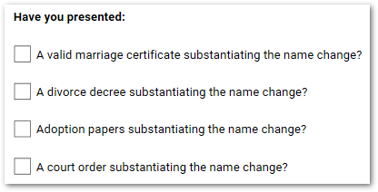

Example 1. Using multiple Booleans
The simplest implementation is to use a label followed by checkboxes to select multiple Boolean attributes. This will have the appearance of allowing the user to select multiple values for an attribute but in reality is setting multiple attributes. An example of this is in the DMVDocGuide example project (available in Policy Modeling) where checkboxes for separate Boolean attributes (relating to name change documents) are preceded by a single label:

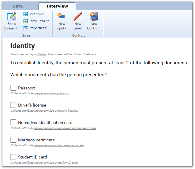

Example 2. Using multiple Booleans where the user needs to select 2 of 5 options
A more advanced example would be where you want to limit the number of Boolean options that the user can select. For example, where the user needs to present at least 2 identification documents from the list of 5 documents to satisfy ID requirements.

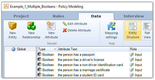

Here you could have a Boolean attribute for each of the 5 options:

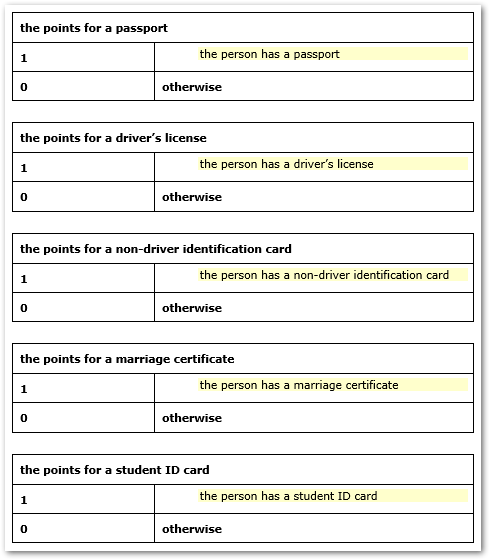

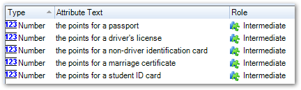

as well as a corresponding number attribute for each Boolean:
Then you could have rules to set each number attribute to ‘1’ if the Boolean is selected and ‘0’ if the Boolean is not selected:

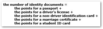

Another rule could be used to calculate the total of the number attribute values. This will equal the number of Booleans that were selected:

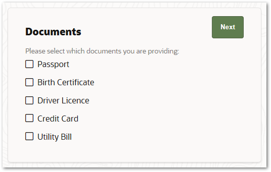

An interview screen could ask which documents the person has presented (using a label) followed by checkboxes for each of the 5 Boolean attributes:
If the user selects 2 or more checkboxes, they will be deemed to have established proof of identity.
However, if they only select 1 (or none), then they will be deemed to have not established proof of identity.

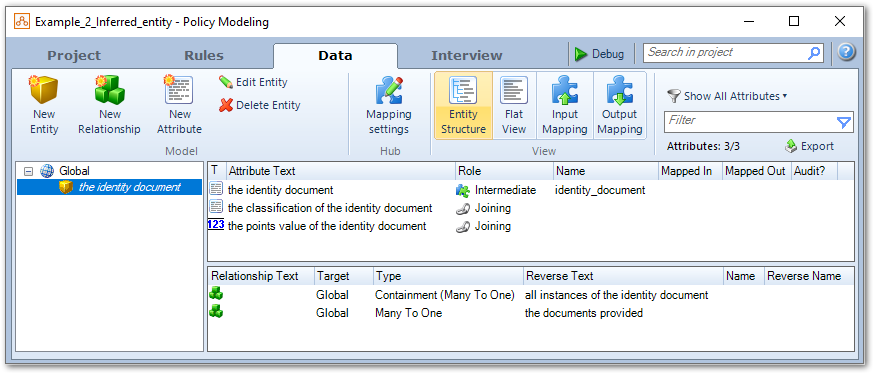

Here you could use an inferred entity for ‘the identity document’:
with a relationship ‘the documents provided’:

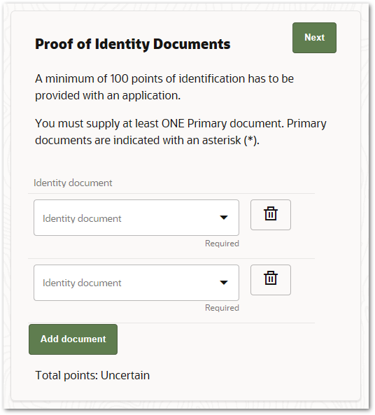

This appears on screen as:

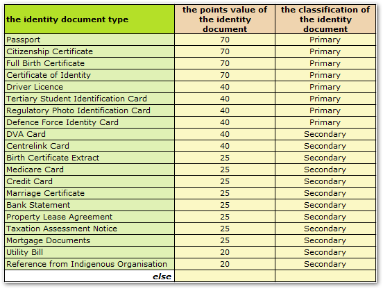

Additional conclusions can be added to your Excel rule table to determine the classification and the points value of the identify document:

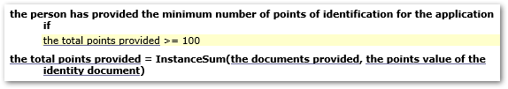

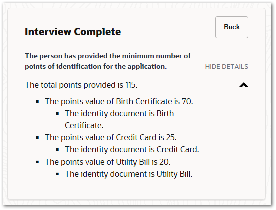

You could then infer that the person has provided the minimum number of points of identification for the application if the total points value for all documents is at least 100:

If the user selects a combination of identity documents whose points value is at least 100, then they will be deemed to have established proof of identity.

Example 4. Using entity instances collected on screen
Another alternative when you have a longer list of options is to use entity instances collected on screen.
This example is similar to Example 3, but in this case, the identity document instances are not inferred, but collected on screen. This allows the user to incrementally enter selections, and duplicate previous selections.

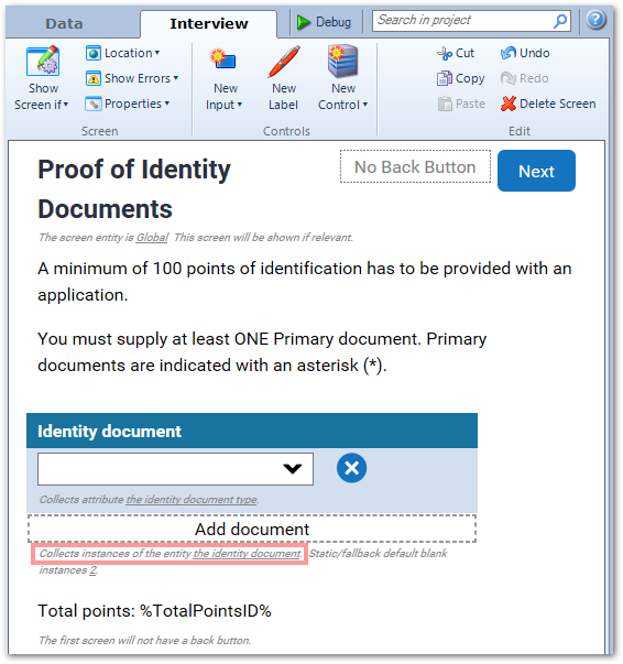

Here you would use a standard child entity for ‘the identity document’:
Then a screen could collect ‘the identity document’ entity instances:
which presents to the user as individual inputs:

You could sum the total points of identification and show this value as a label on screen (the value will update automatically as the user changes their identity document selections).

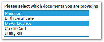

Example 5. Using an interview extension
Alternatively, if the styling you are going for is more of a multi-select fixed or drop-down list box, then you may like to write an interview extension to render the input control as a multi-select list box matching your corporate styling. For example:
