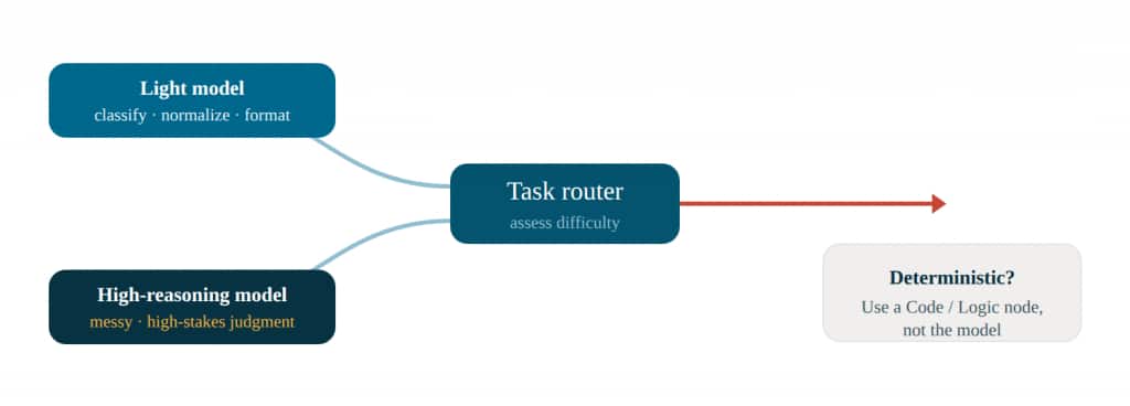

3.  Pick the right brain for each task
Reserve high reasoning for where it changes the outcome — not everywhere by default.
Not every step deserves the heaviest model. Routing a simple classification through a high-reasoning model buys you latency and cost with no accuracy gain. The discipline is to match model strength to task difficulty—and to keep deterministic work out of the model entirely.
Match model to task
  • Use a stronger, high-reasoning model for messy or high-stakes extraction and judgment—where correctness is hard and matters.
  • Use a lighter model for simple classification, normalization, and formatting—it lowers latency and cost without hurting quality.
  • Set standard defaults with clear upgrade criteria so behavior stays consistent across teams.
  • Use the LLM mainly at decision points—not for deterministic actions.
Send each step to the lightest capable brain. Push fixed transforms to Code and Logic nodes so the model only reasons where reasoning is needed.
MODEL CHOICE
Choose from the models on offer by capability, not by name
AI Agent Studio lets you pick from several models that trade reasoning depth against speed. Choose per step: default to a faster, lighter model, and reach for higher reasoning only on the hard, high-stakes steps that genuinely need it. Check modality too—if a step ingests images or documents, pick a model whose input profile supports it. And because the available models change over time, choose by capability profile rather than by a specific name.
Default toward faster, lighter models; move toward higher reasoning only for the steps that need it.

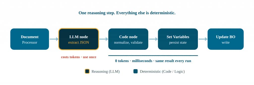

Use a Code node instead of the LLM for deterministic work
A Code node runs straight-line JavaScript: it returns the same result every time, costs nothing in tokens, runs in milliseconds, and—unlike the LLM—isn’t bound by token limits. Determinism is itself an accuracy win: a calculation or validation should never vary run to run. Reach for a Code node when the step is mechanical:
  • Data normalization — convert dates, currencies, and codes into canonical formats (e.g., “Feb 1” → 2026-02-01; “USD 1,200” → {amount:1200, currency:”USD”}).
  • Schema validation & guardrails — check extracted fields against a required schema; set needsClarification and route on failure rather than letting bad data flow downstream.
  • Threshold & business math — compute policy flags such as overThreshold = amount > 500 or variancePct = (invoice – po)/po to pick the auto-fix vs. approval path.
  • Payload shaping — map internal variables into the exact REST or Business Object update contract before a write.
  • Idempotency keys — generate a stable key from {workflowRunId + objectId + action} to prevent duplicate writes when a step retries.
  • Conditional logic & structuring — handle if-else branches not covered by predefined nodes, and reshape data into JSON, arrays, or HTML for the next step.
A typical extract-and-update flow: the LLM runs once to turn a document into structured JSON, then Code and Set Variables nodes do the parsing, validation, and state-keeping the model shouldn’t be paying tokens for.

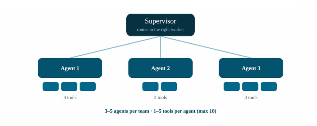

AGENT TEAMS
Keep teams small and tool sets tight
In a supervisor / agent-team pattern, the supervisor’s job is to route to the right worker. The more agents and tools it must choose among, the slower and less reliable that routing becomes. Size the team deliberately:
  • 3–7 agents per team. If you need more than seven, split into separate workflows to preserve clarity.
  • 1–10 tools per agent for optimal performance—not more than ten. If an agent carries more than five tools, they should be closely related.
  • Give each agent a distinct role or persona so the supervisor’s routing decision is unambiguous.
Small, well-scoped teams keep the supervisor’s routing decision crisp—and crisp routing is fast, accurate routing.

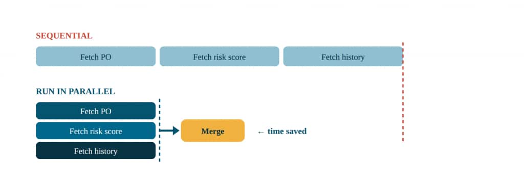

5.  Run independent work in parallel
If two steps don’t depend on each other, there’s no reason to wait for one before starting the other.
Sequential execution is the right default only when steps depend on each other. When they don’t, the Run in Parallel node fans the work out and merges the results—cutting wall-clock time sharply for tool-heavy agents.
Good candidates for parallel execution
  • Fetching two unrelated records at once.
  • Pulling policy from one source and data from another.
  • Validating multiple independent inputs simultaneously.
  • Gathering reference material from several places, then merging into one decision payload.
The rule: parallelize reads and analysis—not conflicting system writes. Only fan out work that is genuinely independent. (Note that a Human Approval step can’t live inside a parallel branch, so keep approvals on the main path.)
Three independent reads run concurrently and merge into one payload, collapsing three waits into one.

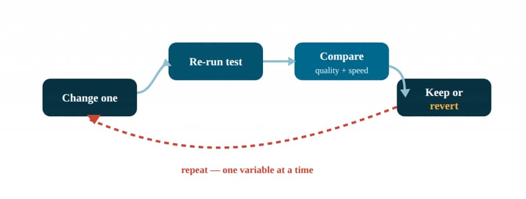

6.  Measure, trace, and tune one change at a time
You can’t fix what you can’t see — and you can’t learn from changing five things at once.
Every change above should be verified, not assumed. AI Agent Studio’s METRO capabilities—Metrics, Evaluation, Tracing, Reporting, and Observability—let you find the real bottleneck and confirm that a fix helped accuracy without quietly hurting it.
Find the bottleneck before you tune
  • Use the agent dashboard to watch Accuracy, Latency, and Token Usage together.
  • Review the step-by-step trace timeline—sequence, duration, and status per step—to spot repeated tool calls, long pauses, unnecessary branching, and slow paths that only trigger in certain scenarios.
  • Fix the single biggest bottleneck first; often one oversized payload or one redundant call is the real cause.
Tune deliberately, and guard accuracy with evaluations
  • Change one thing, re-run the same test prompt, and compare both speed and output quality.
  • Keep the change only if quality holds and performance improves.
  • Maintain evaluation sets with reference answers (golden datasets) so a latency or cost optimization can’t silently regress correctness.
Isolating one variable per pass is slower at first, but it’s the only way to know which change actually helped.
