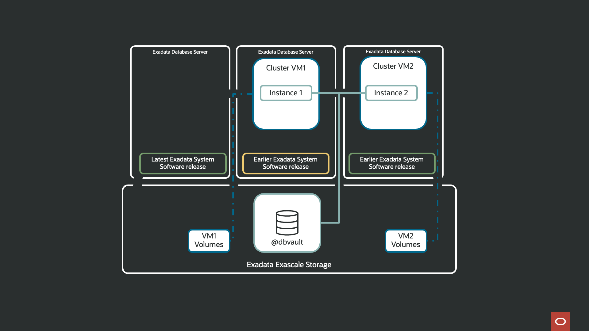

In the example below we see an Exadata system with three KVM hosts, two of which have been updated with the latest Exadata System Software release, and one which has not yet. We also have a 2-VM cluster, one VM on an updated KVM host, the second on the KVM host with a previous release of the Exadata System Software. In this environment, one of the KVM hosts is empty allowing us to update it–and reboot it to enable the latest kernel and firmware to be activated. We can then move one of the VMs to the updated KVM host using OEDACLI. This evacuates or empties the KVM host that requires updating and allows it to be rebooted without further impact to VMs.
