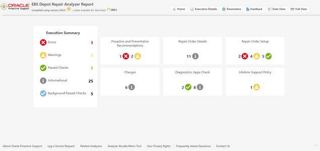

 The Oracle EBS Depot Analyzer is a tool designed to review and report improper settings in Depot Repair module. It collects repair order details, charges information, set up and identifies known issues. Running this analyzer proactively and regularly, will help in early detection of known issues and provide recommendations to resolve them.

 The analyzer is so convenient, you can even execute it as a Concurrent Program. This analyzer may also be used as data collection tool for troubleshooting.
 Learn more about the new and improved Depot Repair Analyzer in Doc ID 2280570.1
