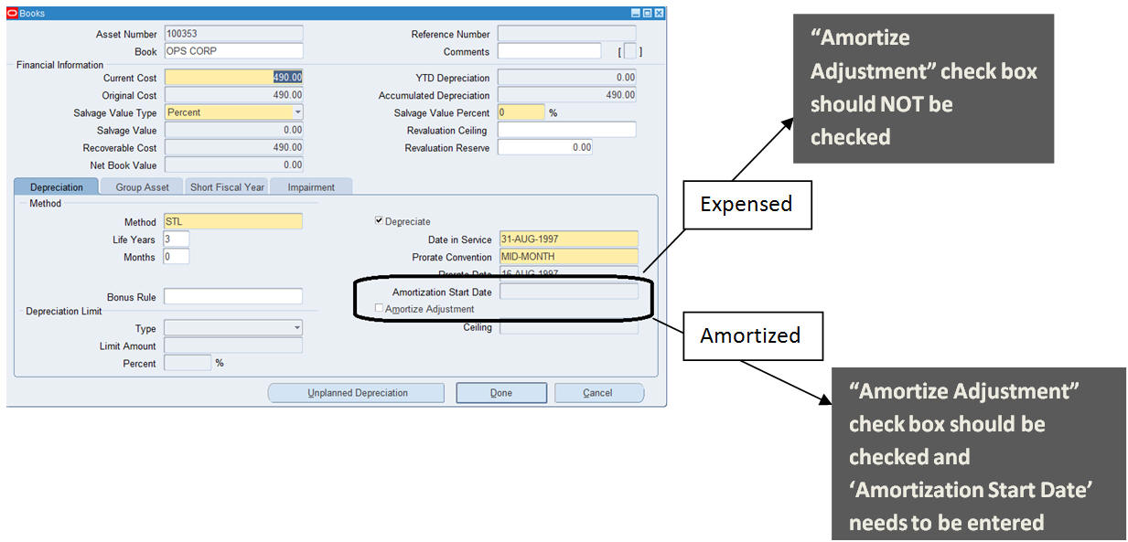

How do you perform an Expensed or an Amortized adjustment?
While performing the transaction, whether it is expensed or amortized depends on these selections:
