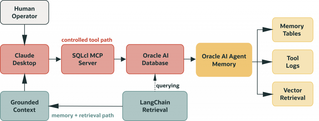

Here is how those components connect in this pattern. Claude talks to Oracle through SQLcl MCP, using the tools and database permissions you expose. Oracle AI Agent Memory is the Python package your app uses to manage durable memory records and context assembly. LangChain is an optional wrapper at the end of the retrieval path. The knowledge base is data in Oracle tables, with retrieval and access governed by your application and database design.
Production success depends less on “prompt quality” and more on boundaries, privileges, logging, and repeatable runbooks. 

Conceptual workflow showing Claude Desktop connecting to Oracle AI Database through SQLcl MCP, with Oracle AI Agent Memory and LangChain used for durable memory and retrieval paths.
Controlled Claude MCP + Oracle AI Database Workflow 

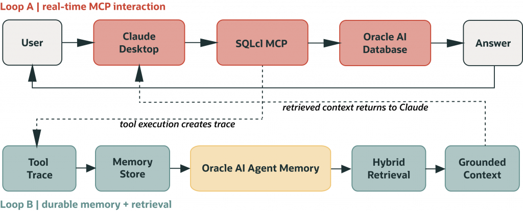

Understanding the two execution loops 
Building on the separation of responsibilities above, the system naturally forms two execution loops: 
  • Loop A: An operational loop for real-time interaction (Claude + MCP): This is the real-time interaction where Claude works with MCP to run queries, inspect data, and respond immediately. 
  • Loop B: A persistence loop for cross-session memory (Oracle AI Database + LangChain): This is where Oracle AI Database and LangChain handle durable memory records, tool logs, and context retrieval across sessions. 
One loop handles real-time interaction, the other handles durable memory records and retrieval. 
SQLcl MCP is for Claude operating interactively- real-time queries during a conversation, routed through a declared tool contract. Oracle AI Agent Memory is for your application code- storing turns, retrieving history, assembling context before Claude sees a prompt. They serve different loops at different times. You can drop either one depending on your use case, but many production setups benefit from both.
Dual execution loop diagram showing Claude and SQLcl MCP for interactive tool calls, and Oracle AI Database with LangChain for durable memory records and retrieval.
Dual Execution Loop: MCP Interaction and Durable Memory 

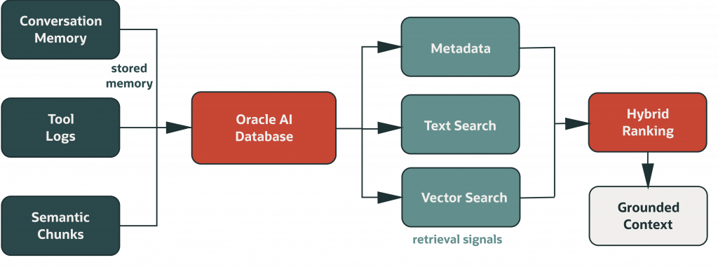

Why put application memory records in Oracle AI Database, not just outputs 
Once your first tool calls work, the next challenge is continuity. If memory lives only in chat context, the system is fragile. If memory is scattered across files without structure, retrieval and auditing become expensive over time. 
It’s worth calling out the difference here. At this point, the challenge shifts from conversation persistence to system-level memory. 
A model that uses Oracle AI Agent Memory is often cleaner and easier to operate as the workflow grows. 
The companion notebook builds this memory layer from scratch, so the mechanics are visible and then shows how Oracle AI Agent Memory slots on top of it once the substrate is working.
Memory categories that matter in practice 
  • Conversational memory 
    Stores user and assistant turns, thread IDs, timestamps, and metadata. 
  • Operational memory 
    Stores tool inputs, outputs, status, and error classes for troubleshooting and audit. 
  • Semantic memory 
    Stores chunks and embeddings for meaning-based retrieval when exact keywords are absent. 
Why this matters technically 
  • SQL tables give deterministic filtering and ordering. 
  • Transactions improve integrity under concurrent writes. 
  • Vector retrieval helps with paraphrases and conceptual matches. 
  • Keeping memory on one platform makes it easier to manage, audit, and keep consistent over time.
This works well with Oracle AI Database because structured records and semantic retrieval data can stay in one place.
Oracle AI Database Memory and Retrieval Model 

  • Check whether retrieval results become less accurate as more data is added.
Reliability model 
  • Prefer deterministic SQL patterns with bounded result sets. 
  • Use retrieval-first context assembly for memory-heavy tasks. 
  • Avoid giant context stuffing as a substitute for memory design. 

Retrieval quality failure: answers are fluent but weakly grounded 
Inspect the retrieved records before blaming the model. Check chunk size, metadata filters, embedding choice, top-k settings, and whether the query is asking for exact history, semantic similarity, or operational logs. 
Why the hybrid model is a strong long-term default 
By this point, you’ve probably noticed a pattern: no single layer handles both execution and memory well. 
Trying to force everything into the assistant gets messy fast. You either lose control over execution, or you end up stuffing too much context into prompts just to keep things working. On the other side, if you only build backend memory systems, you lose the speed and usability that makes assistants useful in the first place. 
The hybrid approach works because it doesn’t try to solve everything in one place: 
  • Execution stays controlled through MCP. 
  • Memory stays durable and queryable in the database. 
  • The two are connected where needed, not tightly coupled. 
In real teams, this usually evolves over time. It starts simple: Claude with SQLcl MCP, read-only access, and basic workflows. Once people start relying on it, the gaps show up: we lose context, we can’t trace what happened, or we are repeating work. 
That’s when it makes sense to introduce Oracle AI Agent Memory and retrieval. Not earlier. 

Oracle AI Agent Memory sits between your application code and Oracle AI Database. The package manages threads, durable memories, scoped retrieval, and context cards, while Oracle AI Database remains the storage and enforcement layer underneath.
Where does LangChain fit? 
LangChain is an orchestration layer for tools and retrieval. It can help assemble context and retrieval pipelines, but permissions still belong in the database, infrastructure, and application runtime. 
