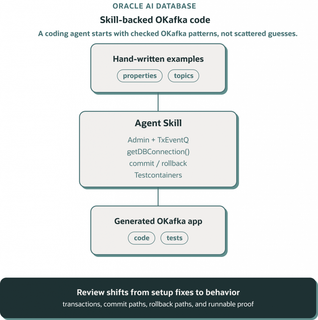

Diagram showing how hand-written examples feed an agent skill containing OKafka administration, transaction handling, database connections, and Testcontainers patterns. The skill generates an OKafka application and tests. Review effort shifts from setup corrections to validating transaction behavior, commit paths, rollback handling, and runnable proofs.
Skill-driven generation of OKafka applications with validated transaction patterns.
In my own work, I found most coding agents weren’t generating high-quality code for Oracle AI Database’s Kafka Java API (OKafka). You can get results, but they’re not idiomatic, and miss subtleties. This is why I created the okafka-java-code oracle agent skill, based off my hand-written Kafka Java API examples.
Agent skills can greatly enhance code generation for Oracle AI Database apps, and this skill encapsulates solutions to the problems I kept hand-coding: how to authenticate with OKafka, how to use transactions, how to create topics, and how to use Oracle-specific serialization.

This is a standard agent skill, with markdown references to code snippets implemented by my samples:
skills/okafka-java-code
├── agent-skill-okafka-java-api.md
├── agents
│   └── openai.yaml
├── references
│   ├── authentication-and-properties.md
│   ├── dependencies.md
│   ├── oson-serialization.md
│   ├── producer-consumer.md
│   ├── testing-and-troubleshooting.md
│   ├── topics-and-admin.md
│   └── transactions.md
└── SKILL.md
Each reference markdown file covers specific areas of OKafka Java code: initializing OKafka classes, serialization, authentication, testing, and transactional workloads.

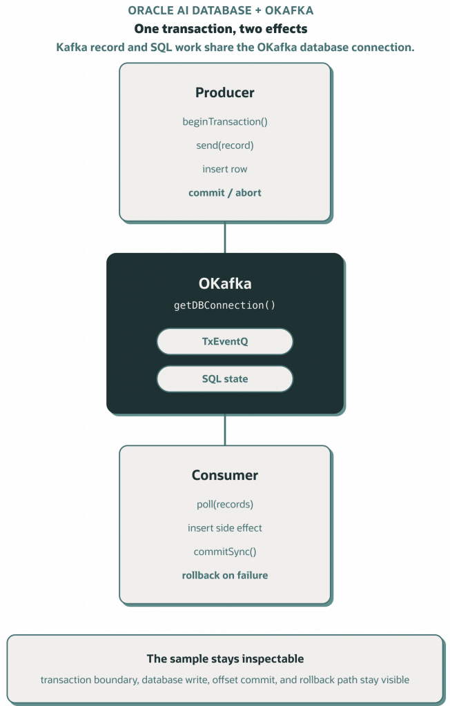

The generated app creates a transactional event flow around Oracle AI Database Transactional Event Queues:
  • TopicAdmin creates the topic through Kafka Admin with OKafka’s AdminClient.
  • OkafkaProperties builds base properties and adds producer or consumer settings in separate methods.
  • TransactionalEventProducer sends a record and writes to produced_events through producer.getDBConnection() before commitTransaction().
  • TransactionalEventConsumer writes consumed records through consumer.getDBConnection() and calls commitSync() only after the database work succeeds.
  • TransactionalEventsIT starts an Oracle AI Database Free container with Testcontainers, applies the OKafka grants, creates a topic, and verifies producer commit, producer abort, and consumer rollback behavior.
This producer method is the kind of output I wanted to nudge agent stoward:
private void publish(BusinessEvent event, boolean failAfterDatabaseWrite) throws Exception {
    producer.beginTransaction();
    try {
        producer.send(new ProducerRecord<>(topic, event.id(), event.payload())).get();
        insertProducedEvent(producer.getDBConnection(), event);
        if (failAfterDatabaseWrite) {
            throw new IllegalStateException("Simulated failure before producer commit");
        producer.commitTransaction();
    } catch (InterruptedException exception) {
        Thread.currentThread().interrupt();
        abortAndRethrow(exception);
    } catch (Exception exception) {
You can see the transaction boundary, the Kafka send, the database write, and the abort path in one place.
Diagram showing a transactional OKafka workflow. A producer begins a transaction, sends a Kafka record, inserts database rows, and either commits or aborts. A consumer processes records, applies side effects, commits offsets, and rolls back on failure. Kafka records and SQL state share the same Oracle Database transaction boundary.
Transactional OKafka pattern coordinating Kafka messages and database changes.
The consumer side follows the same idea:
private void persistAndCommit(ConsumerRecords<String, String> records, boolean failAfterDatabaseWrite)
        throws Exception {
    Connection connection = consumer.getDBConnection();
    try {
        for (ConsumerRecord<String, String> record : records) {
            insertConsumedEvent(connection, record);
            throw new IllegalStateException("Simulated failure before consumer commit");
        consumer.commitSync();
        connection.rollback();
        throw exception;
The generated code preserves the important bits: database work happens on the consumer’s OKafka connection, and the offset is committed only after that work succeeds.

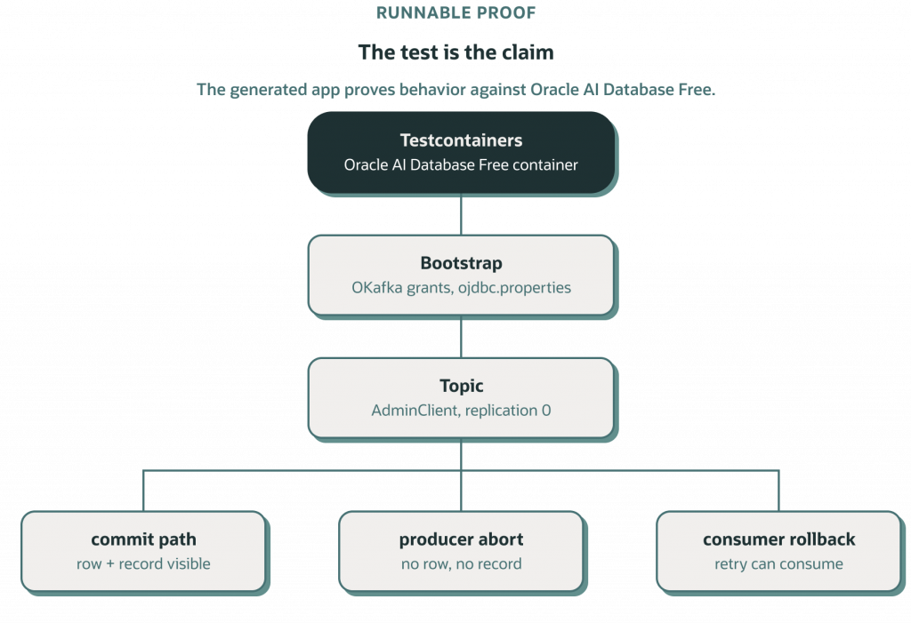

Testing is part of the skill
Diagram titled “The test is the claim.” A runnable OKafka demo uses Testcontainers to provision Oracle AI Database Free, bootstraps grants and configuration, and creates a Kafka topic. Three test outcomes are validated: successful commit with visible rows and records, producer abort with no persisted data, and consumer rollback where messages remain available for retry.
Runnable OKafka test topology validating commit, abort, and rollback behavior.
This skill includes guidance to validate with an integration test or smoke path that creates the topic, produces records, consumes records, and queries the TxEventQ backing table or related database side effect.
The generated app follows that direction. Its integration test starts gvenzl/oracle-free:23.26.2-slim-faststart, writes an ojdbc.properties file for local PLAINTEXT OKafka access, and then checks three paths:
  • a committed producer transaction creates the database row and can be consumed;
  • an aborted producer transaction leaves no produced row and no consumable record;
  • a failed consumer batch rolls back the database write and leaves the record available for a later successful consume.
You can run the generated app tests with mvn verify
The test includes grants and setup for the local container:
alter session set container=freepdb1;
grant aq_user_role to TESTUSER;
grant execute on dbms_aq to TESTUSER;
grant execute on dbms_aqadm to TESTUSER;
grant select on gv_$session to TESTUSER;
grant select on v_$session to TESTUSER;
grant select on gv_$instance to TESTUSER;
grant select on gv_$listener_network to TESTUSER;
grant select on SYS.DBA_RSRC_PLAN_DIRECTIVES to TESTUSER;
grant select on gv_$pdbs to TESTUSER;
grant select on user_queue_partition_assignment_table to TESTUSER;
exec dbms_aqadm.GRANT_PRIV_FOR_RM_PLAN('TESTUSER');
commit;
This is loaded and run on the local container at test startup:

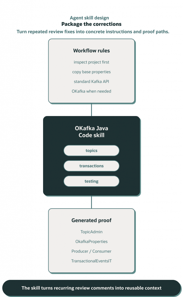

Final Thoughts
Diagram titled “Package the corrections.” Workflow rules and review guidance are packaged into an OKafka Java coding skill covering topics, transactions, and testing. The skill generates reusable artifacts such as topic administration, configuration properties, producer/consumer code, and integration tests. The goal is to turn recurring review comments into reusable implementation guidance.
Agent skill design for reusable OKafka coding patterns and validation workflows.
The real leverage here is developing and sharing agent skills that capture the Oracle AI Database patterns your team needs. Do you have common database workflows? Common development patterns? Encapsulate them in a skill, iterate on it, and share it.
Once details are packaged, agents can operate at a higher level. You spend less time correcting boilerplate and more time designing stronger examples, testing real behavior, and building more powerful Oracle AI Database applications from a better starting point.
