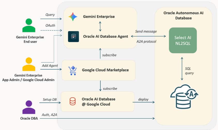

The diagram below shows the high-level flow from the initial client registration through a live end-user query.
The diagram shows the high-level flow from the initial client registration through a live end-user query.
The flow from the client registration through a live end-user query.
The end-to-end flow has four stages, each with a distinct owner:
  • Oracle AI Database setup (DBA): The Oracle database administrator provisions the Oracle AI Database@Google Cloud and enables A2A. Next, use the REST API to register an OAuth client for the database. This produces OAuth credentials (client_id and client_secret) that Gemini Enterprise uses to initiate OAuth flows. Note that the registration endpoint is protected by HTTP Basic authentication using database admin credentials so only database admins can register OAuth clients.
  • Oracle Select AI NL2SQL setup (Oracle DBA or database user): To setup the NL2SQL setup on the database, the DBA needs to download and install two scripts. Clone the official Oracle repository https://github.com/oracle-devrel/oracle-autonomous-database-samples . The Oracle AI Database Agent is available under the google-gemini-marketplace-agents directory. Running the oracle_ai_database_agent_tool.sql and the oracle_ai_database_agent.sql creates a Select AI Profile. Each profile defines the schemas and tables the agent is allowed to query, acting as the boundary for what the AI can see. Such a database user must have EXECUTE privilege on DBMS_CLOUD_AI_AGENT PL/SQL package.
  • Agent Card and A2A Client Configuration (Gemini Enterprise App Admin): Gemini Enterprise App Admin procures the Oracle AI Database Agent from Google Cloud Marketplace. The Oracle team allow-lists the Gemini Enterprise admin using their billing account. The OAuth client credentials generated by DBA are supplied here to wire up the authentication flow between the Gemini Enterprise app and the Oracle AI Database. Gemini Enterprise App Admin creates an app in Gemini Enterprise for business users which has access to the agent.
  • End-User Query Execution (End user): The end user selects Oracle AI Database Agent in Gemini Enterprise chat. They authorize via an OAuth prompt using their database credentials. From that point, they can ask questions in plain English. Gemini Enterprise routes each query to the Oracle AI Database agent, which executes it and returns the result to the chat.

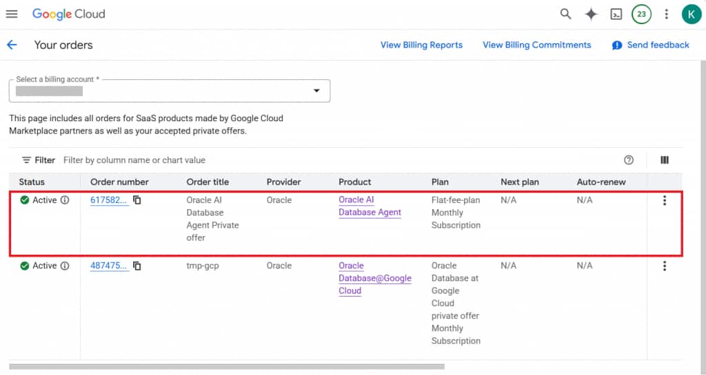

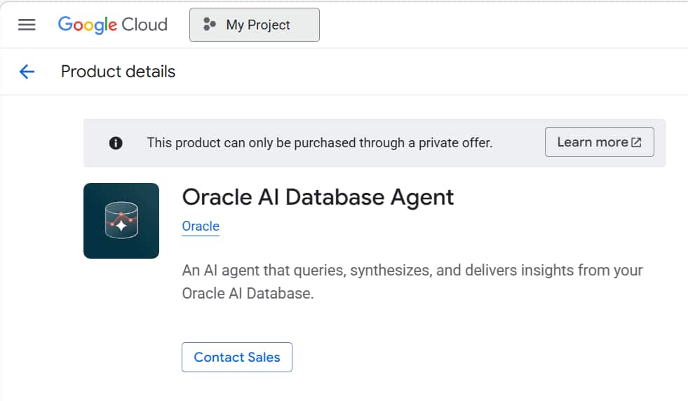

Step 1: Procure the Oracle AI Database Agent from Google Cloud Marketplace. The Oracle AI Database Agent must be procured from the Google Cloud Marketplace before it can be configured in Gemini Enterprise. Navigate to the Google Cloud Marketplace and search for Oracle AI Database Agent.
The image shows how to navigate to the Google Cloud Marketplace and search for Oracle AI Database Agent.
Navigating to the Oracle AI Database Agent on the Google Cloud Marketplace
Submit a request through the form to Oracle sharing your email and billing account details. Depending on your organization’s setup, this may require approval from your procurement team before the offer is unlocked. Once the offer is approved from Oracle, you will receive an email with the offer acceptance link.  Accept the private offer  from the email or from Google Cloud Marketplace -> Private offers and follow the on-screen installation steps. Once accepted, your entitlement will be active and usable in a few minutes.
Image shows how to accept the private offer from the Google Google Marketplace
Accepting the private offer from the Google Cloud Marketplace

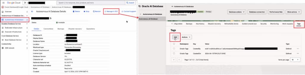

Step 2: Enable the A2A Server The A2A server is disabled on Oracle AI Database by default. Enabling it by adding a free-form tag to your Autonomous Database resource. From the Google Cloud Console, navigate to your Oracle Autonomous AI DB instance and choose Manage in OCI.
The image shows how to add a free-form tag with the appropriate values.
Adding the values
Under Tags, add a free-form tag with the following values:
# Enable the A2A server
Tag Name: adb$feature
Tag Value: {"name":"a2a_server","enable":true}
Only OCI users with at least the use IAM permission on the Autonomous Database resource can add or update free-form tags. If the tag silently fails to save, confirm your IAM policy before proceeding. Allow up to 5 minutes after saving for the change to propagate.

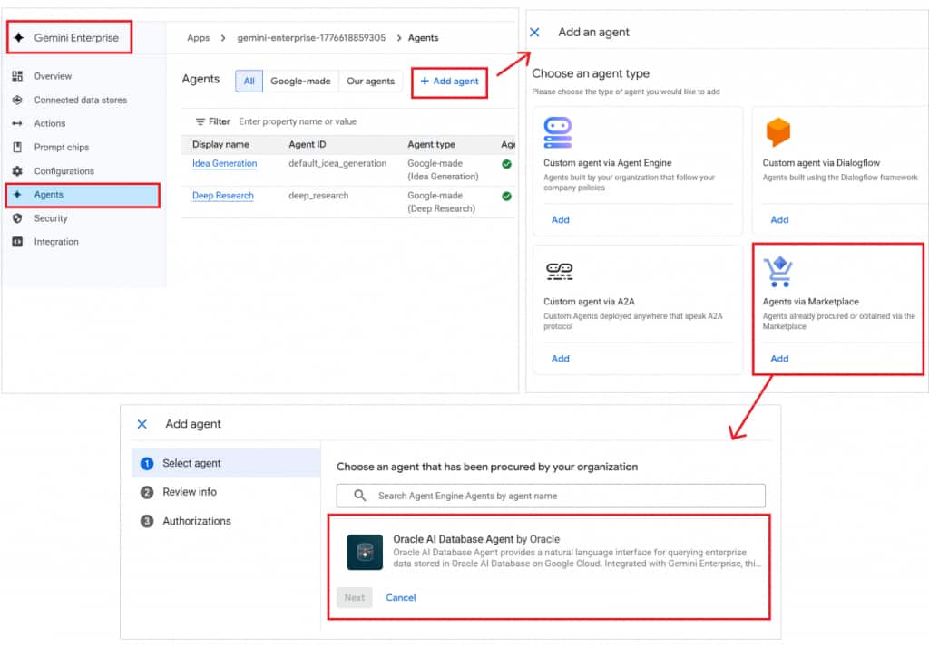

Step 5: Add the Oracle Agent to Gemini Enterprise The Gemini Enterprise App Admin configures the agent that was procured previously in the Google Cloud Marketplace and grants access to users. From the Google Cloud Console open the Gemini Enterprise interface. Navigate to Add agent and select Oracle AI Database Agent.
The image shows how to add the Oracle Agent to Gemini Enterprise. The Gemini Enterprise App Admin configures the agent that was procured previously in the Google Cloud Marketplace and grants access to users. From the Google Cloud Console open the Gemini Enterprise interface. Navigate to Add agent and select Oracle AI Database Agent.
Adding the Oracle Agent to Gemini Enterprise
You will be prompted to supply the OAuth credentials from earlier. In the Add agent dialog, enter the four values provided by the Oracle DB Admin:
  • Client ID: the client_id from the registration response
  • Client Secret: the client_secret from the registration response
After saving the agent configuration, navigate to its Permissions panel and add the users, groups, or organizational units that should have access to the Oracle AI Database Agent. Users will see the agent in their Gemini Enterprise interface after their next session refresh.

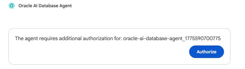

Step 6: Connect and Start Querying Open Gemini Enterprise Chat. In the agent panel or sidebar, find and select Oracle AI Database Agent. If you do not see it, confirm with your Gemini Enterprise App Admin that permissions have been granted for your account. The first time you use the agent, Gemini Enterprise will prompt you to authorize it to connect to the Oracle database on your behalf. Click Authorize in the prompt. Enter your Oracle database username and password, not your Google or OCI account credentials. After successful authentication, the agent confirms the connection. You are ready to query.
The image shows the initial querying of Open Gemini Enterprise Chat.
Starting querying Open Gemini Enterprise Chat.

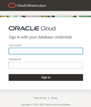

The image shows the authorizing window for the Gemini to connect to the Oracle database on your behalf. Users have to enter database username and password
Authorizing window
The OAuth flow authenticates you as an individual database user. The agent can only access the schemas and tables your database account has been granted permission to see, exactly as if you ran the query yourself in SQL Developer or another tool. There is no elevation of privileges.

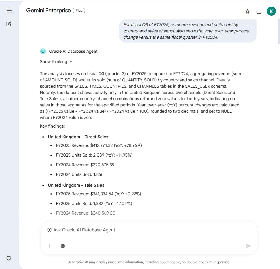

1. Type your question in plain natural language
In the Gemini Enterprise chat window, type a business question directed at your data. You do not need to know SQL or the exact table names. An example question could be:
“For fiscal Q3 of FY2025, compare revenue and units sold by country and sales channel. Also show the year-over-year percent change versus the same fiscal quarter in FY2024.“
The Oracle AI Database Agent interprets your question, generates the appropriate SQL query for your authorized schema, and executes it against the Oracle Autonomous AI Database. A brief processing indicator appears while this happens. The generated SQL is available to inspect if you want to verify what ran.
2. Review the results
Results are returned in the Gemini Enterprise chat in a structured data table showing the raw query output.

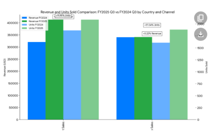

If the response includes a chart configuration, Gemini Enterprise can render the visualization inline alongside the returned table.
The image shows the example of the the visualization chart
Visualization chart
