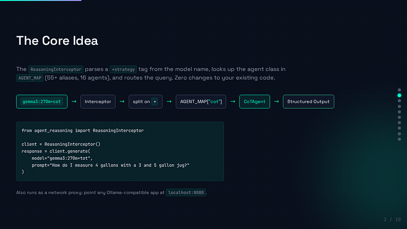

The Interception Layer

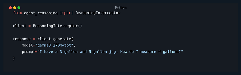

Key insight: The ReasoningInterceptor is an interchangeable drop-in client for Ollama that analyzes the model name for a +Strategy tag and directs traffic to one of 16 cognitive agent classes while making no modifications to your pre-existing code.
Everything relies on a single template: add +Strategy to any Ollama model name.
Using ReasoningInterceptor as a drop-in replacement client; strategy routing can be enabled via model name tags (e.g., +tot).
The image below illustrates the entire routing process from start to finish. The interceptor acts as a middleman between your code and Ollama, removes the +Strategy tag, and sends traffic to the correct agent class.
Diagram illustrating how the interceptor separates the base model from the Strategy tag and directs traffic to the corresponding agent class.
Illustrating how the interceptor separates the base model from the Strategy tag
agent_map contains over fifty-five aliases mapped to sixteen agent classes. For example, cot, chain_of_thought, and CoT all map to CotAgent, while mcts and monte_carlo map to MCTSAgent. Because the interceptor is a drop-in client for Ollama—supporting the same .generate() and .chat() APIs— existing LangChain pipelines, web UIs, and scripts can automatically gain reasoning capabilities by changing a single string in the model name.
Additionally, the interceptor can be used as a network proxy. Instead of pointing an Ollama compatible application at http://localhost:11434, direct it to http://localhost:8080 instead. Using a model name like gemma3:270m+CoT, the gateway will apply reasoning transparently.

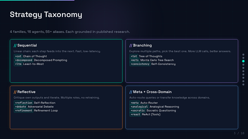

Each of the sixteen strategies fall into one of four families. The diagram below illustrates how they are grouped.
Categorization of the four Strategy families: sequential, branching, reflective, and meta. Each route leads to a specific type of reasoning agent. The fastest Sequential Strategies occupy the top-left quadrant while slower Branching strategies sacrifice speed for increased accuracy.
Categorization of the four strategy families
Sequential strategies are designed for high-speed processing with minimal latency. They are ideal for problems with discrete, sequential steps.

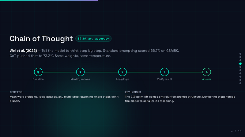

Chain of Thought (CoT)
Paper: Wei et al. (2022), “Chain-of-Thought Prompting Elicits Reasoning in Large Language Models”
Chain of Thought (CoT) is a prompting strategy in which the model generates intermediate reasoning steps before producing a final response. As noted in the original paper: prompting a model to produce these intermediate steps can significantly improve accuracy.
For example, standard prompting on GSM8K achieves 66.7% accuracy. With CoT prompting, this increases to 73.3%— a 10% relative improvement achieved through simple prompt design alone.
The following graphic illustrates how CoT chains appear in practice: a sequence of numbered steps, each building on the previous one.
Visual representation of CoT in operation: the model sequentially progresses through numbered steps (step 1…step n). Each subsequent step depends on previously generated steps. The numbering in the prompt is the only special instruction provided.
CoT in operation

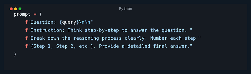

In terms of implementation within CotAgent, the query is wrapped in a structured prompt:
Structured prompting enforces step-by-step reasoning in CoTAgent
Benchmark result for qwen3.5:9b (9.7B): CoT achieves 88.7% average accuracy, across GSM8K (math), MMLU (logic), and ARC-Challenge (reasoning), compared to 81.3% for standard generation. This seven-point gain in performance is attributable solely to structural prompts. Identical weights and temperatures were applied to both models.
Recommended usage: Math word problems; logic puzzles; any multi-step reasoning task where the individual steps are sequential and do not have branches.

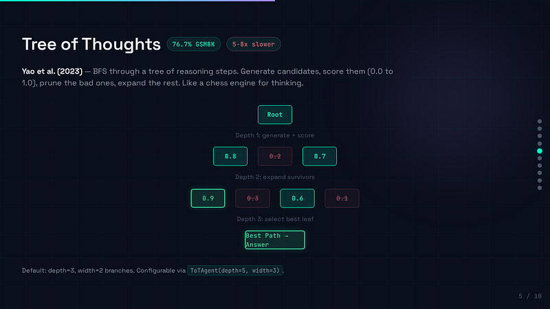

Tree of Thoughts (ToT)
Paper: Yao et al. (2023), “Tree of Thoughts: Deliberate Problem Solving with Large Language Models”
ToT is a search-based methodology that evaluates numerous possible reasoning paths concurrently, selecting the best performing path as determined by evaluation metrics such as distance traveled or quality of intermediate solutions etc.
Similar to chess engines, ToT applies BFS through an expanding tree of possible solutions. The core idea is straightforward: generate multiple partial solutions, evaluate them, prune weaker candidates, and continue exploring the most promising branches.
Below is an illustration of how ToT generates and eliminates branches: green nodes represent surviving branches, while red nodes indicate those that have been eliminated. The final answer is derived from the highest scoring leaf node.
A key design decision is how branches are evaluated. Should the same model handle both generation and scoring, or should a stronger model be introduced as a judge? In these benchmarks, the same model was used for both roles, but this is an area worth experimenting with, depending on your accuracy and latency constraints.
Illustration of how to generate candidate branches at each level; score candidate branches between 0 & 1; prune low-scored candidates; continue exploring surviving high-scored candidates until all levels are exhausted and then generate final answer from most promising leaf node.
Generating candidate branches at each level
ToTAgent implements this as configurable by depth (default=3) and width (default=2 branches). At every level, the agent generates a set of candidate next steps, evaluates them using a scoring function, prunes low-scoring options, and expands the remaining candidates into the next level.
Tot achieved 76.7% accuracy—a 10% percent improvement over standard generation on GSM8K math problems. This performance comes at a cost: additional LLM calls are required at each step to evaluate candidate paths and their intermediate result, making it roughly 5-8x slower than CoT equivalent queries.
Recommended usage: Logic puzzles with multiple solution paths; strategic decision problems; tasks where multiple approaches can be explored and compared.

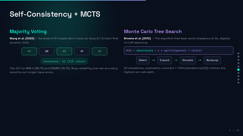

Self-Consistency (Majority Voting)
Paper: Wang et al. (2022), “Self-Consistency Improves Chain of Thought Reasoning in Language Models”.
Self-Consistency is a sampling method that generates multiple independent reasoning traces and selects a final answer through majority voting. Unlike standard prompting, it relies on sampling k diverse traces at a higher temperature to encourage variation. Each trace produces a candidate answer, and the most frequently occurring answer is selected as the final output.
The image below illustrates how both Self-Consistency and Monte Carlo Tree Search (MCTS) sample multiple reasoning paths, but differ fundamentally in how those paths are evaluated—majority voting versus UCB1-based exploration-exploitation balancing.
Left: Self-Consistency flowchart — sampling k independent traces & selecting most commonly occurring final answer via majority vote. Right: Monte Carlo Tree Search (MCTS) flowchart — sampling new paths through UCB1-based exploration/exploitation tradeoff balancing — both generate multiple possible answers — selection methodology differ significantly.
Self-Consistency vs MCTS comparison
ConsistencyAgent uses k=5 samples at temperature of 0.7 by default. It extracts final answers using regex-based pattern matching and selects the most frequent result via counter.most_common().
Self-Consistency matches CoT on both MMLU (96.7%) and GSM8K (76.7%). Its advantage lies in reliability rather than raw accuracy: majority voting across independent reasoning traces reduces the risk of single-trace errors propagating to the final answer.

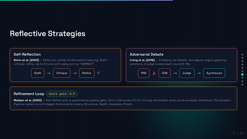

Family 3: Reflective Strategies
Self-Reflection
Paper: Shinn et al. (2023), “Reflexion: Language Agents with Verbal Reinforcement Learning” — arXiv:2303.11366
Self-Reflection is a draft-critique-refine loop in which the model generates an initial answer, critiques it for errors, and then revises it. The Reflexion paper showed that this iterative process can meaningfully improve output quality, even without any gradient updates.
The image below shows all 3 reflective strategies side by side: Self-Reflection, Debate, and Refinement Loop.
Left: Self-Reflection drafts, critiques, and refines until the critique says “CORRECT.” Right: Debate puts PRO and CON agents against each other with a Judge scoring each round. Bottom: Refinement Loop uses a numeric quality gate (0.0–1.0) to decide when to stop iterating.
Reflective strategies comparison
SelfReflectionAgent runs a draft-critique-refine loop for up to 5 iterations, with early termination when the critique returns “CORRECT” in under 20 characters. If the critique is satisfied on an early pass, subsequent iterations are skipped. This approach helps keeps latency low for queries the model answers correctly on the initial pass.
Recommended usage: Creative writing, high-stakes technical explanations, anything where “good enough on the first try” is insufficient.
Adversarial Debate
Paper: Irving et al. (2018), “AI Safety via Debate”
Irving proposed debate as a mechanism for improving AI safety. Two agents present opposing arguments, and a judge (either a human or another LLM) evaluates their merits. The underlying premise is that that identifying flaw in weak arguments is often easier than constructing strong ones.
DebateAgent conducts multiple rounds of PRO and CON arguments, with a judge evaluating each exchange. Following all rounds, the strongest arguments from both sides are synthesized into a final answer that balances competing perspectives. Context is carried forward between rounds, enabling incremental refinement rather than redundant arguements.
Recommended usage: Controversial or ambiguous subjects; policy analysis; ethics and any subject matter requiring a balanced perspective.
Refinement Loop
Paper: Madaan et al. (2023), “Self-Refine: Iterative Refinement with Self-Feedback”
This paper describes a refinement loop similar to self-reflection, but instead of relying on a human-style critique to guide revisions, it uses a machine-based evaluation system with quantifiable quality metrics. These metrics determine whether further refinement is necessary. The loop terminates when a predefined quality metric is reached (> 0.9 by default) or when the maximum number of iterations is exceeded.
The five-stage complex refinement pipeline consists of sequential stages, each focused on a distinct type of critique: technical accuracy, structure, depth, examples, and polish.
Each stage targets a distinct aspect of quality, ensuring the model focuses exclusively on improving that dimension rather than attempting to optimize everything at once.
Recommended usage: Highly technical writing; documentation; blog posts, a scenario where production-quality output is required rather than simply a first draft.

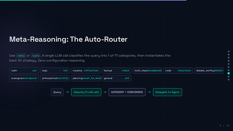

Auto Router: MetaReasoningAgent
Key insight: A single LLM invocation allows MetaReasoningAgent to classify each input into one of eleven categories and route it to the most appropriate strategy, without human intervention.
All sixteen strategies depend on selecting the appropriate strategy for a given task. By removing this requirement, MetaReasoningAgent eliminates the need for manual selection.
The diagram below shows how each category maps to its corresponding strategy.
Classification occurs using a single LLM invocation returning CATEGORY, CONFIDENCE, and REASON.
MetaReasoningAgent classification diagram
MetaReasoningAgent instantiates the selected strategy class and passes control to it, along with all event objects for visualization.
To use this capability, specify a model such as gemma3:270m+meta or gemma3:270m+auto.
In practice, routing is generally intuitive: math problems are directed to CoT, logic puzzles to ToT, philosophical questions to Socratic Questioning, and controversial topics to Adversarial Debate.
The trade-off is reduced control over strategy-specific hyperparameters in exchange for automatic routing aligned with the problem type.

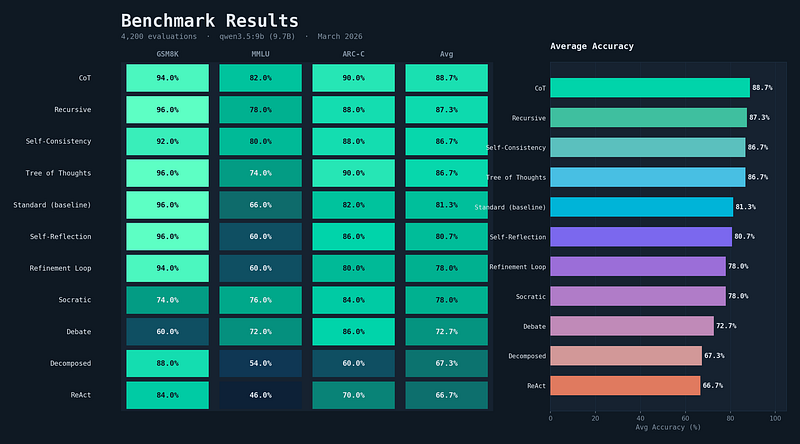

What Strategy Should You Pick? Benchmark Results (March 2026)
Key insight: CoT performs best on average (88.7%) across diverse tasks. ReAct excels when tool use is available (70.0% on ARC-Challenge). ToT and Self-Consistency tie on GSM8K math at 76.7%.
These results are based on 4,200 evaluations across 11 strategies using qwen3.5:9b, collected as of March 2026. All 16 strategies are implemented and production-ready. However, the benchmarks shown below focus on the 11 that produce a single extractable answer. The remaining five are generation-focused and not suited to multiple-choice evaluation.
The heat map and bar chart below provide a complete view of the results.
Left: accuracy heatmap across GSM8K, MMLU, and ARC-Challenge for each strategy. Right: average accuracy bar chart. CoT wins overall at 88.7%.
Benchmark results heatmap and bar chart
The short version: CoT wins on average across diverse tasks. Self-Consistency and ToT beat it on specific math benchmarks. ReAct dominates on factual/science tasks. Self-Reflection and Refinement Loop are not well captured by these benchmarks, as they primarily improve generation quality rather than multiple-choice accuracy.
For most queries, start with +cot. If you’re solving logic puzzles or planning problems, try +tot. If you need factually grounded responses, use +react. If you need polished, high-quality output rather than a quick answer, use +refinement. When in doubt, +meta will route they query automatically.

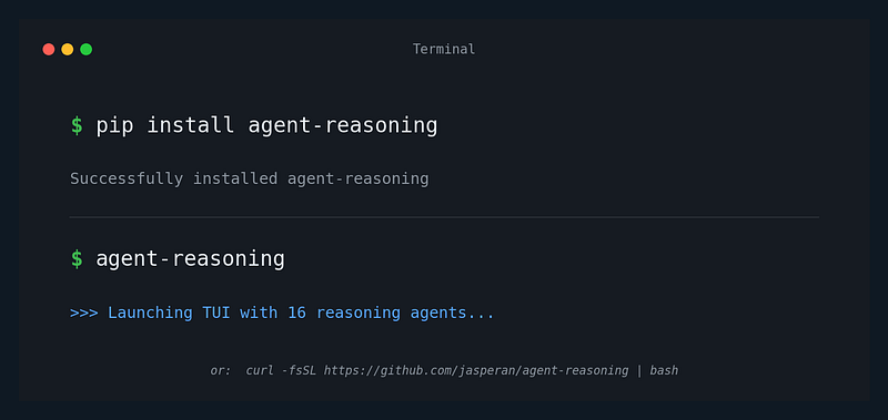

You can find the repository here. Install with pip install agent-reasoning or uv add agent-reasoning. The commands to get started:
Getting started commandsInstallation and launching agent-reasoning in seconds to access a TUI with 16 reasoning agents.

Do I need to modify my existing code to use agent-reasoning?
No. The interceptor is a drop-in replacement for the Ollama client. Just change the model name string by appending +strategy (e.g., gemma3:270m+cot) and the interceptor handles everything else. Existing LangChain pipelines, web UIs, and scripts work without any other changes.
Which strategy should I start with?
Start with +cot (Chain of Thought). It scored the highest average accuracy (88.7%) across our benchmarks and adds minimal latency. If you are unsure, use +meta and let the auto-router pick the best strategy for you.
Why were only 11 of the 16 strategies benchmarked?
The benchmarks (GSM8K, MMLU, ARC-Challenge) measure multiple-choice accuracy, which works well for strategies that produce a single extractable answer. The remaining five strategies are generation-focused (e.g., Refinement Loop, MCTS) and their strengths in output quality are not captured by multiple-choice evaluations. All 16 strategies are fully implemented and production-ready.
Can I use this with models other than Ollama-served models?
Currently the interceptor targets the Ollama API. Since it exposes the same .generate() and .chat() endpoints, any Ollama-compatible client works out of the box. Support for additional inference backends is on the roadmap.
How much slower are branching strategies compared to CoT?
ToT is roughly 5-8x slower than CoT because it generates and evaluates multiple candidate branches at each level. Self-Consistency (k=5 samples) adds similar overhead. For latency-sensitive applications, stick with sequential strategies (CoT, Least-to-Most) and reserve branching strategies for problems where accuracy matters more than speed.
