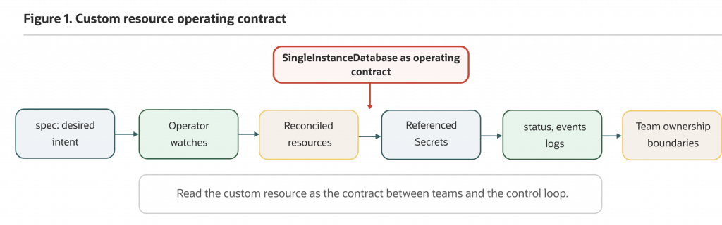

The custom resource is the operator contract
A Kubernetes operator is useful only when teams understand the API contract it exposes. For Oracle Database Operator for Kubernetes, that contract is the custom resource: a Kubernetes object that records database intent and gives the operator something to watch, reconcile, and report on.
A CustomResourceDefinition, or CRD, registers a new resource type with the Kubernetes API. A custom resource is an instance of that type, such as a SingleInstanceDatabase. The spec is desired state: what the team wants the resource to be. The status is observed state: what the operator reports after trying to reconcile the resource. Reconciliation is the repeated controller process of comparing desired state with actual state and taking action to move them closer.
Kubernetes stores the object. Oracle Database Operator for Kubernetes watches it. The operator reconciles supported Kubernetes resources such as pods, PVCs, and services; reads referenced objects such as Secrets; records events; and reports status. When something does not line up, the custom resource is the best starting point because it connects database intent to the cluster behavior that follows.
The important shift is mental, not syntactic. A SingleInstanceDatabase manifest is not “just YAML.” It is a shared operating contract between platform engineers, DBAs, and the operator.
Diagram titled “Custom resource operating contract.” A SingleInstanceDatabase custom resource serves as the operating contract between teams and the Oracle Database Operator. The workflow progresses from desired intent in the resource specification, to operator monitoring, resource reconciliation, referenced secrets, and status/events/logs, ending with defined team ownership boundaries. A note states that the custom resource is the contract between teams and the control loop.
SingleInstanceDatabase custom resource as the operating contract for Oracle Database Operator reconciliation and lifecycle management
Figure 1: Use the SingleInstanceDatabase spec to declare database intent. Oracle Database Operator for Kubernetes reconciles related Kubernetes resources and reports progress through status, events, and logs.
This model follows core Kubernetes patterns for custom resources, controllers, and Kubernetes object spec and status. The operator makes those patterns concrete for Oracle Database lifecycle intent.

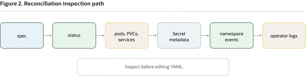

Trace the custom resource to pods, PVCs, services, events, and logs
The custom resource is the entry point, not the whole story. A useful reconciliation review follows the trail from SingleInstanceDatabase to related Kubernetes resources and controller signals.
Diagram titled “Reconciliation inspection path” showing the recommended troubleshooting sequence for Oracle Database Operator reconciliation. The workflow moves from reviewing the resource specification (spec) and status, to inspecting pods, PVCs, and services, then checking secret metadata, namespace events, and operator logs. A note advises inspecting resources before editing YAML.
Oracle Database Operator reconciliation inspection workflow
Figure 2: When status does not match expectations, move from the custom resource to related resources, events, and operator logs before changing the manifest.
Start with describe because it puts several views in one place:
kubectl describe singleinstancedatabase freedb-lite-sample
  -n oracle-db-operator-demo
Use this to read the Spec, Status, Conditions, and related events together. This command is often more useful than jumping straight to pod logs because it keeps the database custom resource at the center of the investigation.
Next, inspect related namespace resources:
kubectl get pod,pvc,svc,secret -n oracle-db-operator-demo
Pods show scheduling, startup, readiness, and image pull behavior. PVCs show whether storage provisioning has succeeded. Services show how the database may be exposed inside the namespace or cluster. Secret metadata confirms that referenced Secret objects exist without revealing their values.
Avoid relying on exact generated pod, PVC, or service names unless you have verified them in your own environment. Operators can change naming patterns across releases, configurations, or reconcile paths.
Events are often the fastest way to see what the cluster is waiting on:
kubectl get events -n oracle-db-operator-demo --sort-by=.metadata.creationTimestamp
The Kubernetes events API records time-bound messages about resource activity. For this evaluation, namespace events may show scheduling decisions, PVC provisioning, image pull failures, admission problems, readiness transitions, or reconciliation-related messages.
When status and namespace events do not explain enough, inspect the operator logs if your permissions allow it. In the series setup, the operator runs in oracle-database-operator-system as the deployment oracle-database-operator-controller-manager. If your platform installed the operator with different manifests, an OperatorHub workflow, or a namespace-scoped deployment, adjust the namespace and deployment name before running the log command:
kubectl logs -n oracle-database-operator-system
  deployment/oracle-database-operator-controller-manager
  --all-containers=true
Some readers may not have permission to read operator logs; in that case, the platform team should make controller-side diagnostics available through the approved logging system.
This inspection path keeps troubleshooting disciplined. Start with what was declared. Read what the operator reported. Inspect the resources the cluster created or failed to create. Then use events and logs to classify the issue.

Sometimes status is not enough by itself. If .status.status does not change or kubectl get singleinstancedatabase shows incomplete columns, compare multiple signals instead of diagnosing from one stale field.
kubectl get singleinstancedatabase freedb-lite-sample
  -o jsonpath='generation={.metadata.generation}{"n"}'
  -o jsonpath='{range .status.conditions[*]}{.type}{"t"}{.status}{"t"}{.observedGeneration}{"t"}{.reason}{"t"}{.message}{"n"}{end}'
If your permissions and installation layout allow it, inspect the controller-manager logs:
Compare generation, status, conditions, events, related resources, and operator logs. If the installed CRD differs from your runbook, update the runbook to match the installed release instead of forcing the cluster to match stale assumptions.

Decide what platform teams, DBAs, and developers each own
The custom resource model improves visibility only when teams agree on ownership. The operator can reconcile supported Kubernetes resources, but it does not remove platform ownership, DBA review, or application dependency management.
Platform engineers own the Kubernetes operating surface around the resource. That includes operator installation and upgrades, cert-manager and webhook readiness where applicable, namespace boundaries, RBAC, admission policy, storage classes, CSI drivers, reclaim policy, quota, capacity, registry access, image mirroring, image pinning, pull Secrets, logging, monitoring hooks, event access, alerting integration, and GitOps or policy controls for changing spec.
DBAs own the database interpretation of the resource. That includes database configuration review, edition and image review from a database perspective, recovery expectations, database-level validation after the operator reports readiness, operational procedures, backup and restore expectations, patching and maintenance practices, and decisions around Oracle Database features when used.
Developers need a clean contract from both groups. They need approved connection details, clear service behavior, environment boundaries, readiness signals they can safely depend on, and escalation paths when storage, image, Secret, or database initialization issues appear. They also need to know whether they are allowed to edit the custom resource directly or whether changes must flow through a platform workflow.
In most shared environments, direct developer edits to spec should be controlled. A spec change can alter image source, persistence settings, service behavior, or database lifecycle intent. That is a stronger action than changing an application ConfigMap. Use GitOps, admission controls, RBAC, and review workflows that match the risk of the environment.
A useful ownership review starts with the fields you inspected earlier. spec.image.pullFrom belongs in the image governance conversation. spec.persistence.storageClass belongs in the storage platform conversation. spec.adminPassword.secretName and spec.adminPassword.secretKey belong in the secret-management conversation. .status.status and connect strings belong in the readiness and application-dependency conversation. Events and logs belong in the observability and support conversation.
That is why reading the custom resource carefully matters. It turns abstract ownership questions into specific fields, resources, and signals.
