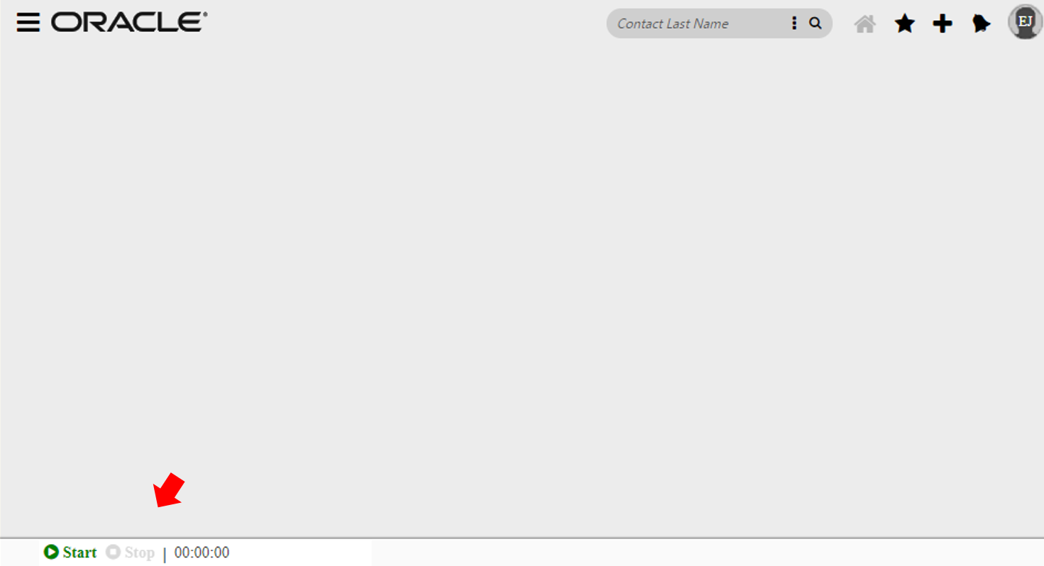

Let’s take a more in-depth look at what the sample code delivers. The sample code is implementing an Extension StatusBar with a start and stop button, plus a timer that provides the duration of how long your agent is capturing the steps to reproduce.

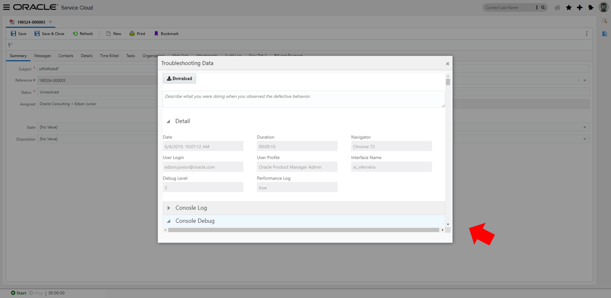

By clicking on the start button, the troubleshoot extension will automatically set the log level (see developer tools logs for more information). Everything that is registered in the web console will be captured.

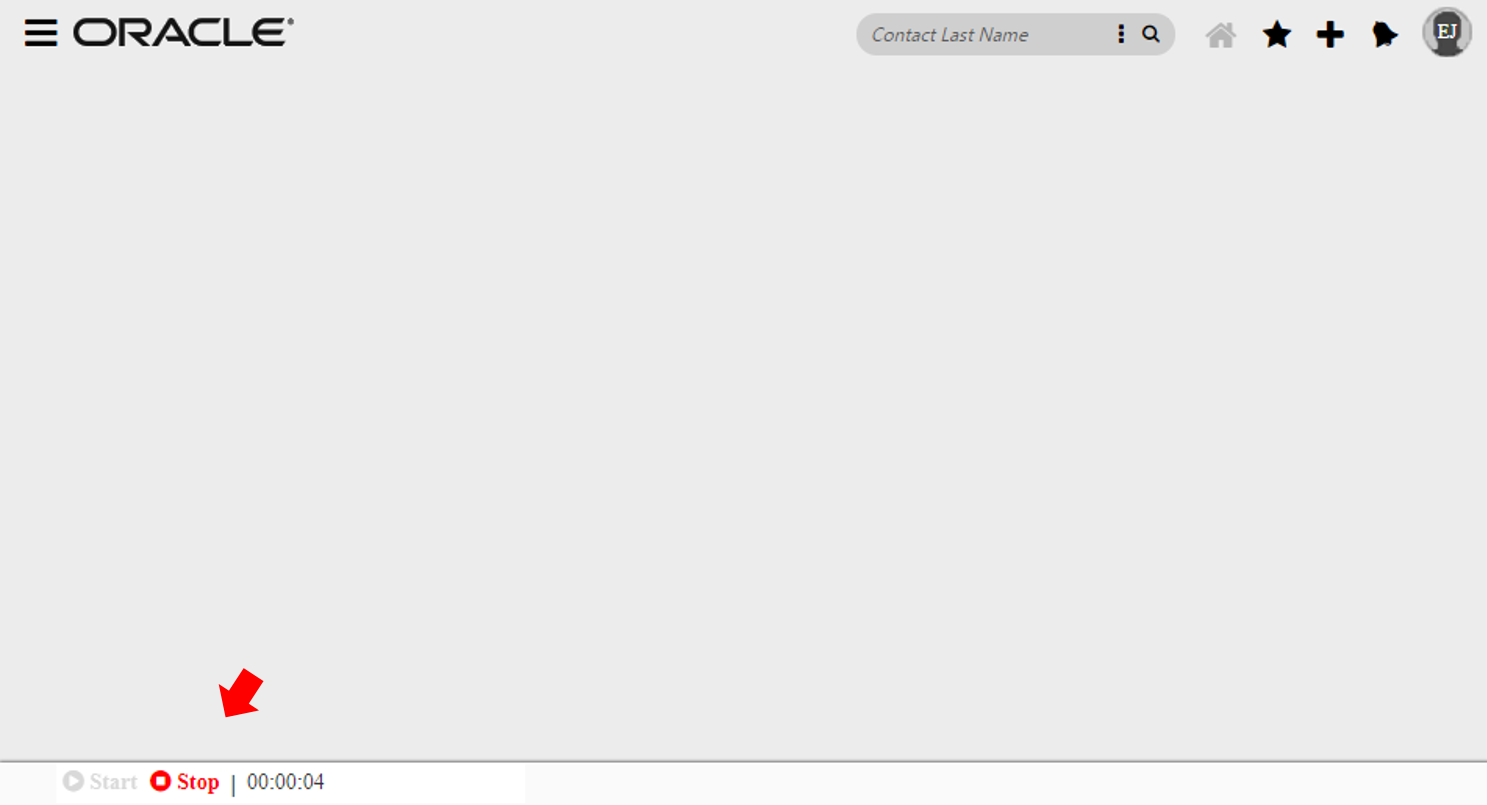

Once you have finished capturing your steps to reproduce click on the stop button and the Troubleshoot Extension takes care of compile all web console information to present to you in a window modal.
**This extension is not compatible with IE11.
The window modal presents a friendly version of the result captured, but you can save the result by clicking on the download button on top. The download button will create a text file with the information that was captured in and can share with your technical team to help them on the investigation.
The information capture is read-only, but there is an additional field on top where your agent can add more information such as steps to reproduce or any other comment.
