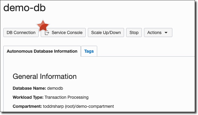

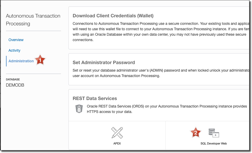

We can test these out before we start writing our application code. Start by logging in to our Oracle Cloud console and viewing the details of our ATP instance. From the details page, click on ‘Service Console’:
Within the service console, click on ‘Administration’ (#1) and then SQL Developer Web (#2).

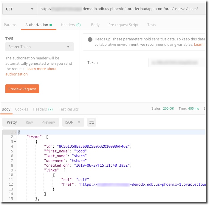

This auth token expires in one hour and can now be used to make calls against the REST endpoints. Let’s test those out before we move on to the application code. It’s easiest to use a tool like Postman so that we can visualize the results. Set the auth token as a “Bearer” token in Postman and try each endpoint.
To get all users (GET request to /ords/usersvc/users/) returned as an array within the ‘items’ key. Note, by default you’ll only get 25 records. See the next example for how to control pagination.

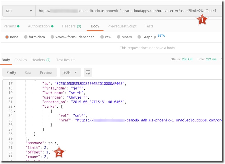

To use pagination (GET request to /ords/usersvc/users?limit=2&offset=1) returns an object containing items and pagination related information:

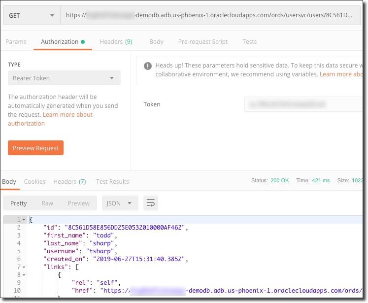

To get a single user (GET request to /ords/usersvc/users/{userid}) returned as a JSON representation of the user:

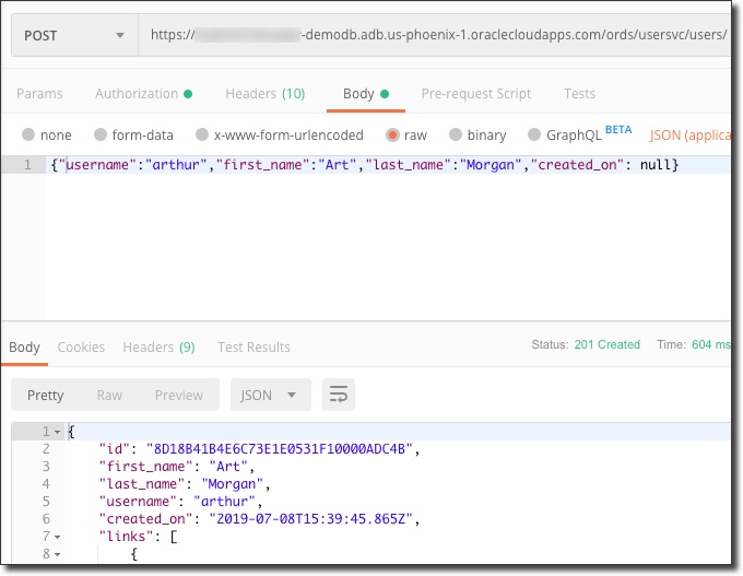

To create a new user (POST a JSON representation of the user in a request to /ords/usersvc/users/) returns with 201 Created as a JSON representation of the user:

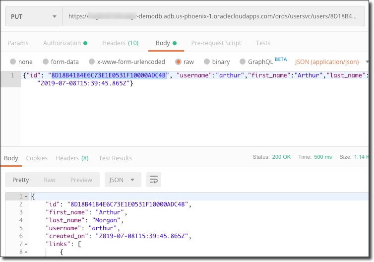

To update a user (PUT request a JSON representation of the user to /ords/usersvc/users/{userid}) returns 200 OK:

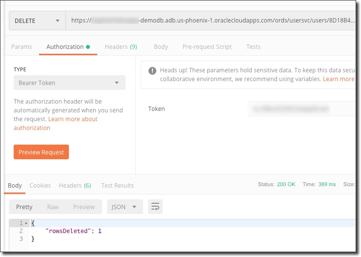

To delete a user (DELETE request to /ords/usersvc/users/{userid}) returns 200 OK and the count of rowsDeleted:
