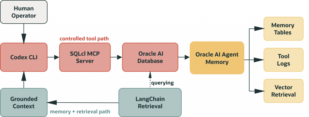

Architecture diagram showing a human operator using Codex CLI through a controlled SQLcl MCP tool path to Oracle AI Database and Oracle AI Agent Memory. Agent Memory connects to memory tables, tool logs, and vector retrieval. A separate LangChain retrieval path queries the database and returns grounded context to Codex CLI, forming the memory and retrieval loop.
Controlled Codex MCP + Oracle AI Database Workflow

The workflow has five layers. Codex CLI is the developer-facing agent interface. SQLcl MCP is the tool boundary. Oracle AI Database is the durable substrate for memory, traces, and retrieval. The notebook is the build-and-validation harness that proves the pieces are wired correctly before the workflow is handed to Codex.
That separation matters. Codex does not need raw credentials in its prompt. SQLcl MCP can be configured once using the saved alias. Oracle AI Database owns persistence and retrieval. The notebook shows the setup in a way that can be rerun, inspected, and debugged.
A simple way to divide the responsibilities:
LayerResponsibility
Codex CLIDeveloper-facing agent interface.
SQLcl MCPExposes declared Oracle tools to Codex; it is the tool boundary.
Oracle AI DatabaseStores durable data, retrieval evidence, vectors, metadata, traces, and enforces database privileges.
Oracle AI Agent MemoryProvides application APIs for users, agents, threads, durable memories, scoped retrieval, and context assembly.
LangChainWraps Oracle-backed retrieval results as Document objects and supports application-side orchestration.

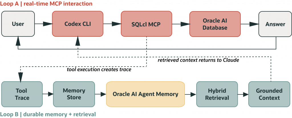

Building on the separation of responsibilities above, the system naturally forms two execution loops:
  • Loop A is the operational interaction loop: Codex CLI works with MCP to discover tools, inspect data, run bounded read-only queries, and return results immediately.
  • Loop B is the durable memory and retrieval loop: application code writes history, tool logs, memory records, chunks, and embeddings to Oracle AI Database, then retrieves context before a later answer or workflow step.
Diagram showing two linked loops. Loop A handles real-time interaction from user through Codex CLI, SQLcl MCP, Oracle AI Database, and answer. Loop B records tool traces into a memory store and Oracle AI Agent Memory, then uses hybrid retrieval to produce grounded context. Retrieved context returns to the agent for later interactions.
Dual Execution Loop: MCP Interaction and Durable Memory 
SQLcl MCP is for Codex operating interactively through declared tools. Oracle AI Agent Memory is for application code that stores turns, retrieves history, and assembles context before Codex or another assistant sees a prompt. You can drop either one for a narrower use case, but most production setups need both loops.
