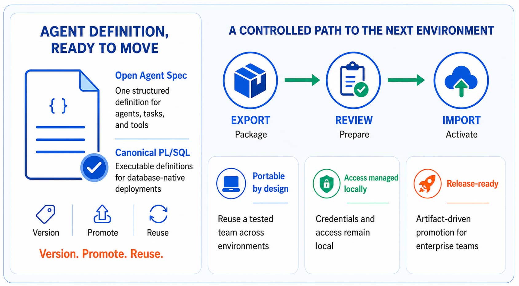

A repeatable release process can help move an agent team through development, test, and production without manually rebuilding its portable definition. When you migrate a team from one schema to another, you need a release process that carries the reusable definition forward while keeping target-environment security controls in place.
Oracle Select AI Agent Framework provides two complementary export approaches. You can package a team using Open Agent Specification (Agent Spec), a JSON representation designed for agent interchange or retrieve canonical PL/SQL with GET_DEFINITION. Both approaches support repeatable migrations; the right choice depends on how you store, review, and deploy database artifacts.
Figure 1. Agent team migration moves portable definitions through a release bundle while target controls remain local.

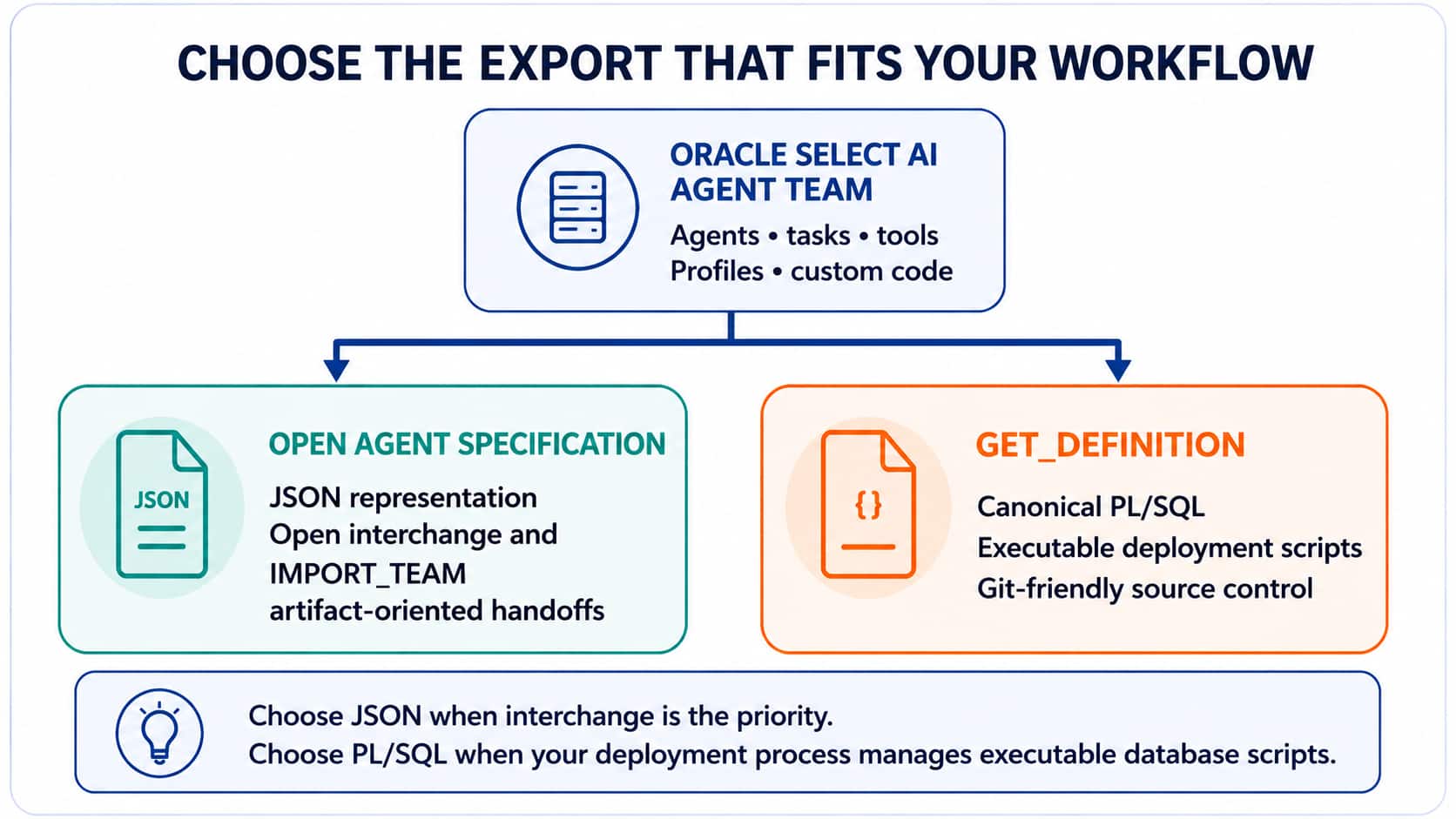

Two export approaches for the same migration goal
Start with the outcome you need. Oracle Select AI Agent Framework can export an agent team using the Open Agent Specification representation, while GET_DEFINITION APIs return canonical executable PL/SQL for supported objects. Both capture user-facing configuration; neither exports credential secret values, passwords, tokens, private keys, or network privileges.
  • Choose Agent Spec when you need a JSON artifact for interchange, cataloging, or DBMS_CLOUD_AI_AGENT.IMPORT_TEAM.
  • Choose GET_DEFINITION when your release process is built around executable database scripts. The generated PL/SQL can enter the same GitHub repository, pull-request review, comparison, and deployment process as your other schema changes.
  • Use both when it helps: keep a JSON interchange artifact and retain canonical PL/SQL as the deployable record for a controlled database release.
Figure 2. Choose JSON for open interchange or PL/SQL for executable, source-controlled database deployments.

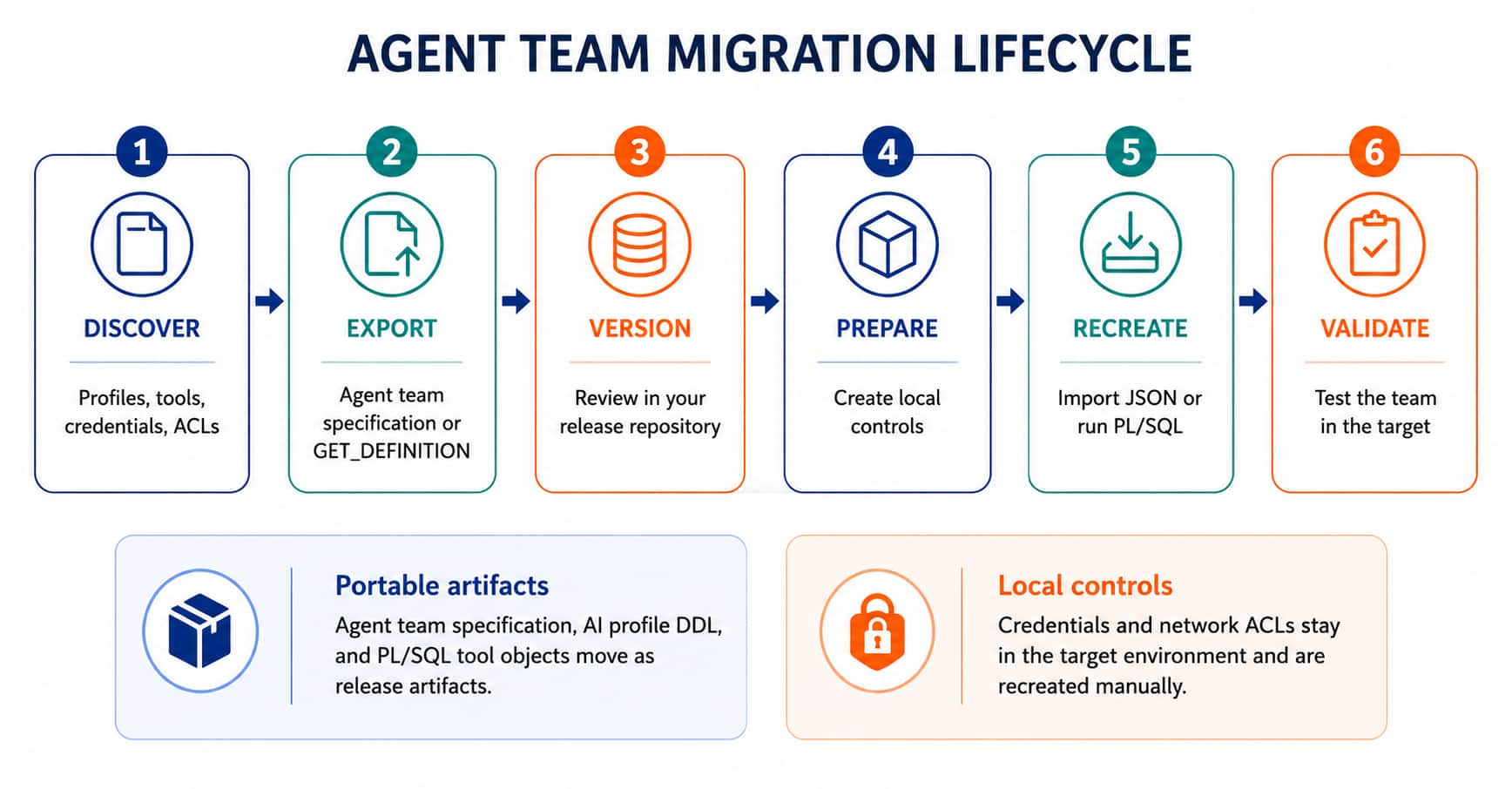

After recreation, run focused validation: confirm that the team, agents, tasks, tools, and profile references exist; test the tool functions; and exercise the team with a representative request. Keep the release artifact and validation evidence together so you can reproduce the migration later.
Figure 3. A general migration lifecycle works with either JSON or PL/SQL export artifacts.
