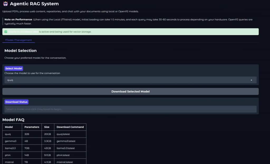

In 2025, I built a project called Agentic RAG (Github: agentic_rag), an Oracle Autonomous-based RAG system that enables communication with open-source LLMs, while enabling RAG capabilities (ask questions about documents, websites or codebases) on top of that. Here are some pictures from the gradio front-end:
UI for the agentic_rag project — this data ingestion interface allows document uploads, text extraction from websites and codebase processing (getting code ready for LLMs)

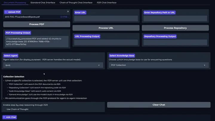

And then, you can then use this interface to orchestrate responses from agents
You can use any open-source ollama-based models and chat with them (+RAG) through this UI.

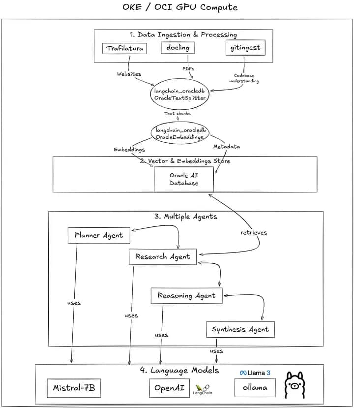

So, last year, the architecture was following this structure:
Architecture for the agentic_rag project (without A2A)
But this would host all LLMs, front-end, API and back-end of my application in the same GPU / Oracle Kubernetes Engine (OKE) cluster, which was a problem.
The preliminary solution that I thought of? Horizontal scaling with multiple instances / clusters. I would then attach a load balancer before all requests and let OCI do the networking for me.
But this approach had an obvious flaw: you’re not scaling individual agents, you’re scaling the entire pipeline. If the system was bottle-necked by my planner and researcher agents, it was not an elegant solution. Then, I found the Agent2Agent Protocol.

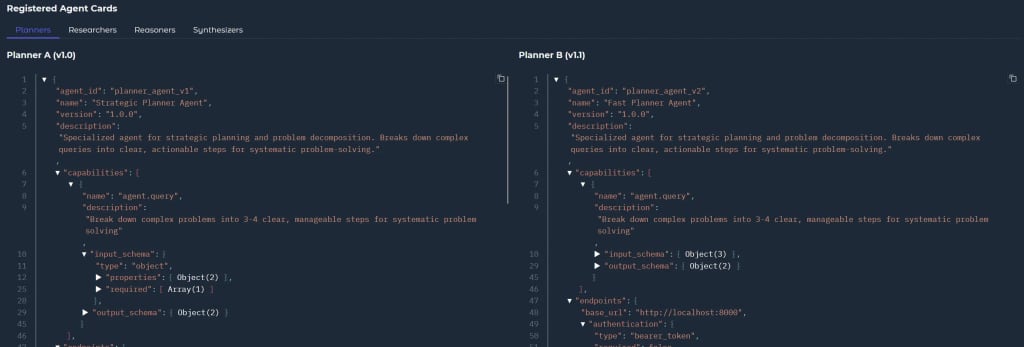

1. Agent Cards — Every A2A-compliant agent publishes a machine-readable JSON document describing exactly what it does, what inputs it expects, what outputs it provides, and how to reach it. A planner agent announces itself as a “task-analyzer.” A researcher announces itself as a “knowledge-retriever.” A synthesizer announces itself as a “response-generator.” These are capability declarations that enable dynamic discovery.
Agent card definition in JSON-RPC format
Python code that defines the capabilities of an agent through agent cards.

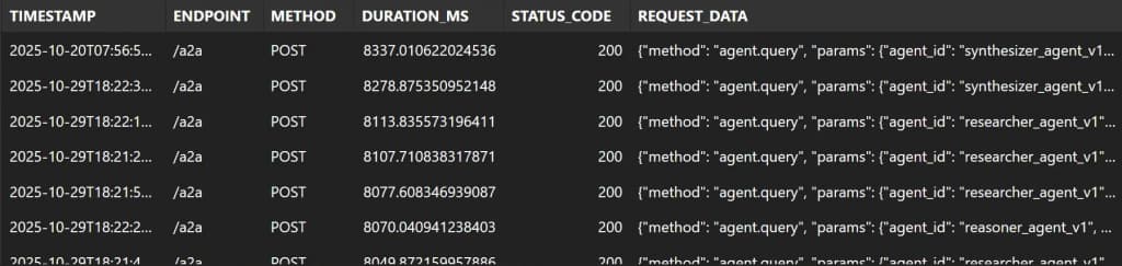

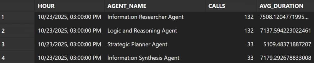

Logging metrics from my Oracle Autonomous 26ai Database, showing some of my agents were getting more calls than the others.
A2A endpoint logging system enabled by Oracle Autonomous 26ai

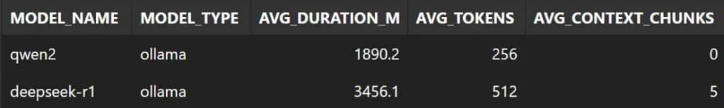

The data lake system also allowed me to track and compare inference speeds between my models
