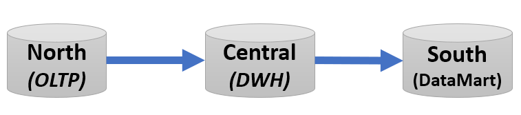

In a cascaded replication setup, changes are synchronized in a unidirectional flow across three databases. Changes made in the OLTP database (North) are captured and applied to the Datawarehouse database (Central). Then, any changes—whether originating from the OLTP database or from the Datawarehouse database itself—are re-captured and routed to a target Datamart (South). In practice, there are often multiple smaller Datamart’s behind the central Datawarehouse. There can even be multiple OLTP sources that are feeding the central Datawarehous.
Typically, replication is configured in two stages: first, from North (using Extract and DistPath) to Central (using Replicat), and then from Central (using Extract and DistPath) to South (using Replicat).

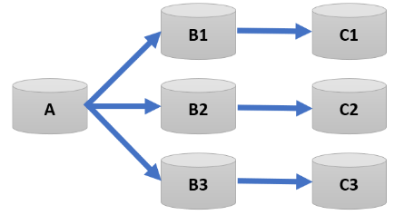

Use cases for cascaded Replication.

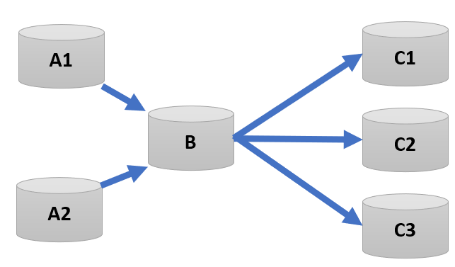

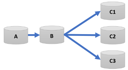

In the previous example, we saw a simple setup with one source and one target. But in the real world, replication environments often involve multiple sources and targets. Picture this: a central Data Warehouse, which is fed by several OLTP databases from different sources. Now, add in the complexity of business analysis being offloaded to multiple Data Marts. This scenario is far more common than you might think.
In this case, the topology becomes more intricate. You’ve got a N:1 setup, where data flows from multiple source databases into the central Data Warehouse. On the flip side, there’s a 1:M configuration, where the central database then pushes data to multiple target databases.
Here’s where Oracle GoldenGate shines. It excels in managing complex, extended “chained” replication topologies like this, offering unmatched flexibility. Whether you’re orchestrating a sophisticated multi-source to multi-target environment or scaling your replication setup, GoldenGate allows for seamless integration and robust data flow. It’s all about making extended replication easier to configure and manage, regardless of the number of moving parts.

1:1:Many
Many:1:Many
1:1:Many
