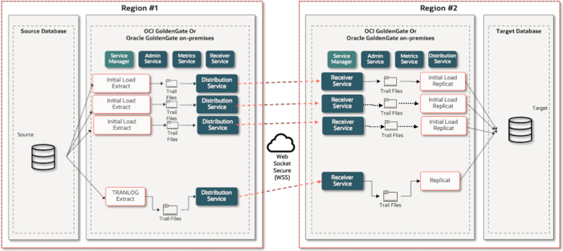

In this article we shall demonstrate using multiple Oracle GoldenGate Initial Load  processes to instantiate an Oracle Database from a MySQL Database to create a heterogeneous (MySQL to Oracle Database) replication implementation without taking an application outage.
Architecture Diagram
Image 1. Architecture Diagram

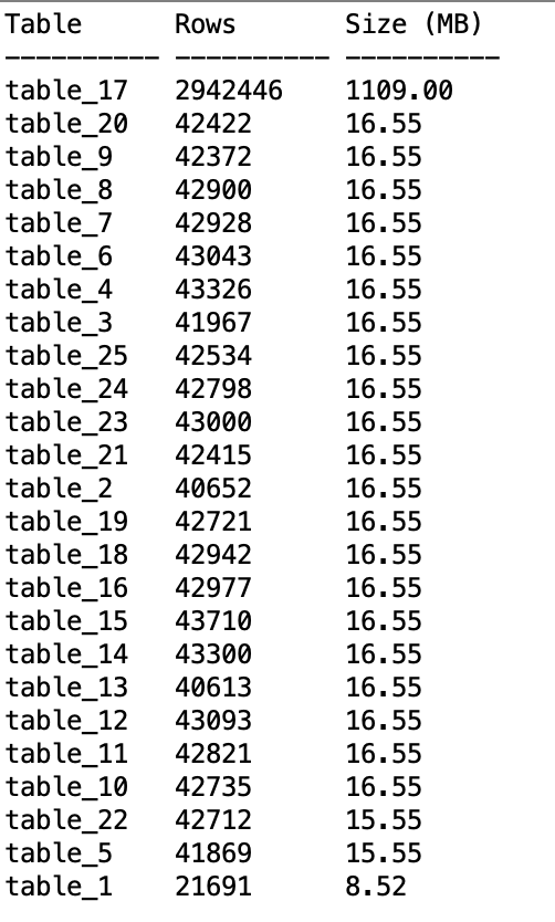

Source Table Row Count and Size
After updating table statistics, we used this SQL query to retrieve source table sizes:
SELECT
    LEFT(TABLE_NAME,10) AS `Table`,
    LEFT(TABLE_ROWS,10) AS `Rows`,
    LEFT(ROUND(((DATA_LENGTH + INDEX_LENGTH) / 1024 / 1024), 2),10) AS `Size (MB)`
FROM
    information_schema.tables
WHERE
    TABLE_SCHEMA = ‘[database name]’
ORDER BY
    (DATA_LENGTH + INDEX_LENGTH) DESC;
Source Table Size
Image 2. Source table size
In the above output, except for table_17, our source tables are very small in size and should be efficiently handled via a single Oracle GoldenGate Initial Load Extract.
We can create parallelism in the data fetch for table_17 by splitting it across multiple Initial Load Extract processes using the Oracle GoldenGate @RANGE function. For details on this function, refer to the Oracle GoldenGate documentation. For this demonstration we will use two Initial Load Extracts; however, further parallelization maybe used to split the workload across three, four, or any number of Initial Load Extracts.
When using @RANGE, data hashing and filtering occurs in the Initial Load Extract not the database. Each Initial Load Extract configured to fetch the table’s data must perform an initial read of the entire table to determine the correct data range of values it will fetch. Depending upon the size of the table, this initial read could take a significant amount of time.

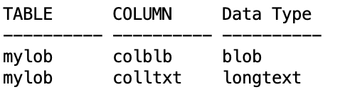

Query Source for Large Objects
Here is the query we used to find MySQL tables with Large Object data types:
select
    LEFT(tab.table_name,10) as `TABLE`,
    LEFT(col.column_name,10) as `COLUMN`,
    LEFT(col.data_type, 10) as `Data Type`
from information_schema.tables as tab
inner join information_schema.columns as col
    on col.table_schema = tab.table_schema
    and col.table_name = tab.table_name
where tab.table_schema = ‘[database name]’
    and tab.table_type = ‘BASE TABLE’
    and col.data_type in (‘blob’, ‘mediumblob’, ‘longblob’,
                         ‘text’,’mediumtext’,’longtext’)
order by tab.table_name,
    col.column_name;
Tables with LOB data
Image 3. Tables with large object data
The table, mylob, will not be part of our MySQL to Oracle implementation. However, tables with Large Objects will negatively impact Initial Load Extract performance.

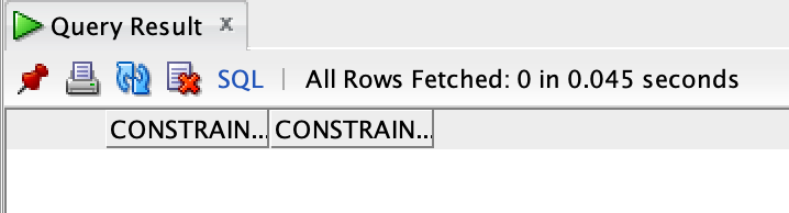

Tables without a Primary or Unique Key Constraint require additional research and may require special handling for instantiation. Using our demonstration table above, let’s walk through these additional steps.
1. Does the source table have a Primary or Unique Key? This MySQL query will list all constraints for a table:
SELECT
    CONSTRAINT_NAME,
    CONSTRAINT_TYPE
FROM
    INFORMATION_SCHEMA.TABLE_CONSTRAINTS
WHERE
    TABLE_SCHEMA = ‘[database name]’ AND TABLE_NAME = ‘[table name]’;
MySQL Constraints
Image 5. Table constraints
The source MySQL table does not have a Primary or Unique Key.

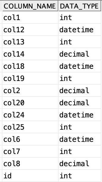

2. Are there any numeric or timestamp columns that can be used to create a unique pseudo-key?
If there are no constraints on the source MySQL table, check the table metadata for columns that could be used to create a pseudo-key; numeric and timestamp data works best for this. This query will return the columns with those data types:
SELECT
  COLUMN_NAME,
  DATA_TYPE
FROM
  INFORMATION_SCHEMA.COLUMNS
WHERE TABLE_SCHEMA = ‘[database name]’
  AND DATA_TYPE in (‘int’, ‘decimal’, ‘datetime’);
Columns
Image 6. Columns

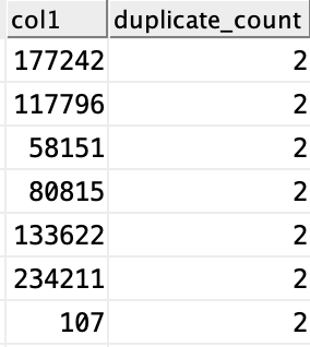

3. Do any of the potential pseudo-key columns contain duplicate data?
For each column returned, check if it contains duplicate data by executing this query:
SELECT
  [column name],
  COUNT([column name]) AS duplicate_count
FROM
  [table name]
GROUP BY [column name]
HAVING COUNT([column name]) > 1;
Duplicate rows
Image 7. Column with duplicates

For our demonstration table, table_25, this research determined that the INT data type column “id” meets the criteria for use as a pseudo-key; uniqueness and no NULL data.

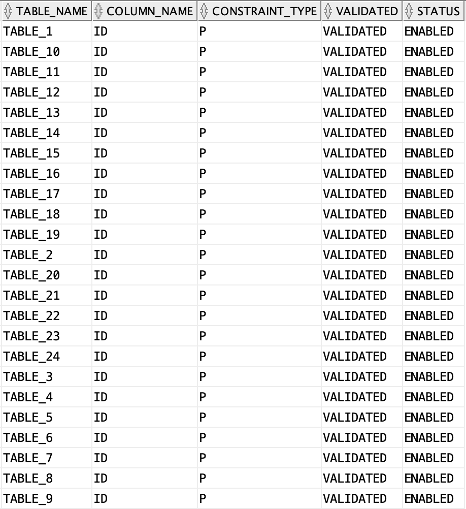

Identify Target Table Constraints
The following query will identify the type of constraint on each table in our Oracle schema and its status.
SELECT
    acc.table_name,
    acc.column_name,
    ac.constraint_type,
    ac.validated,
    ac.status
FROM
    all_cons_columns acc
JOIN
    all_constraints ac ON acc.owner = ac.owner
    AND acc.constraint_name = ac.constraint_name
    AND acc.table_name = ac.table_name
WHERE
    ac.constraint_type in (‘P’,’U’,’R’)
    and acc.owner = ‘[schema]’
    order by table_name;
Oracle constraints
Image 9. Oracle table constraints
It is important to note that Oracle GoldenGate for Oracle Database will not use Primary Key or Unique Key constraints that are not enabled or that have been create as NOVALIDATE as there is no guarantee of uniqueness for the constraint column.
Any Referential Integrity (Foreign Key) constraints should be disabled prior to starting the Initial Load Apply processes to prevent data integrity failures. These constraints can be enabled once the Initial Load completes.

Due to the target table, table_25, not having a Primary or Unique key we need to set the pseudo-key to match the setting in the source Change Data Capture Extract.
