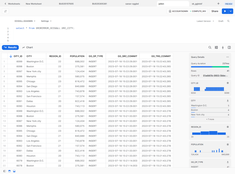

If we run the Replicat, we can see that the three extra fields are populated correctly. The native Snowflake handler in GoldenGate for Big Data uses a Stage & Merge approach which loads the data every 30 seconds, so the lag should be close to this value by default. This time interval can be modified using the flush.interval parameter.
Snowflake User Interface
Using the timestamps stored in GG_SRC_COMMIT and GG_TRG_COMMIT, we can calculate the end-to-end lag between our source and target! We have seen how simple it is to implement this requirement using GoldenGate functions like @GETENV and database functions like CURRENT_TIMESTAMP() in Snowflake. You can use a similar approach with other technologies supported by GoldenGate.
