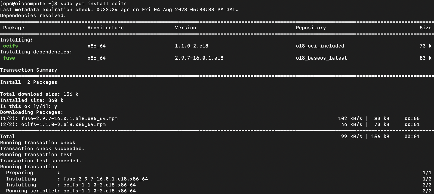

Install the OCIFS Utility
Use the below command to install the OCIFS utility

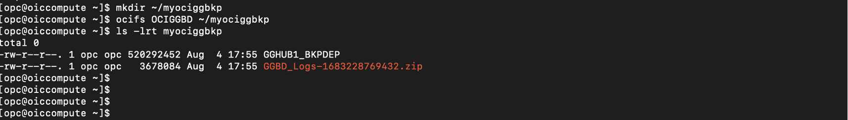

- Mount the OCI Object storage bucket using OCIFS
OCIFS lets you mount OCI Object Storage buckets to be used as file systems, and lets you manage the objects i.e. OCI GoldenGate deployment files in the mounted buckets as regular directories and files.
Here is an example to mount the OCI Object Storage bucket (OCIGGBD) on the ~/myociggbkp directory.
$ ocifs OCIGGBD ~/mydir
- Accessing OCI Object Storage Data as Regular Files
After the OCI Object Storage bucket containing the OCI GoldenGate deployment backup is mounted, OCI Object Storage data is accessible as regular files. Now you can use your regular shell commands to read, write, modify or add OCI Object Storage data.

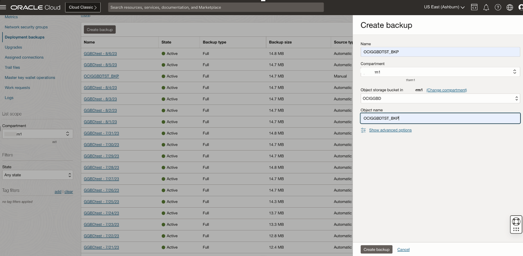

You can initiate a new manual backup for your OCI GoldenGate deployment using OCI console or OCI CLI command:
OR
CLI Command :
oci goldengate deployment-backup create --display-name <name> --compartment-id <compartment OCID> --deployment-id <deployment OCID> --namespace-name <namespace> --bucket-name <object storage bucket name> --object-name <backup filename>

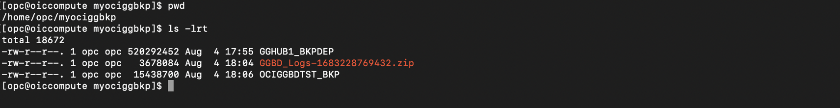

- Once the deployment backup is completed , you should be able to see the same reflected in your mounted directory

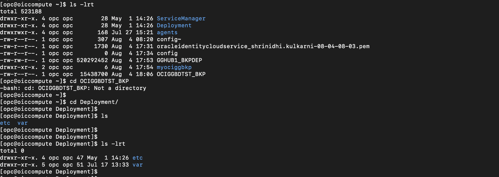

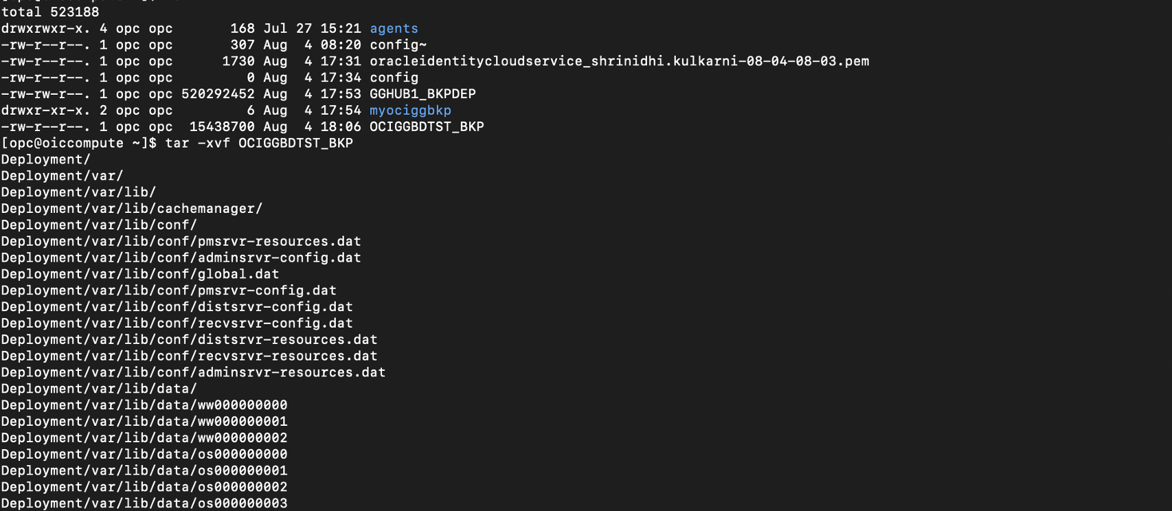

- Copy the OCI GoldenGate deployment backup to a different location using cp command and extract the backup using the tar command
- The manual deployment backup contains the full OCI GoldenGate deployment directory structure and files, including log and trail files. The directories and files that are helpful for troubleshooting are available under Deployment:
/etc/ogg: parameter files
/var: log files, checkpoint, trail files, and so on
/var/checkpt: checkpoint
/var/data: trail files
/var/report: report files
