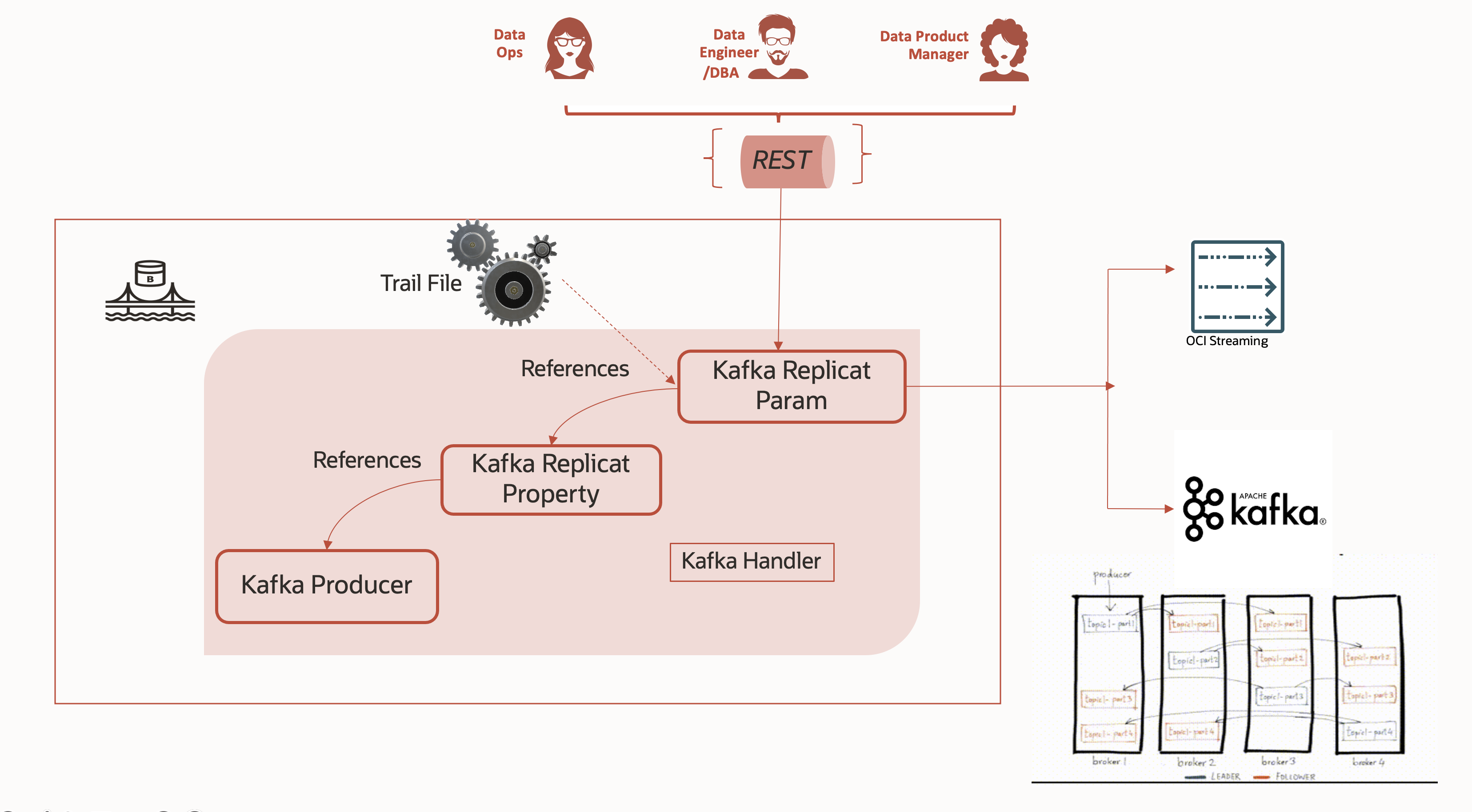

Oracle GoldenGate for Big Data uses Kafka Handler, allows you to capture and stream database changes from various databases supported by GoldenGate into Apache Kafka topics.The GoldenGate Kafka Handler defines how data is processed, transformed and delivered to Kafka topics. You can find the configuration properties for Kafka Handler here.
The following diagram illustrates how GoldenGate parameter files contains all the parameters regarding table mappings and references to Kafka Handler.The Kafka handler will include all key properties and the reference to the Kafka configuration file to interact and produce messages to Kafka.
ARCH-RESTAPI-GG4BD

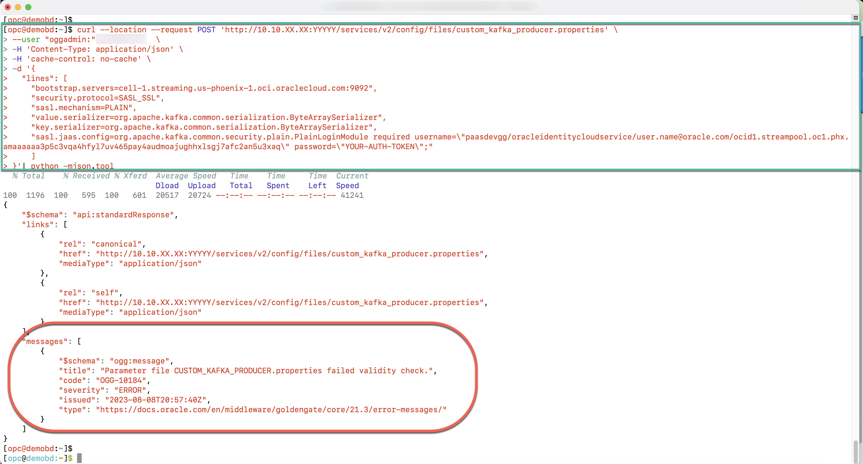

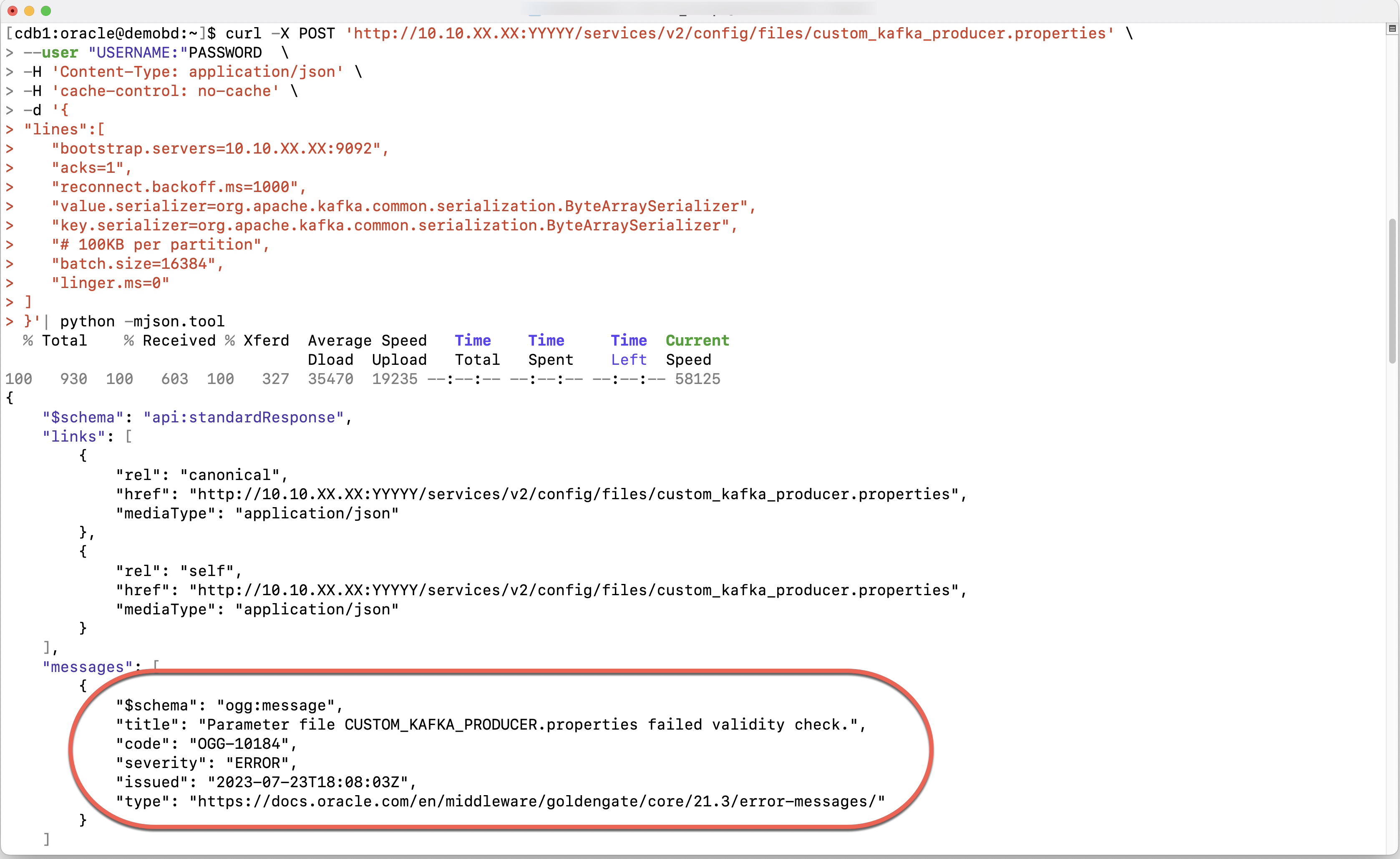

Note : you can safely ignore the error message “”title”: “Parameter file CUSTOM_KAFKA_PRODUCER.properties failed validity check.” in the cURL output.
Output of the Step 1.a:
oci stream kafka producer file

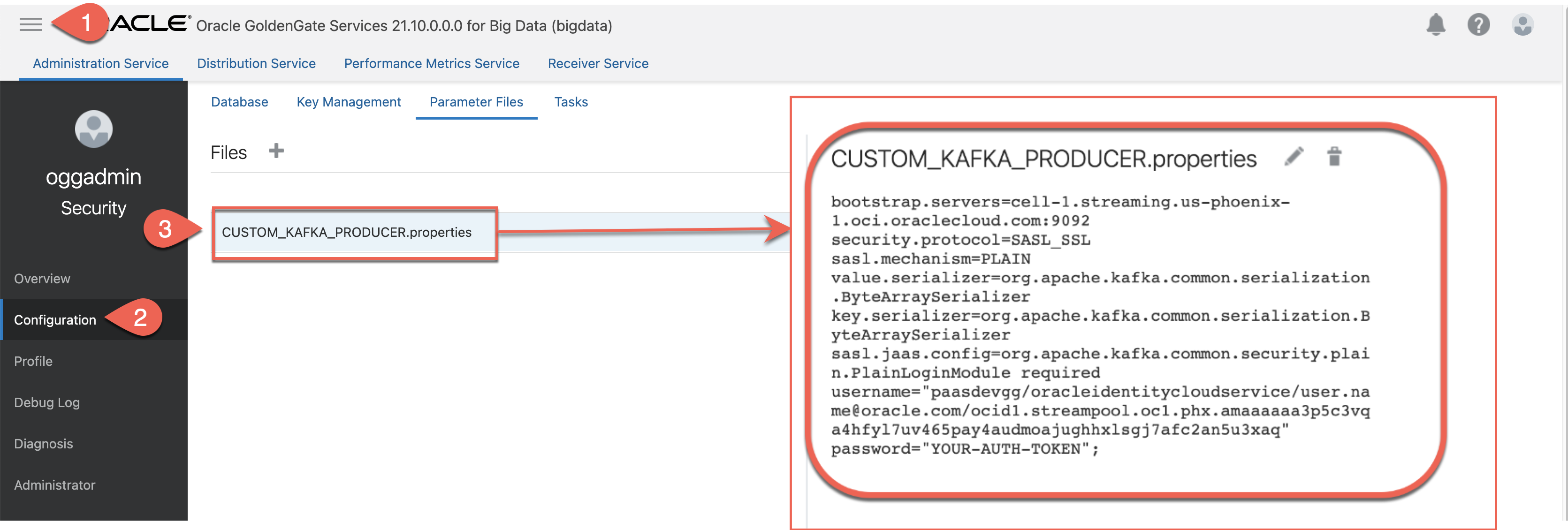

GoldenGate web console output for Step 1.b:
oci stream kafka producer file gg file

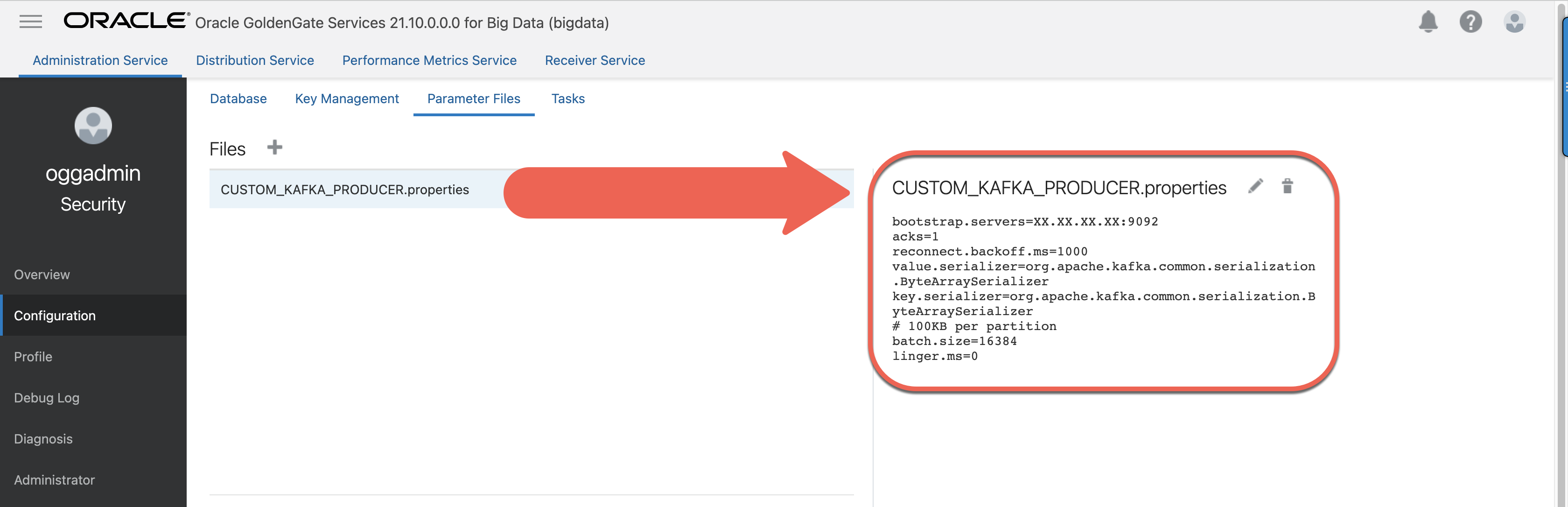

You can validate the above command on GoldenGate web console also. Click the hamburger menu( hamburger menu )in the upper right corner,Browse to Configuration and click the Parameter files.
gg-producer-properties-file

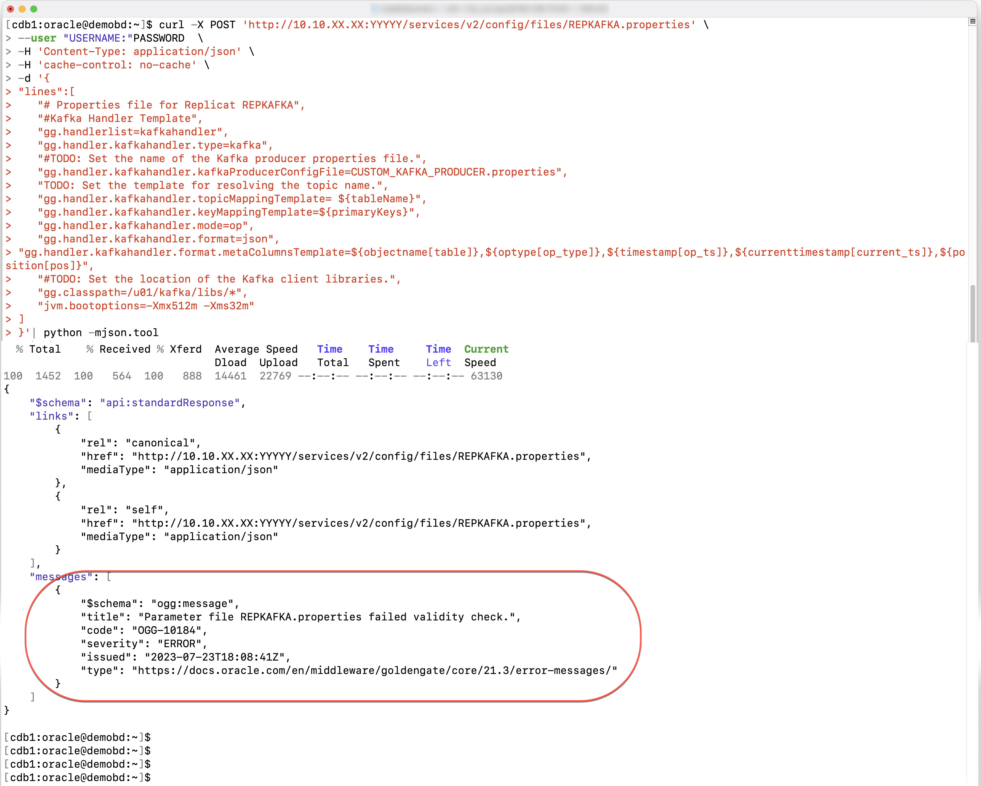

Note : you can safely ignore the error message “”title”: “Parameter file REPKAFKA.properties failed validity check.” in the cURL output.

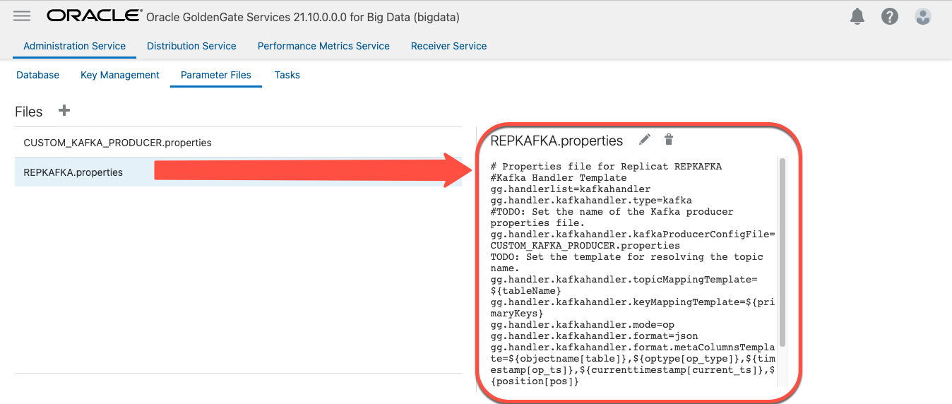

Output of the Step 2:
properties-files
GoldenGate web console output for Step 2:
gg-properties-file

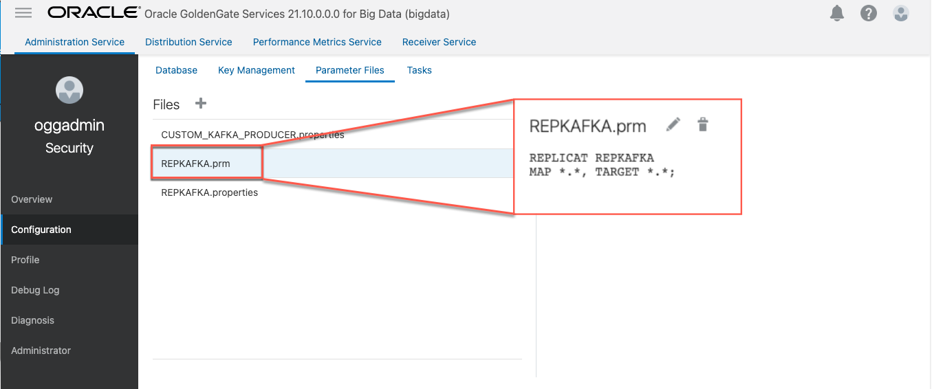

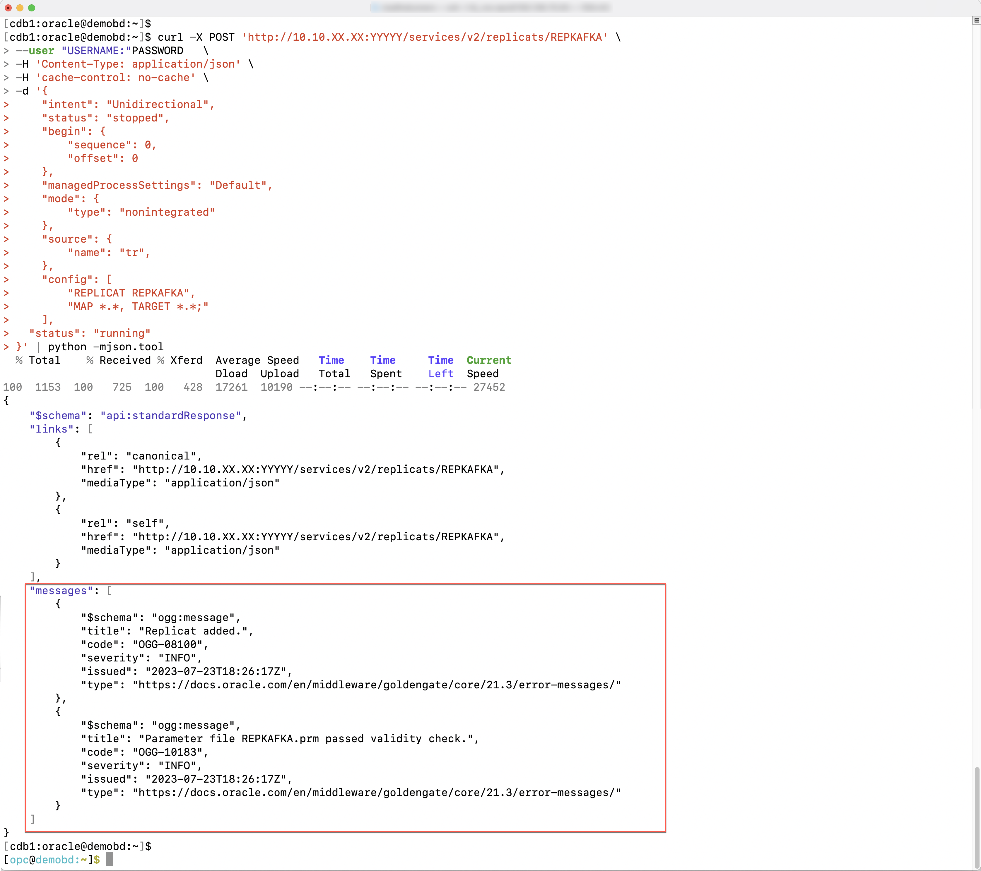

Output of the Step 3:
replicat-curl
GoldenGate web console output for Step 3:
replicat-param

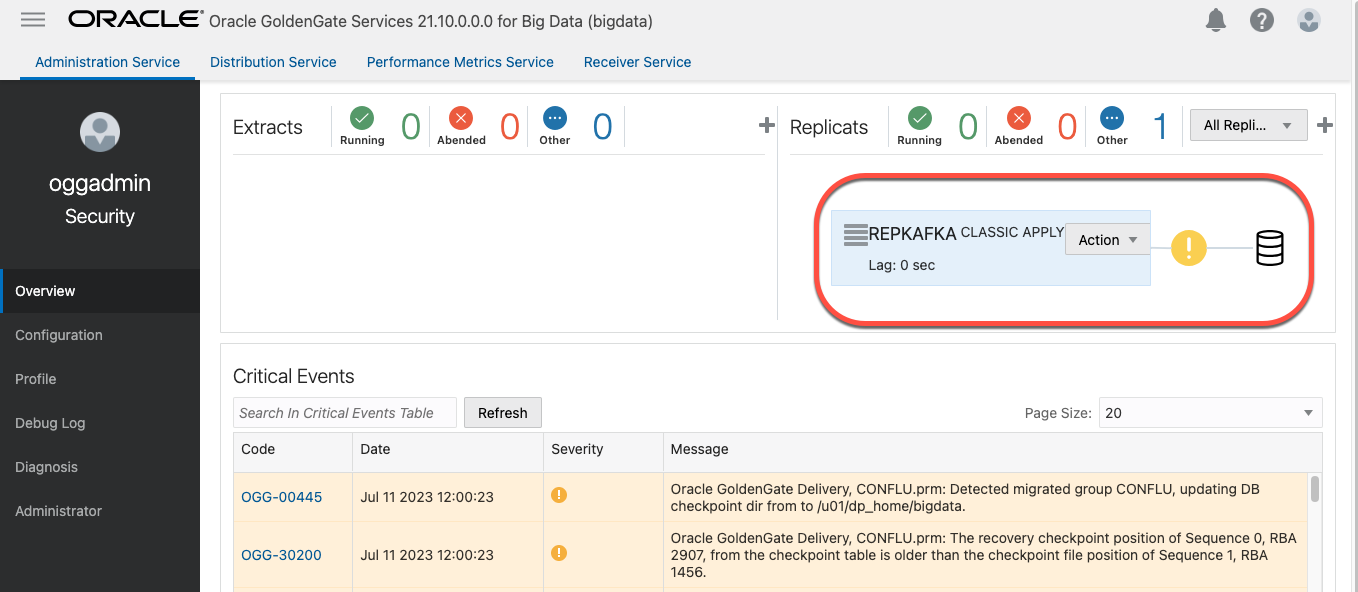

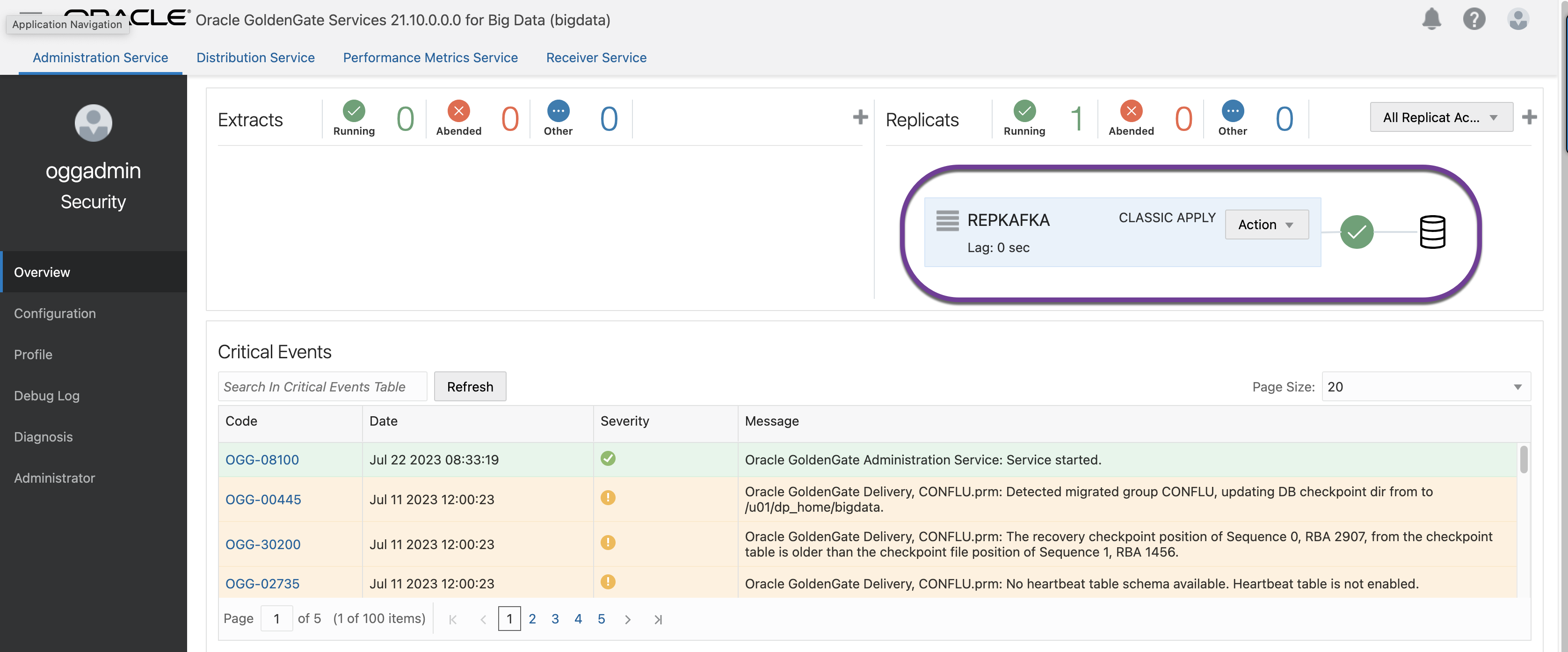

GoldenGate Replicat for Kafka has been created successfully.
replicat create

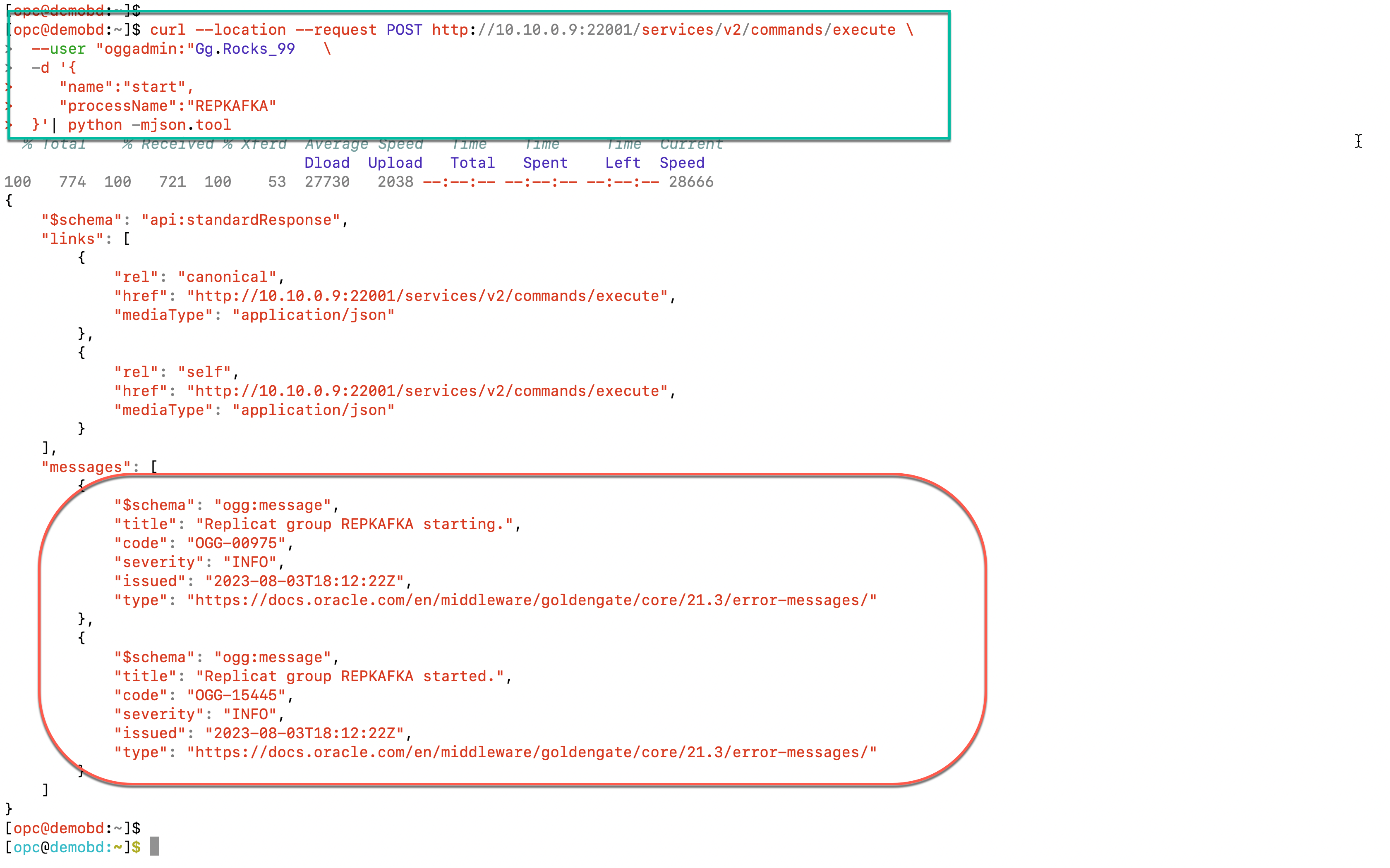

Step 4 : Start the GoldenGate Replicat.
curl --location --request POST http://<Admin-Server-IP/Hostname>:<Admin-Server-Port>/services/v2/commands/execute\
--user "USERNAME:"PASSWORD \
-d '{
     "name":"start",
     "processName":"REPKAFKA"
    }'| python -mjson.tool
Output of the Step 4:
kafka-replicat-start-curlGoldenGate web console output for Step 4:

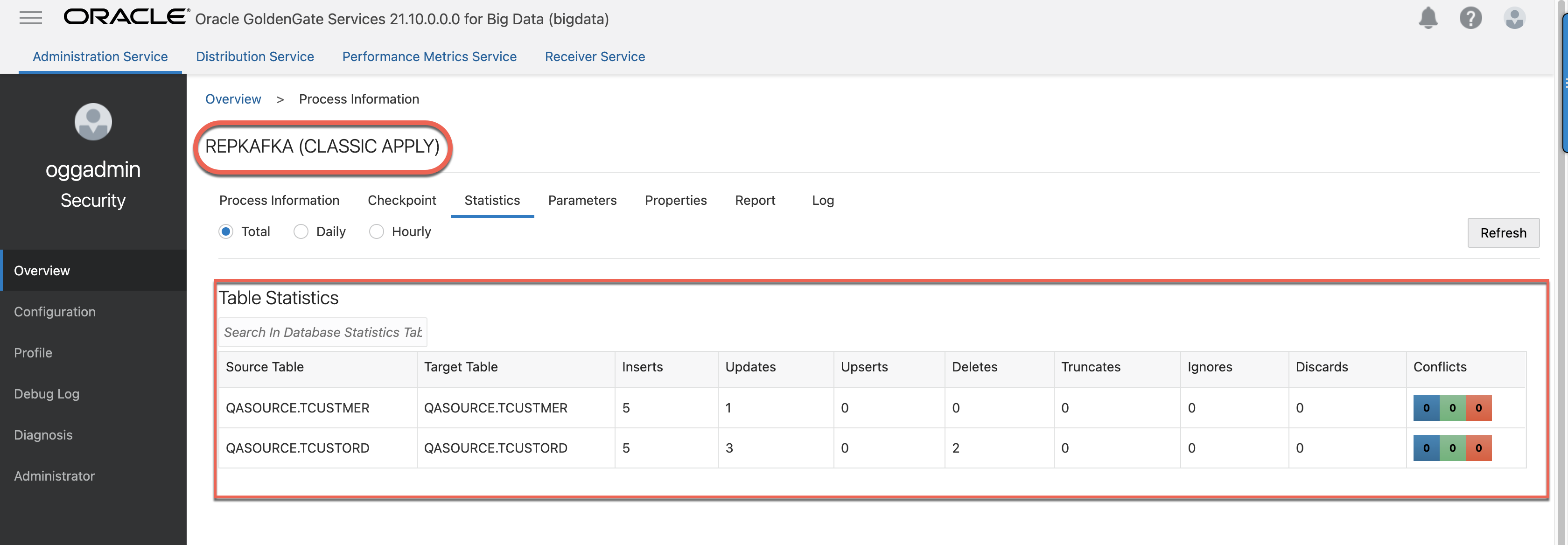

Step 5 : Validate the GoldenGate Replicat through stats.
curl --silent --location --request POST 'http://<Admin-Server-IP/Hostname>:<Admin-Server-Port>/services/v2/replicats/REPKAFKA/command' \
--data '{
        "command":"STATS",
        "arguments":"HOURLY"
}'|python -mjson.tool
GoldenGate web console output for Step 5:
stats
