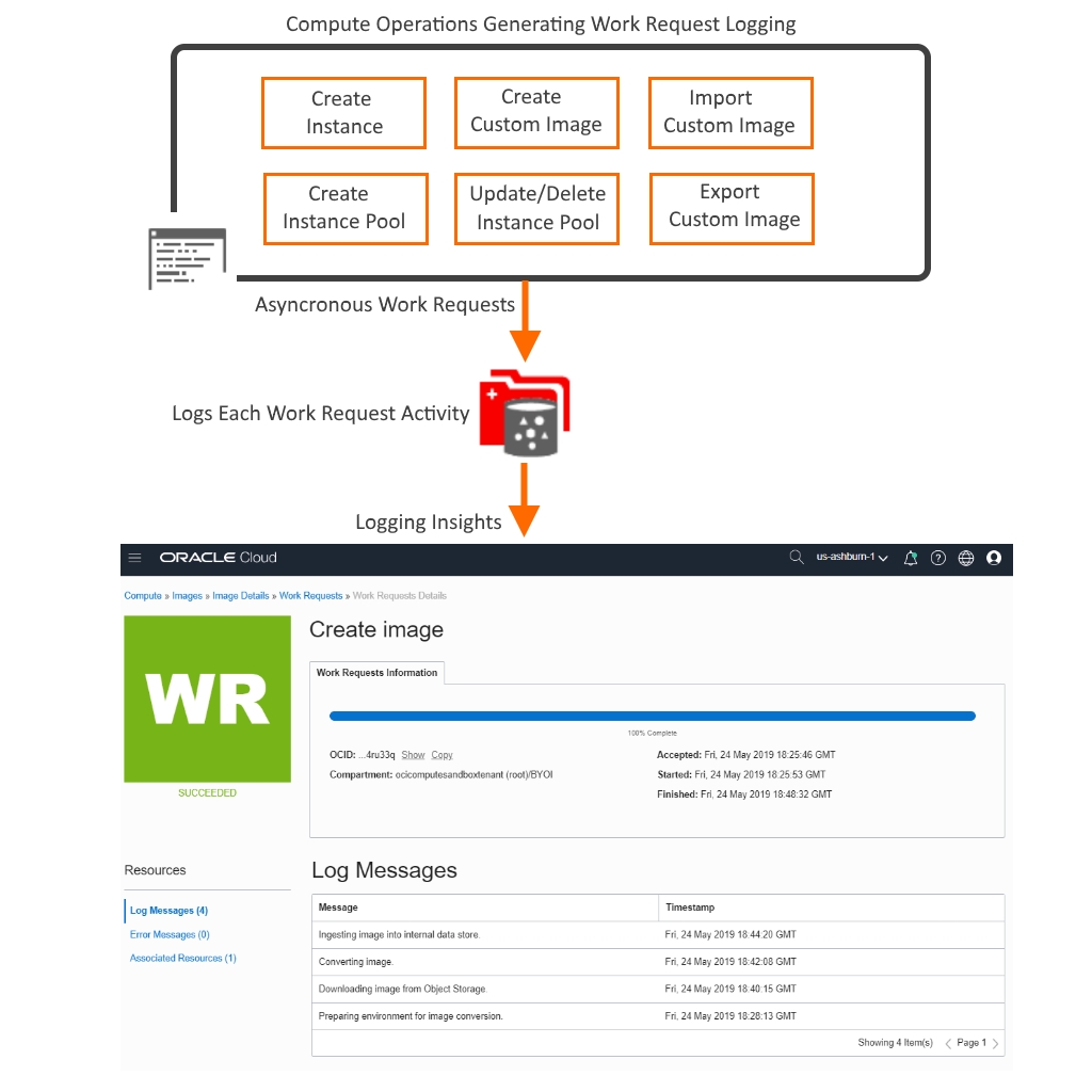

How Work Requests Work
Compute creates work requests for long-running operations that require sequential operations or have multiple affected resources that spawn asynchronous requests within a workflow. The output from the requests are logged, categorized, and consolidated into either informational or error messages.
Work requests answer three key questions:
  • Which operation was run?
  • When did it start and finish?
  • What is its current state, and if it failed, how did it fail?
Oracle Cloud Infrastructure Work Requests Process
For each operation, you can access the associated work requests and the insights for each activity collected through the Console, the CLI, and the API.

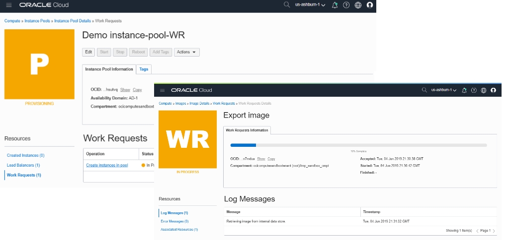

Access Work Requests in the Console
In the Console, you access work requests for a supported compute resource by navigating to the resource's details and selecting Work Requests in the Resources section.
Work requests return a set of defined status conditions, which provide a real-time indication of the state and completion progress of any running work request activity. The log retention period for this initial release is 12 hours. You can download the work request logs for a given compartment though the API or CLI and warehouse accordingly. For future releases, we are planning additional capabilities, such as retaining selected activity logs for longer periods and integrating with export/stream with Oracle Cloud Infrastructure Cloud Events for log event ingestion.

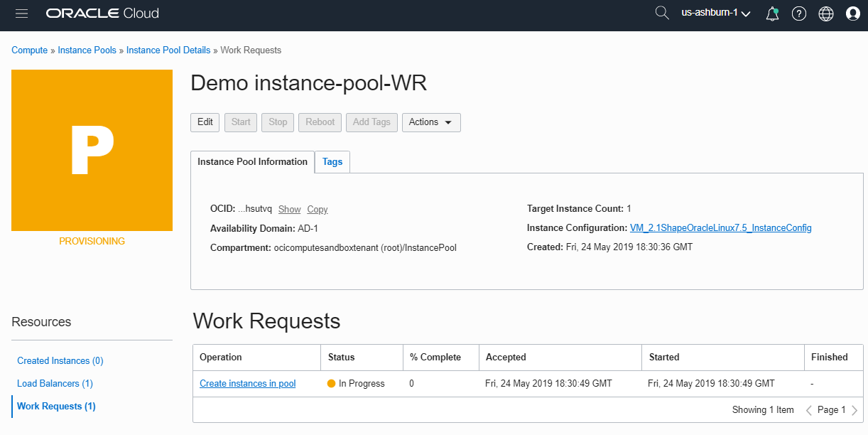

Example: Viewing the State of an Instance Pool Work Request
When you create an instance pool, a workflow based on the pool parameters that you set is initiated. This section shows an example of creating an instance pool and getting insights into why its creation failed.
When you initiate the creation of an instance pool in the Console, you are directed to the work requests view, as shown in the following image, where real-time status and completion progress are displayed.

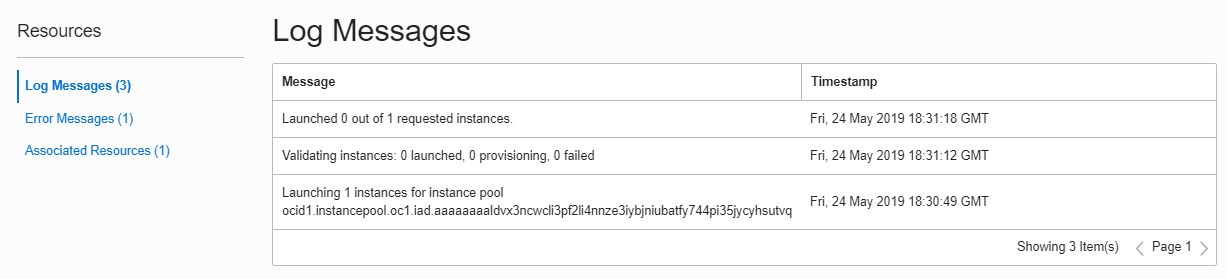

All activities are logged by the work request workflow. When you view the work request details, you can see log messages, error messages, and associated resources. Log and error messages for each activity provide a status description and timestamp. In the following image, the log messages show that no instances were launched in the pool, and there is one error message.

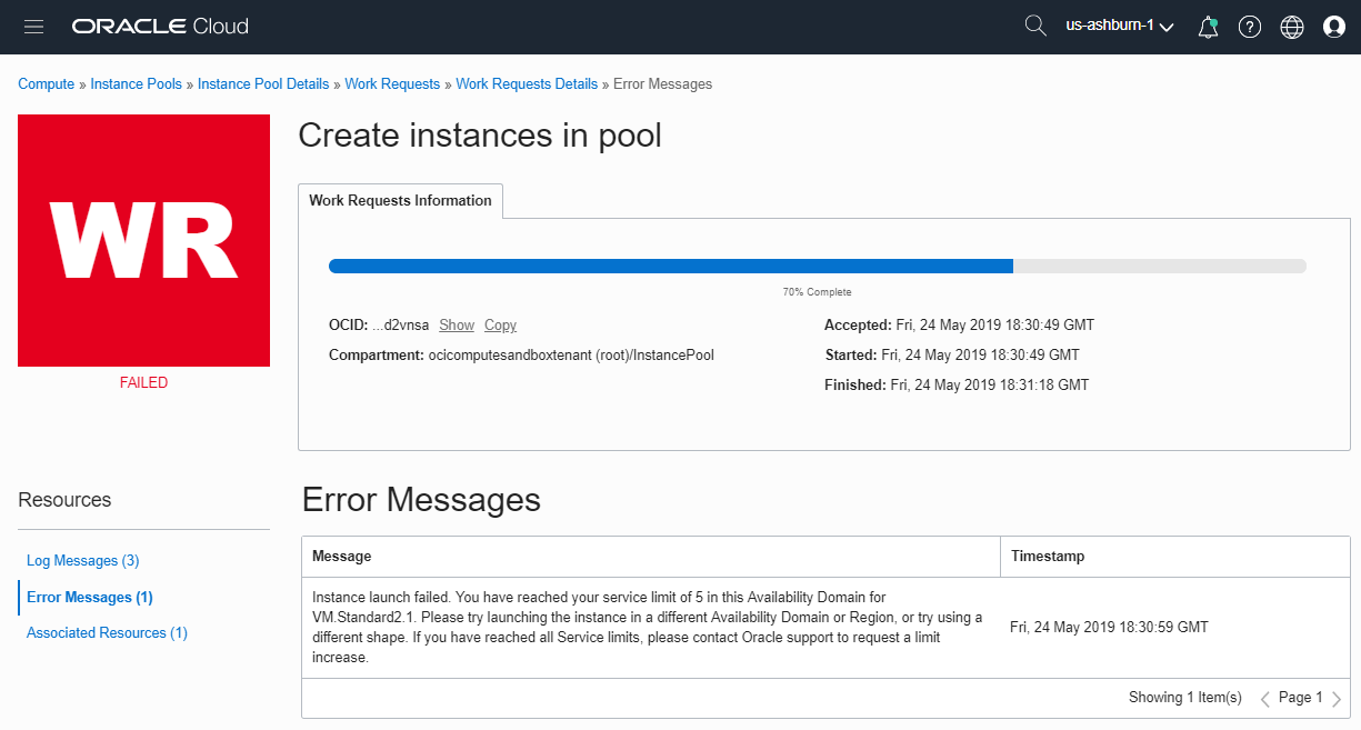

Work request error messages list failure log details. The following image shows that an instance launch failed because the service limit was reached in an availability domain for a VM.Standard2.1 shape. Recommended actions are also provided so that you can resolve the failure yourself, if possible.
