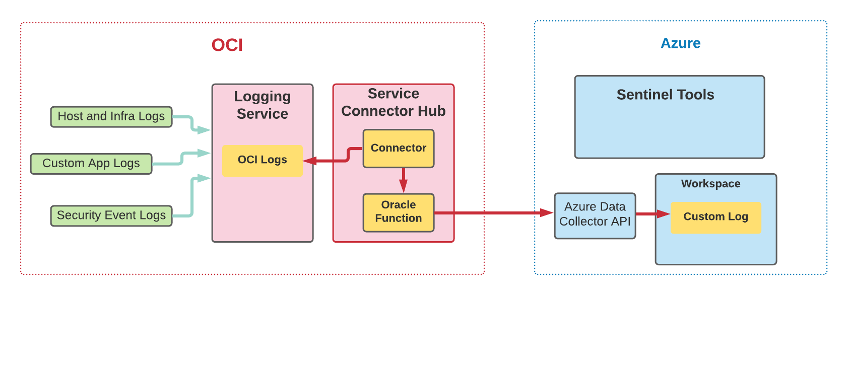

A much better strategy for exporting OCI log data to Azure Sentinel uses the OCI Logging service to transparently handle centralized log ingestion, data staging, and secure network export to Azure. The OCI Logging service is fully managed, robust, scalable, and designed to ingest infrastructure, platform, service, audit, and custom application logs. It allows automatic continuous log data export to Azure Sentinel using the related Service Connector Hub framework. The following image shows the high-level topology of this solution strategy:

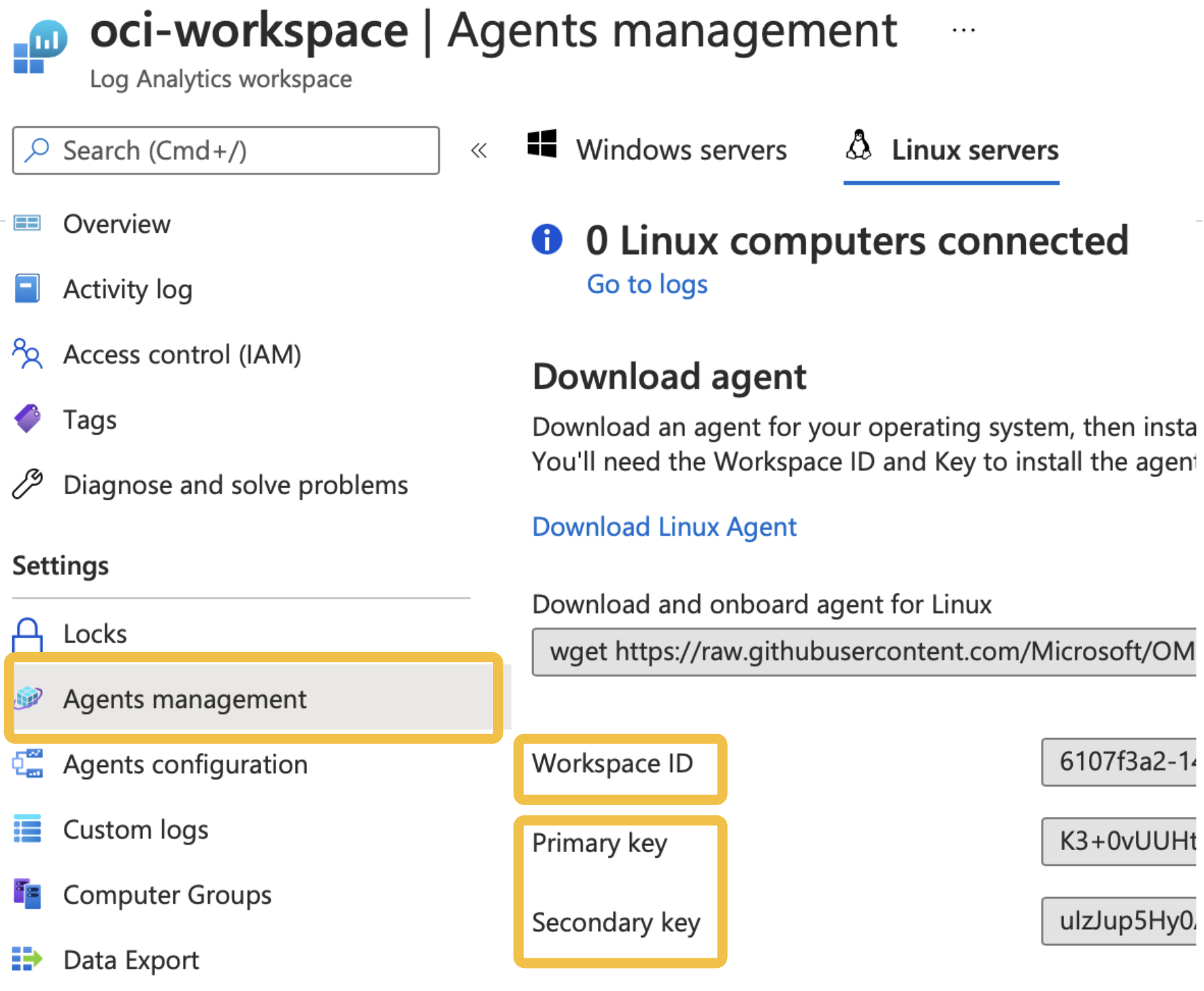

The parameter values must match your Azure Sentinel workspace environment. You can find the customer ID (workspace ID in the portal) and shared key values in the Azure Portal under Log Analytics workspace, your-workspace-name, and Agents management page. The log type parameter is a friendly name used to define a new (or select an existing) custom log in your Azure Log Analytics workspace and the target location for data uploads.

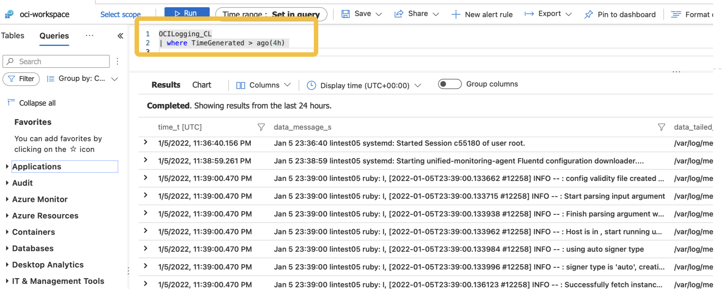

OCI Log Data is available in the Azure Log Analytics custom log table name specified in step 1. You can now use this data for all your Sentinel log search, report, and analytics queries.
