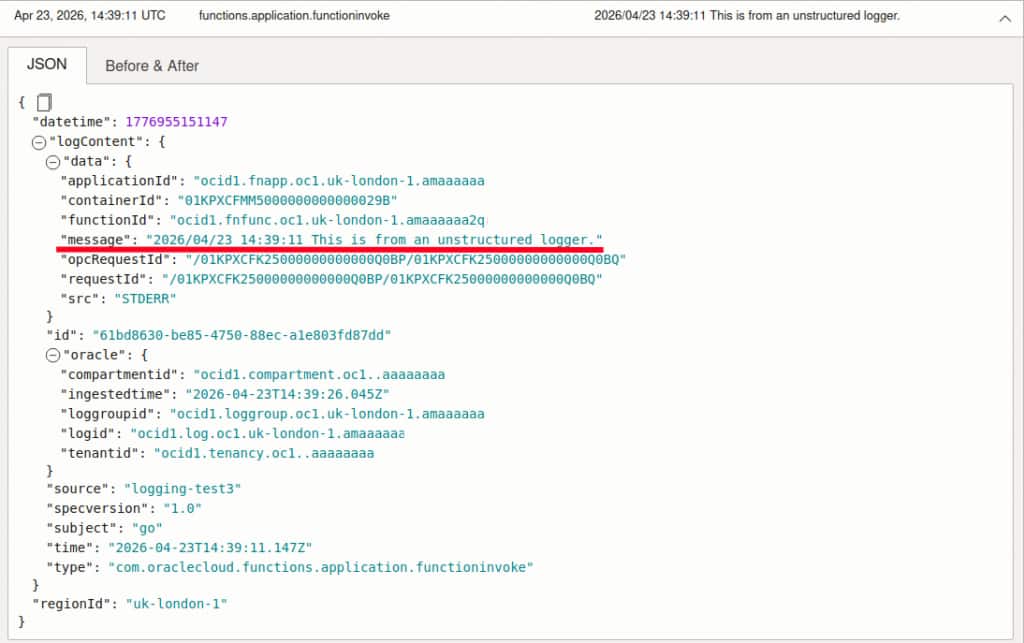

Since launch, OCI Functions has supported integration with OCI Service Logs, allowing users to view logs emitted by their function code in the OCI Logging service. When enabled, log lines emitted via stdout/stderr appear in the OCI Logging service as strings.
A screenshot showing a plain text string in the 'message' field in the OCI Logging UI
This works well enough for functions which emit plain text log lines, as in the above example. However, we are limited to just a single string field, and simple text search on that field.

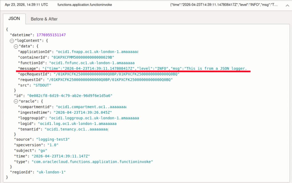

Previously, even if your function code emitted log lines in this structured format, the log line would appear in OCI Logging as a string, with any JSON escaped, limiting its usefulness.
A screenshot showing a an escaped JSON object in a string in the 'message' field in the OCI Logging UI

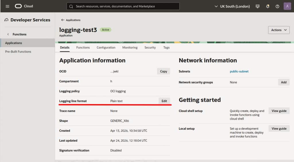

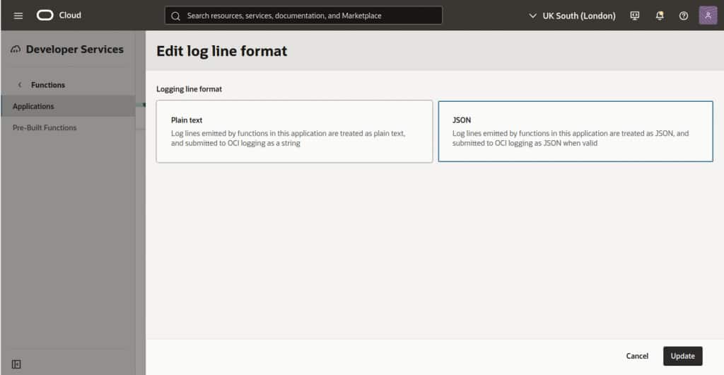

  1. Open the Functions service in the OCI Console.
  2. Select your application.
  3. Under Application Information, click Edit on the Logging line format row.
  4. Choose JSON and click Update.
A screenshot showing the application details page in the OCI Console, with the 'Logging line format' field highlighted
A screenshot showing the 'Edit log line format' modal in the OCI Console, with options of 'Plain text' or 'JSON'

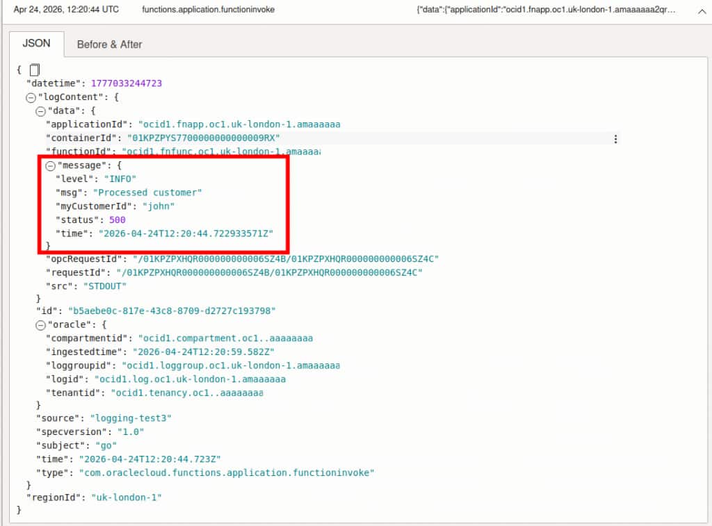

With the logging line format of our application configured to JSON, we can now explore our custom log fields within each line in the Logging Search UI:
A screenshot showing an expanded native JSON object in the 'message' field in the OCI Logging UI

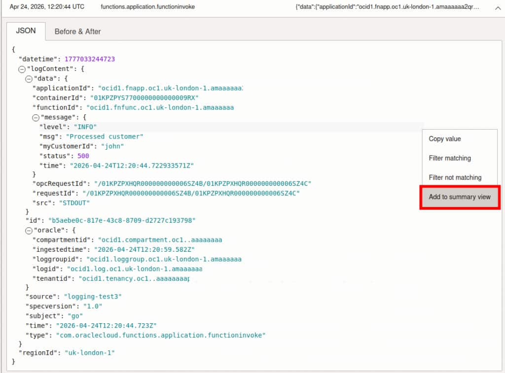

Within the ‘message’ field, you can see fields from the JSON log line emitted by my function, including ‘level’ and ‘myCustomerId’. Using the Logging Search UI, we can add columns to our summary view:
A screenshot showing the right-click menu for a field in the OCI Logging UI, with the 'Add to summary view' button highlighted

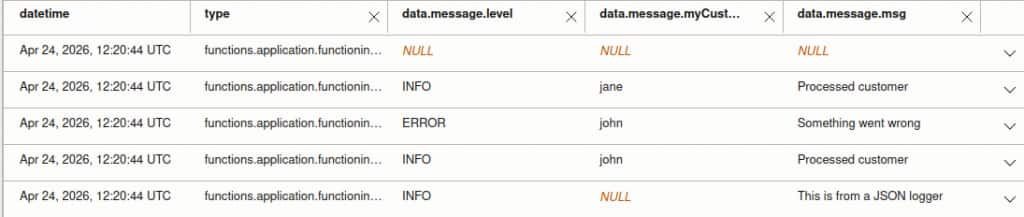

This allows us to build a view focused on fields relevant to our application:
A screenshot showing the summary view in the OCI Logging UI, with several columns for application-specific log fields

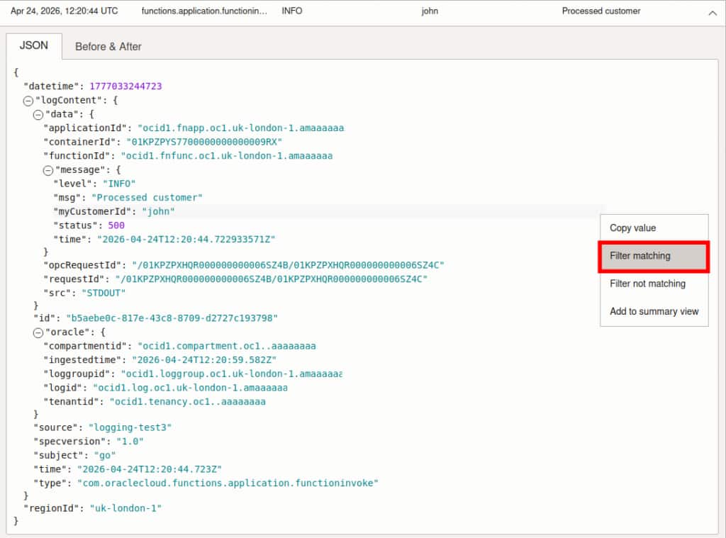

We can also easily filter by value for a given field:
A screenshot showing the right-click menu for a field in the OCI Logging UI, with the 'Filter matching' button highlighted

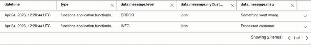

This allows us to focus on e.g. log lines pertaining to a given customer ID:
A screenshot showing the summary view in the OCI Logging UI, with several columns for application-specific log fields. Only log lines where the value of the 'myCustomerId' field is 'john' are shown
