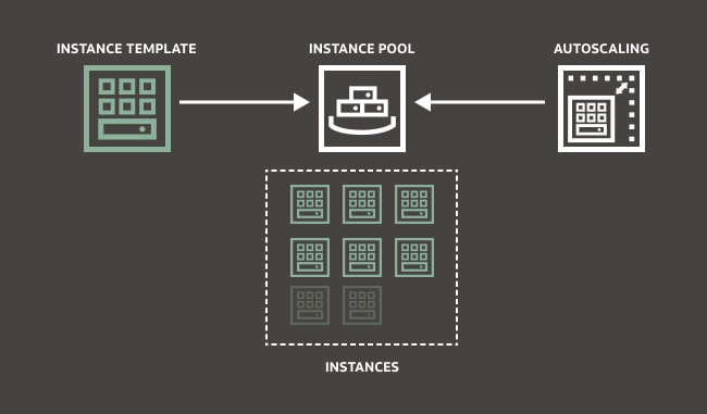

Autoscaling lets you automatically adjust the number or the lifecycle state of Compute instances in an instance pool. With autoscaling, you can provide consistent performance to your end users during spikes in demand and reduce your costs during periods of low demand.
We use autoscaling configurations to automatically manage the size and lifecycle state of your instance pools. When autoscaling automatically provisions instances in an instance pool, the pool scales out. When autoscaling removes instances from the pool, the pool scales down. You can also use autoscaling to stop and start instances in an instance pool based on a schedule.
To set up autoscaling, we deploy the following resources using Terraform:
​A graphic depicting the workflow for using autoscaling on instance pools.
