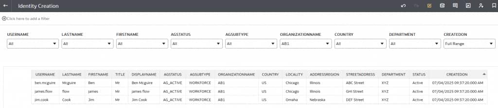

- Identity Creation: The report to display the identities created within a specific date range along with their complete details.

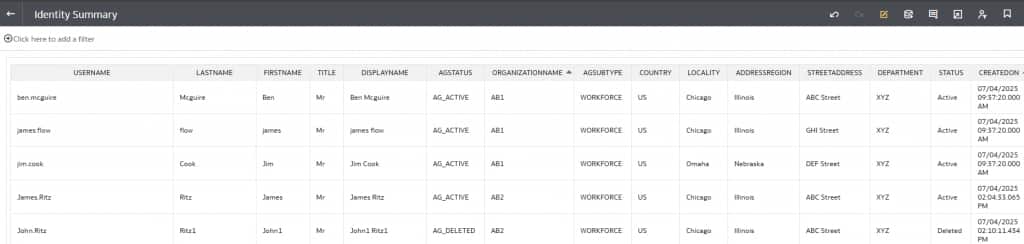

- Identity Summary: The report to display all the identities and their details.

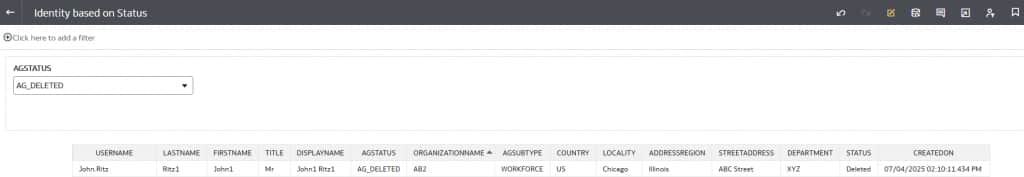

- Identity based on Status: The report to display all the identities based on their AG status.

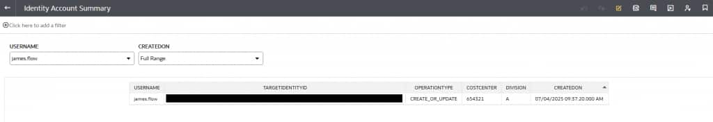

- Identity Account Summary: The report to display the orchestrated identity objects associated with the identities.
