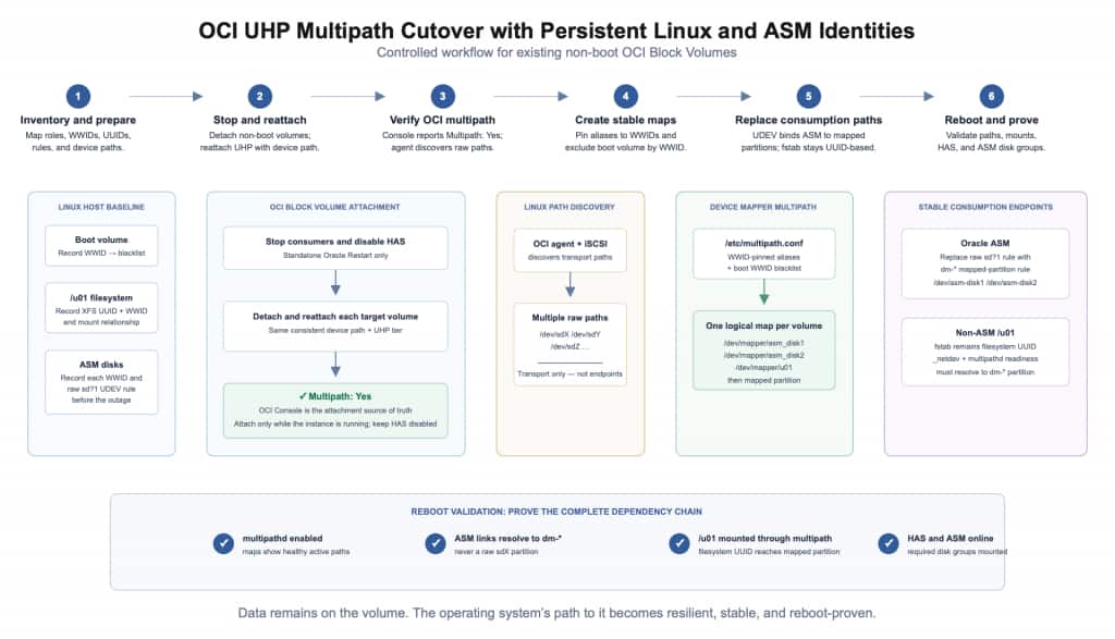

OCI UHP multipath cutover workflow
Persistent identities replace transient raw device paths
  1. Inventory
    Map each volume’s role, WWID, filesystem UUID, current device path, mount point, and UDEV rule.
  2. Stop consumers and reattach
    Stop databases, Oracle ASM, Oracle Grid Infrastructure, and filesystem consumers. Detach and reattach each target volume using the validated consistent device path.
  3. Verify OCI and host discovery
    Confirm Multipath: Yes in the OCI Console. Confirm that the host discovers the expected transport paths and one map for each WWID.
  4. Create persistent maps
    Bind each target WWID to a meaningful alias. Apply a boot-volume exclusion only after validating that design for the host.
  5. Replace consumption paths
    Point Oracle ASM UDEV rules to mapped partitions. Keep ordinary filesystem mounts UUID-based.
  6. Reboot and validate
    Validate the complete dependency chain: iSCSI sessions, multipath maps, mapped partitions, UDEV links, /u01, High Availability Services, Oracle ASM, and required disk groups.
Keep High Availability Services disabled until the mapped paths and ordinary filesystems have been validated manually.
Figure 1: OCI UHP multipath cutover workflow. The raw sdX paths are transport paths; stable WWID-pinned multipath aliases, mapped partitions, UDEV links, and filesystem UUIDs are the persistent consumption endpoints.
Figure 1: OCI UHP multipath cutover workflow. Raw sdX devices are transport paths. WWID-pinned aliases, mapped partitions, UDEV links, and filesystem UUIDs are the persistent consumption endpoints.

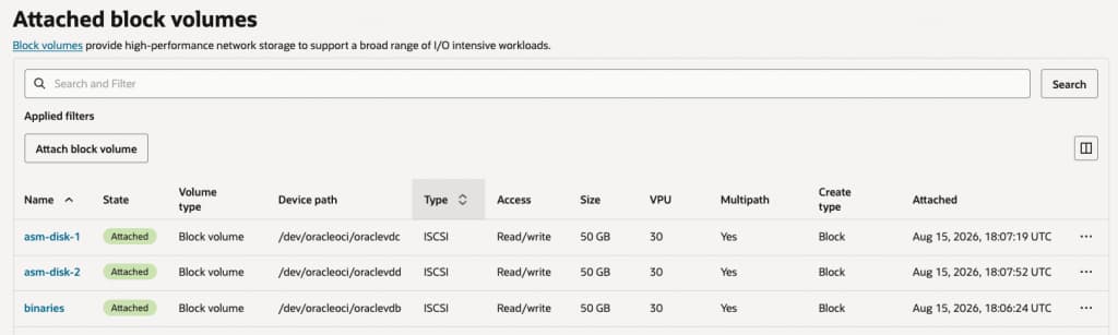

  4. Verify Multipath: Yes for each target attachment in the OCI Console.
  5. Validate the host maps and paths.
On the reference host, attach attempts issued while the instance was stopped failed. The sequence validated for that environment was to stop the applications, disable HAS, detach the non-boot volumes, start the instance with HAS still disabled, and then reattach the volumes. Confirm with the OCI product owner whether that observation applies to the exact target environment before presenting it as a general requirement.
sudo systemctl is-active multipathd
sudo multipath -ll
Each target WWID should appear in one map containing the paths OCI established for that attachment. Usable paths should report the expected healthy state, such as active ready running.
Do not configure to a fixed path count. Path counts can vary by attachment and platform configuration.
OCI Console validation after reattachment: all three UHP volumes are attached through iSCSI with Multipath set to Yes.
Figure 2: OCI Console validation after reattachment. Each target UHP volume is attached through iSCSI with Multipath set to Yes.
Raw sdX paths are transport paths. Oracle ASM and mounted filesystems should consume the mapped device or its mapped partition.

5. Re-enable HAS, reboot, and validate the complete chain
Keep High Availability Services disabled until the multipath maps, mapped partitions, UDEV links, and /u01 mount have been validated manually.
sudo systemctl is-enabled multipathd
sudo multipath -ll
ls -l /dev/asm-disk1 /dev/asm-disk2
findmnt -no SOURCE,TARGET /u01
For a standalone Oracle Restart host only:
sudo /path/to/grid/home/bin/crsctl enable has
sudo reboot

The validation is successful when:
  • Every target map has the intended WWID and the expected healthy paths.
  • Oracle ASM links resolve only to mapped partitions.
  • /u01 is mounted through the u01 multipath partition.
  • High Availability Services is online.
  • Oracle ASM is online.
  • Every required Oracle ASM disk group is mounted.
One successful reboot helps validate the tested dependency chain, but it does not replace ongoing monitoring, backups, or documented recovery procedures.

Conclusion
Multipath changes how Linux identifies and consumes an OCI Block Volume. In the reference configuration, the durable pattern is to use persistent identities throughout the stack:
  • A WWID for each underlying volume.
  • A meaningful, WWID-pinned DM-Multipath alias.
  • A mapped partition for Oracle ASM.
  • A constrained UDEV link for Oracle ASM discovery.
  • A filesystem UUID for an ordinary filesystem mount.
The host-side procedure does not require copying application data or reformatting the existing filesystem. It changes the operating system’s path to that data. Transient device letters and dm-N numbers can change; WWIDs, aliases, mapped-partition properties, UDEV links, and filesystem UUIDs provide the persistent identity needed for a durable configuration.
Complete the change only after an approved reboot window confirms the intended paths, ordinary filesystem mounts, High Availability Services, Oracle ASM, and required disk groups.
Appendix: representative final state
The following output is illustrative. Replace every placeholder with values collected from the target host.
Persistent mappings
RoleSCSI WWIDPersistent map and partitionConsumption endpoint
Boot volume<BOOT_WWID>Outside the target multipath maps; host-specific exclusion if validatedOS boot volume
/u01 filesystem<U01_WWID>/dev/mapper/u01 and /dev/mapper/u01p1/u01, mounted by filesystem UUID
Oracle ASM disk 1<ASM_DISK1_WWID>/dev/mapper/asm_disk1 and /dev/mapper/asm_disk1p1/dev/asm-disk1
Oracle ASM disk 2<ASM_DISK2_WWID>/dev/mapper/asm_disk2 and /dev/mapper/asm_disk2p1/dev/asm-disk2
