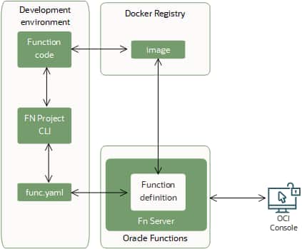

Deploy to OCI Functions
Once your function code is ready, you can start the deployment workflow with a single Fn Project CLI command. Behind the scenes, that command runs the following steps in order:
- Builds a Docker image from your function code.
- Creates (or updates) the function definition in a func.yaml file, including:
- the maximum execution time allowed for the function
- the maximum memory the function can use
- Pushes the image to the Docker registry you’ve configured.
- Uploads function metadata to the Fn Server, such as the memory and timeout limits, plus a reference (link) to the image in the registry.
- Registers the function in the OCI Console, so it appears in your list of functions.
The diagram below illustrates this end-to-end deployment process in OCI Functions.
Keep in mind that after the image is pushed to your container registry, maintaining it is up to you. For example, when newer language runtimes become available, you’ll need to rebuild and republish your image to take advantage of them (see Function Development Kits (FDKs) for details).

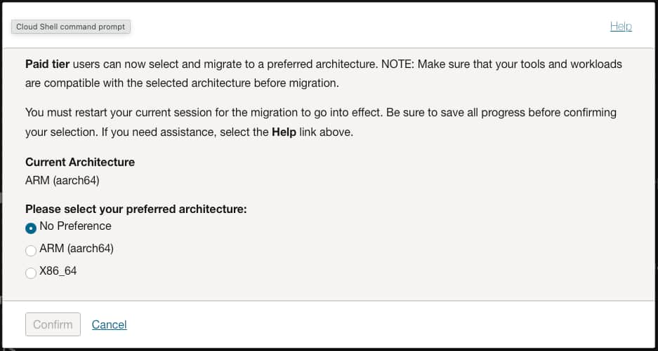

Let’s begin by launching a OCI CloudShell session that will be our terminal and platform for running the example. Also make sure that the network your CloudShell is connected to is listed as Public to make sure you can reach the public Internet.
Important: Make sure that the architecture (x86 / ARM) of your CloudShell instance matches the OCI Functions Application architecture, otherwise the build & deploy step will fail.

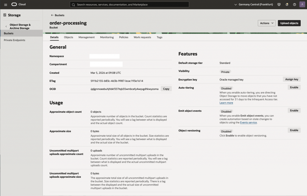

2. Create an Oracle Object Storage Bucket
First of we need to create a new bucket called order-processing in OCI Object Storage. This bucket will be used as a destination to store the received order requests.
Important: If the creation of a bucket result in a API Error a common cause is that there is already a existing bucket in your compartment with the same name or a permission error for the user tyring to create bucket.

- Set the Shape(ARM or X86) to match the CloudShell architecture you’re using; you can find this in CloudShell on the top left Actions > Architecture listed as Current Architecture

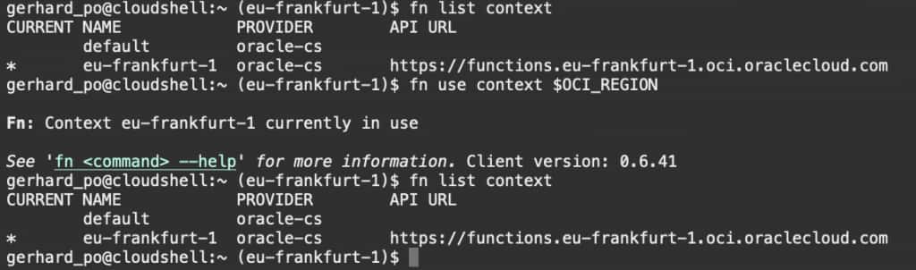

6. Set the fn context to your tenancy’s home region
fn list context
fn use context $OCI_REGION
fn list context

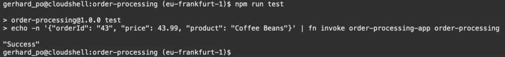

Send a test request to the function
Execute npm run test, which will send a sample request to the function. You can look at the definition of that task in package.json and send your own test requests.
Look at the objects of bucket order-processing and verify that the order information has been written to the bucket.
