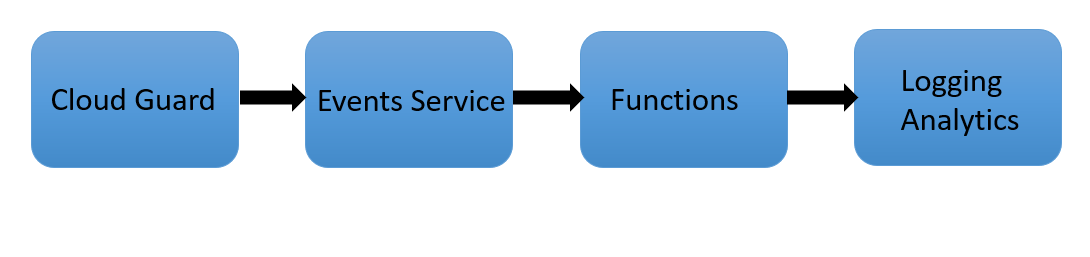

The following graphic depicts the architecture for the solution:
When Cloud Guard emits events that match with the defined rule conditions, the OCI Events service triggers the specified function. When invoked, the Functions code reads logs data from Events and sends them to the Logging Analytics upload API endpoint. We can then view the logs from Log Explorer dashboard and process them for any further visualizations and insights.

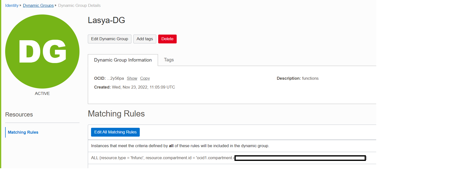

For OCI Functions to access Logging Analytics, fetch,and upload logs, the function must be included in a dynamic group. Then create a policy to grant the dynamic group access to Logging Analytics resources, such as log groups and log sources. For more information, refer to Accessing Other Oracle Cloud Infrastructure Resources from Running Functions.
To create a dynamic group, under Menu, navigate to Identity and security, Identity, and selectDynamic Groups.
Keep the matching rule as ALL {resource.type = ‘fnfunc’, resource.compartment.id = <compartment id>}. This rule places all functions under the compartment into the dynamic group.

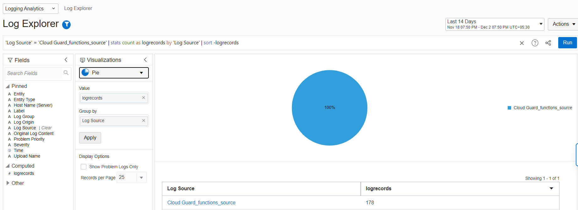

We can verify the uploaded Cloud Guard logs on the Log Explorer dashboard. In the menu, select Observability & Management, Logging Analytics, and Log Explorer.
