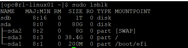

To get raw performance of a persistent disk, I created a 1-TB block volume and attached it to an Oracle Linux Compute instance. If you want to know how, see Attaching a Volume in the documentation.
A screenshot of the resulting code from attaching a block volume.

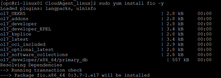

I then connected to the instance and installed FIO.
A screenshot of FIO installed and running in the Console.

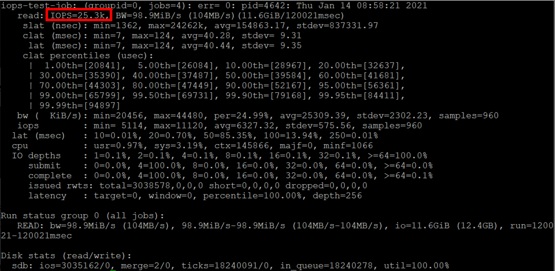

Random reads test (based on 4 K block size)
sudo fio --filename=/dev/sdb --direct=1 --rw=randread --bs=4k --ioengine=libaio --iodepth=256 --runtime=120 --numjobs=4 --time_based --group_reporting --name=iops-test-job --eta-newline=1 –readonly
A screenshot of the resulting code run in the Console with one line outlined in red.

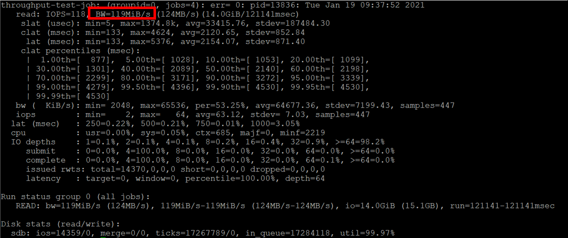

Latency performance test (based on 4K Block Size)
sudo fio --filename=/dev/sdb --direct=1 --rw=randread --bs=4k --ioengine=libaio --iodepth=64 --runtime=120 --numjobs=4 --time_based --group_reporting --name=throughput-test-job --eta-newline=1 --readonly
A screenshot of the test results for throughput with a line outlined in red.

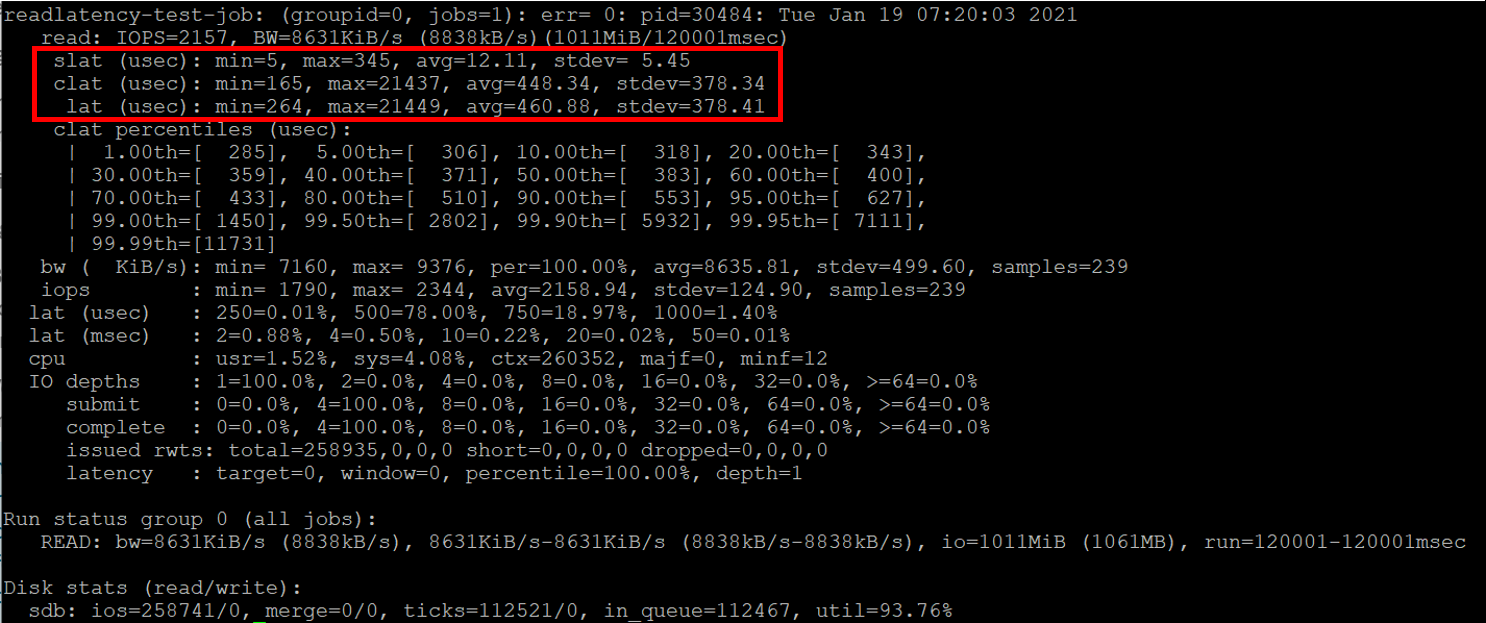

sudo fio --filename=/dev/sdb  --direct=1 --rw=randread --bs=4k --ioengine=libaio --iodepth=1 --numjobs=1 --time_based --group_reporting --name=readlatency-test-job --runtime=120 --eta-newline=1 --readonly
A screenshot of the latency performance test with three lines of code outlined in red.
From the three results, we’re getting the maximum 25,000 IOPs from random read test, 119 MiB/s from throughput performance, and between 264 microseconds–21 milliseconds from latency performance test, on the 1-TB block volume. We’ve configured to use Linux native AIO (using the ioengine=libaio parameter in FIO command), so the Linux caching system doesn’t interfere with these results.
