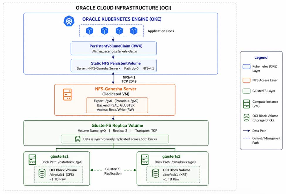

Solution Overview
The implementation consists of three layers:
  • Oracle Kubernetes Engine, where application pods consume shared storage through a Kubernetes PersistentVolumeClaim.
  • NFS-Ganesha, which exports the GlusterFS volume over NFSv4.1.
  • GlusterFS, which provides replicated shared storage using OCI Block Volumes as storage bricks.
The resulting architecture allows Kubernetes to use standard NFS while GlusterFS continues to manage data replication and storage.
Architecture
architecture

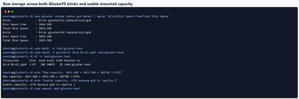

Each virtual machine was attached to a dedicated 1 TB OCI Block Volume formatted with XFS and configured as a GlusterFS brick; the Gluster volume was created as replica 2, providing synchronous replication across both nodes and resulting in approximately 1 TB of usable capacity from 2 TB of raw storage.

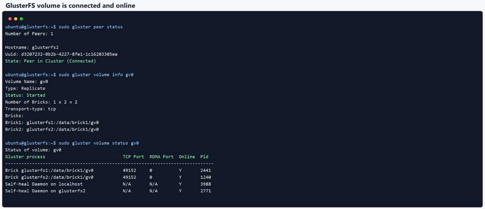

After verifying connectivity, the two servers were joined into a trusted storage pool by probing the peer from the first node.
# Run on glusterfs1 only.
sudo gluster peer probe glusterfs2
sudo gluster peer status
The expected state was:
State: Peer in Cluster (Connected)
A replicated volume named gv0 was then created and started.
# Run on both GlusterFS servers.
sudo mkdir -p /data/brick1/gv0
sudo gluster volume create gv0 replica 2 transport tcp \
  glusterfs1:/data/brick1/gv0 \
  glusterfs2:/data/brick1/gv0 \
  force
sudo gluster volume start gv0
sudo gluster volume info gv0
sudo gluster volume status
At this point the GlusterFS cluster was operational and ready to expose storage to Kubernetes.
glusterfs volume is connected and online
Raw storage across both Glusterfs bricks and usable mounted capacity

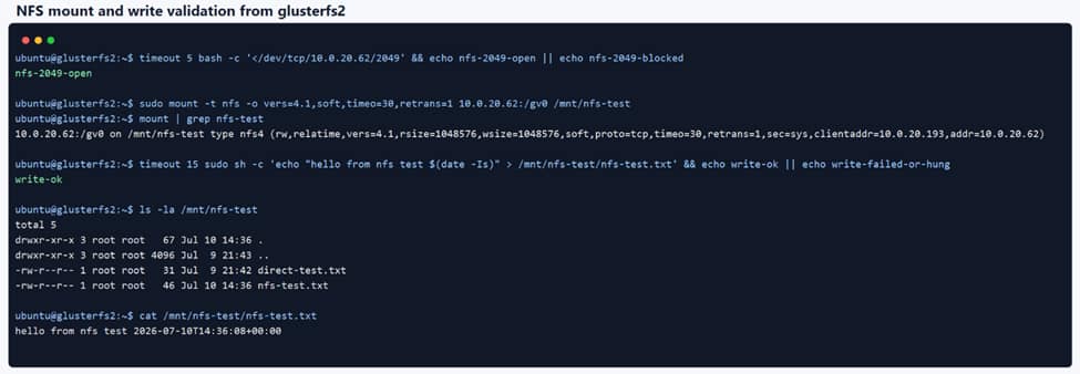

# Run from a client VM, for example glusterfs2.
# Use the validated NFS-Ganesha pseudo path. In the blog this was /gv0.
sudo apt-get install -y nfs-common
sudo mkdir -p /mnt/nfs-test
sudo mount -t nfs -o vers=4.1 glusterfs1:/gv0 /mnt/nfs-test
echo "hello from nfs test" | sudo tee /mnt/nfs-test/nfs-test.txt
ls -la /mnt/nfs-test
sudo umount /mnt/nfs-test
In this configuration, the GlusterFS volume root (Path="/") is exported through NFS-Ganesha as the pseudo path (Pseudo="/gv0"), which was validated using a client mount test. Kubernetes mounts this export as a standard NFS share, while data storage and replication continue to be handled by GlusterFS.
NFS mount and write validation from glusterfs2

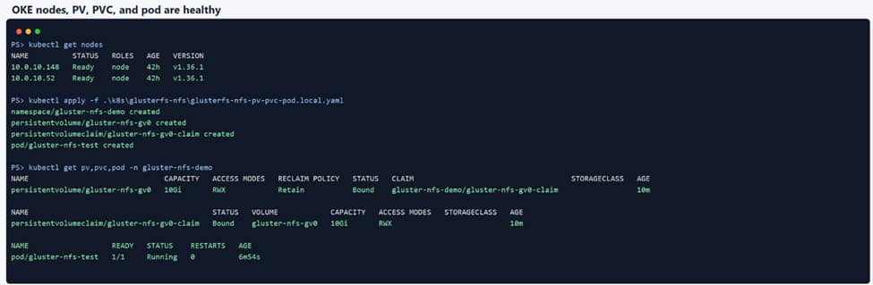

The PersistentVolume was bound to a PersistentVolumeClaim within the application namespace, and a validation pod mounted the volume under /mnt/gluster.
This configuration requires no GlusterFS-specific Kubernetes plugins because Kubernetes interacts only with the NFS export.
OKE nodes, PV, PVC, and pod are healthy
Validation
After deployment, the PersistentVolume, PersistentVolumeClaim, and validation pod all reached the expected state.
persistentvolume/gluster-nfs-gv0              Bound
persistentvolumeclaim/gluster-nfs-gv0-claim   Bound
pod/gluster-nfs-test                          Running

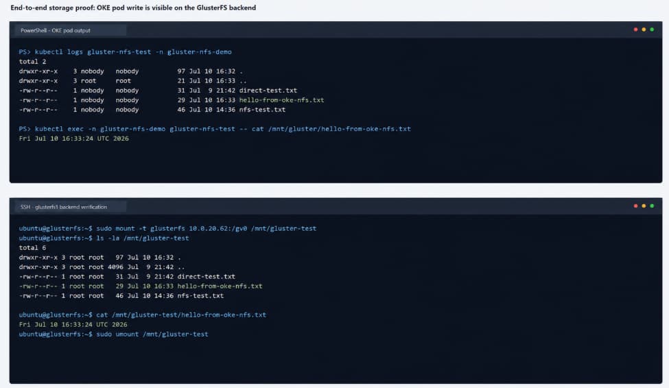

The pod successfully created a test file inside the shared volume.
hello-from-oke-nfs.txt
Fri Jul 10 16:33:24 UTC 2026
To verify end-to-end storage integrity, the same GlusterFS volume was mounted directly on the storage server.
# Native GlusterFS validation from glusterfs1.
# This is not an NFS mount.
sudo mkdir -p /mnt/gluster-test
sudo mount -t glusterfs glusterfs1:/gv0 /mnt/gluster-test
cat /mnt/gluster-test/hello-from-oke-nfs.txt
sudo umount /mnt/gluster-test
The file written by Kubernetes was immediately visible through the native GlusterFS mount, confirming the complete storage path.
End to end storage proof
This validated that applications running on OKE can successfully consume shared RWX storage backed by GlusterFS.
