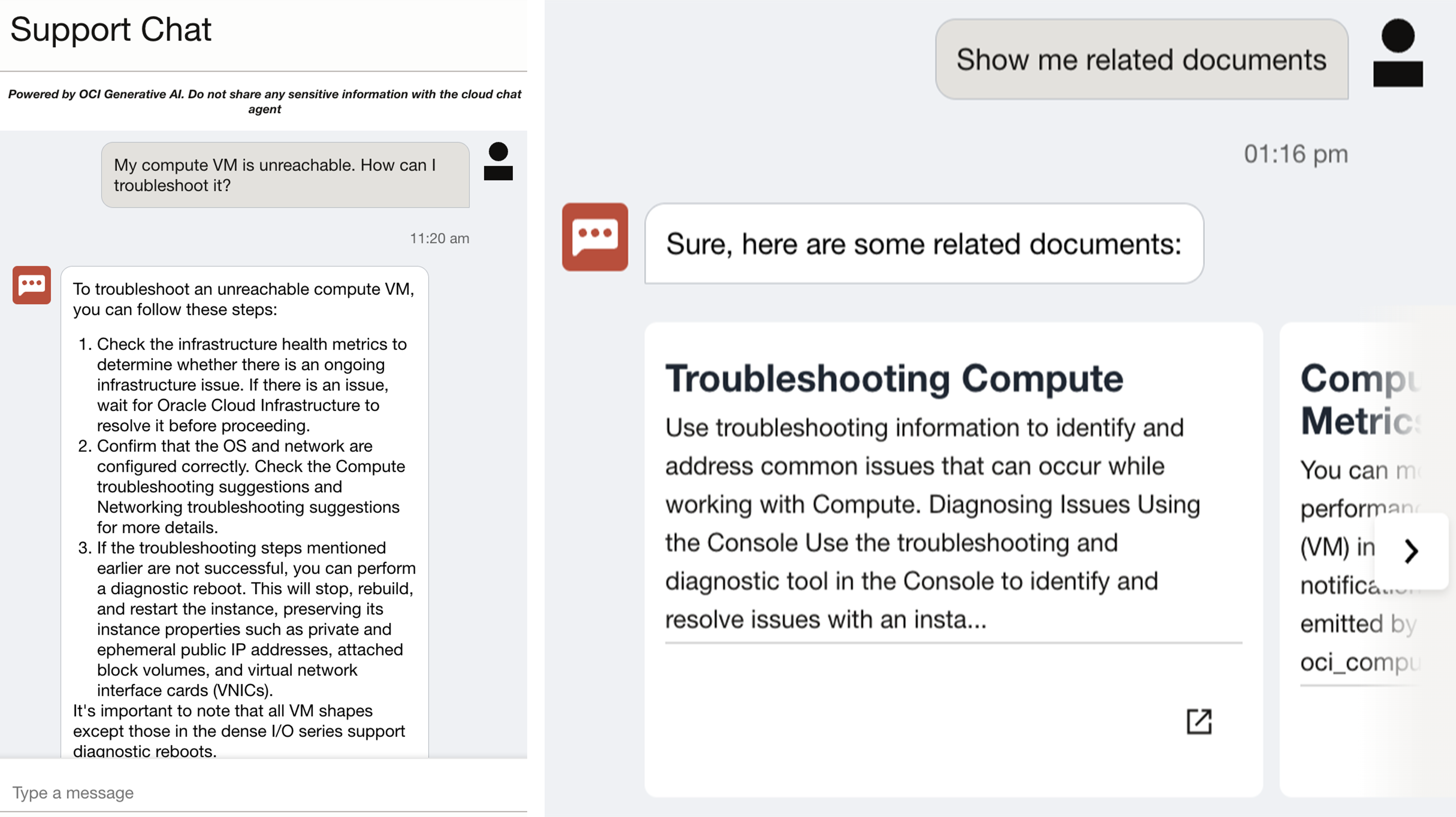

At OCI, we launched AI-based Oracle Support Digital Assistant, which can conduct human-like conversation with customers to address their technical support problems. It helps users find what they’re looking for faster, summarizing multiple documents into a simplified response relevant for the customer and reducing the need to create and handle tickets.
In the following screenshot, Support Digital Assistant gets the following user request: “My compute VM is unreachable. How can I troubleshoot it?” The digital assistant then provides a list of steps for the customer to follow.
Example use case chat interface
Figure 2: OCI support use case example chat interface
The related documents are linked for the customer to examine.
Example related documents.
Figure 3: OCI example use case related documents

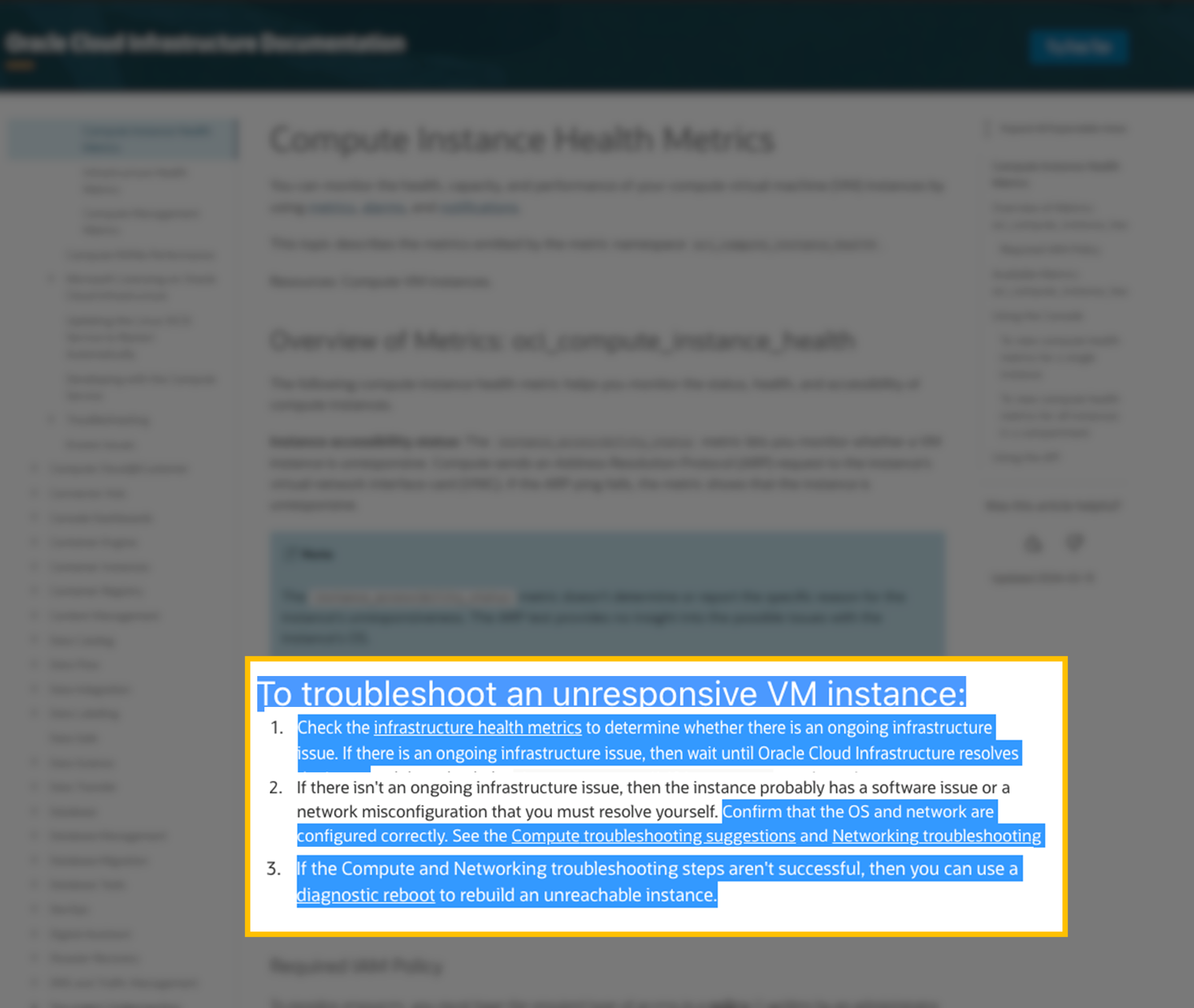

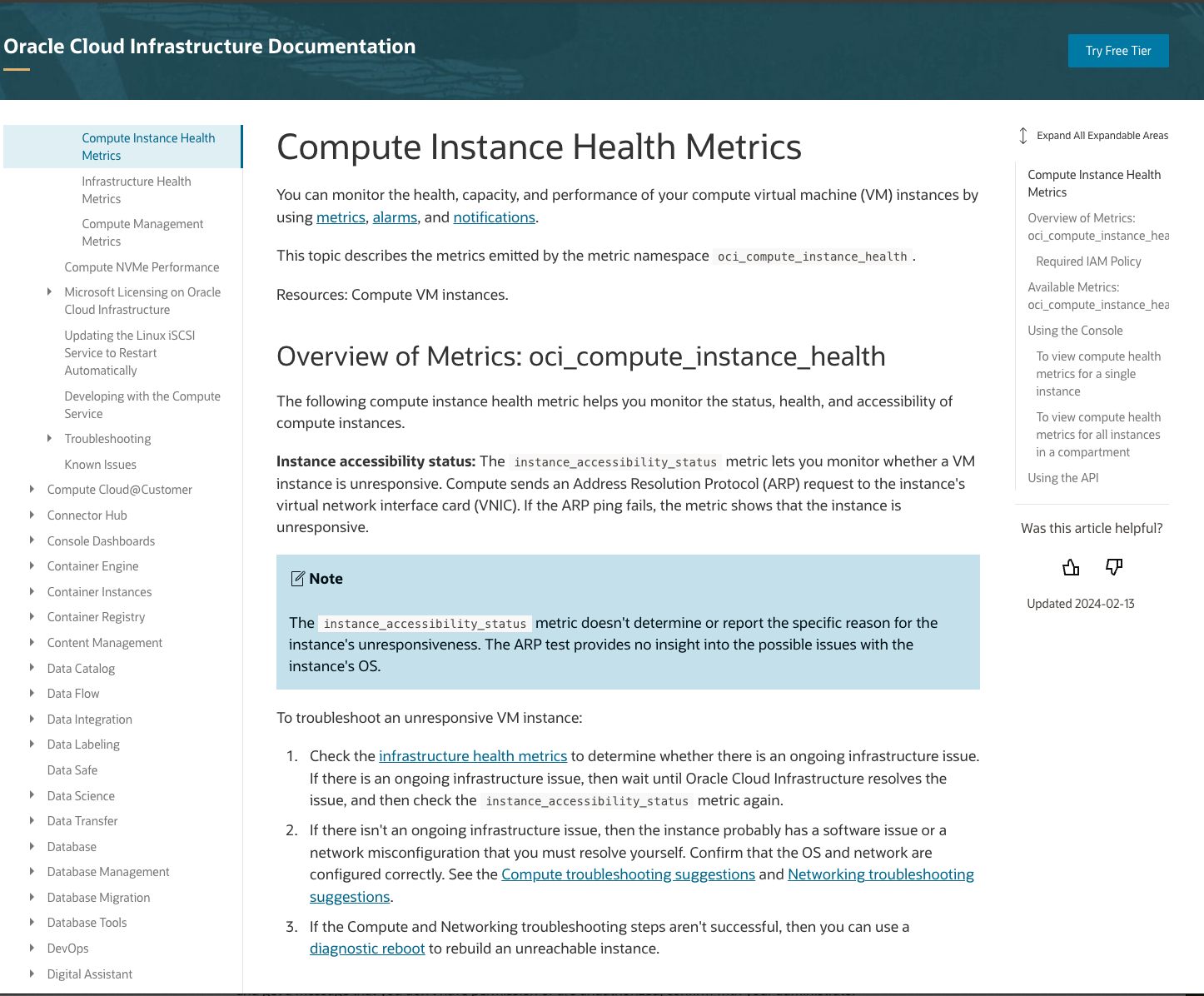

Behind the scenes, the RAG system pulls relevant contents from a repository of OCI public documentations.
A highlighted relevant content snippet.
Figure 4: Relevant content snippet

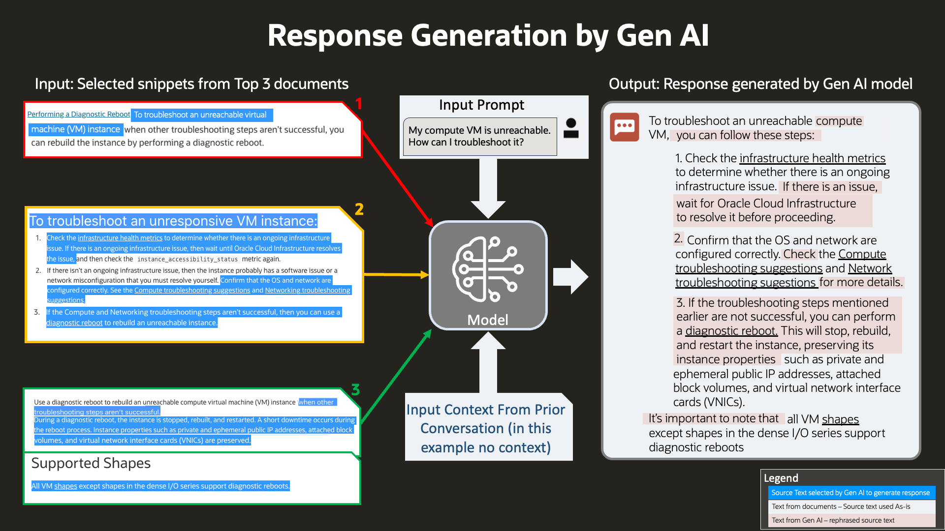

Together with the input query, those content snippets and context from previous conversation are fed into the LLM to generate meaningful response to present to the user.
Response generation by GenAI taking selected snippets from the top three documents for the generated response by the model.
Figure 5: Response generation
You can see that the system excels at consuming long documents, condensing the information, and generating summarized responses tailored to the customer’s specific questions. This intelligent summarization saves potentially significant time and effort for the OCI Customer Support team, as well as for the end customers. In coming sections of this blog, we will also dive deep into technical details for this use case, such as how multi-turn is achieved.

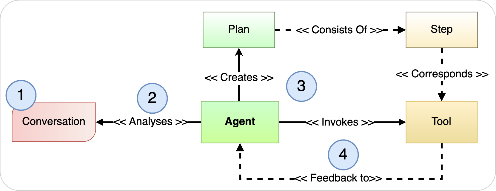

What is an agent?
An LLM-powered agent is a system that uses an LLM to work through a problem, create a plan to solve the problem, and run the plan with the help of a set of tools. This process allows agents to follow complex instructions and perform various activities in response to simple and concise commands received from users. RAG is one type of agent that involves fetching data from connected knowledge bases.
The following agent high-level workflow shows the steps of a generic agent:
  1. You provide simple instructions in natural language.
  2. The LLM-powered agent analyzes the conversation to create a plan that consists of steps.
  3. The LLM-powered agent finds which tool to use for each step and how to use it.
  4. Results from each step are fed back to the agent to either replan, continue the process, generate the response, or request customer input.
A workflow diagram for a generic agent process.
Figure 6: Agent paradigm overview

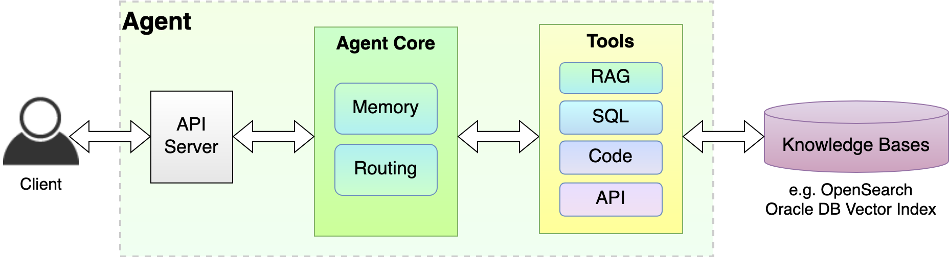

To achieve these tenets and design principles, we broke down the service into the following building blocks that are extensible and pluggable:
  • Agent core: The “brain” of our LLM agent is responsible for generating concepts, creating plans, choosing which course to take, parsing responses, and ultimately generating the final response back to the user.
  • Memory: Think of this as our agent’s personal diary, but way cooler! It’s a storage system for chat histories, thoughts and plans, and the outcomes of actions.
  • Knowledge base: Our secret stash of knowledge! These are external, private sources of information where our LLMs go to enhance their responses with more and better data tailored to our use case. This data source is often used to ground the model.
  • Tools: These are like our agent’s superpowers! They’re extra functionalities that enhance the agent’s capabilities, allowing it to perform tasks beyond standard text generation, such as function calls for real-time information, running Python code, or accessing specific databases for up-to-date or specialized information.
Work flow for the GenAI Agents architecture.
Figure 7: Agent service high-level architecture

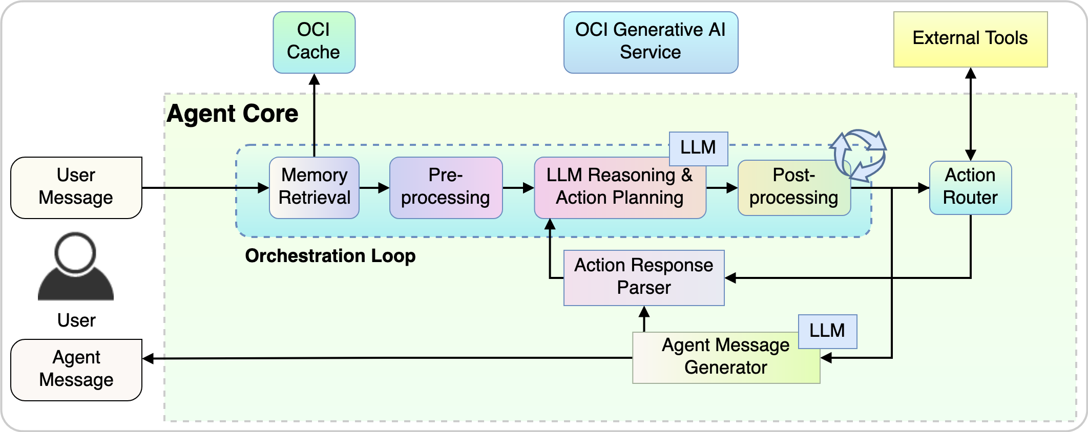

Agent core internals
Agent core is the “brain” of this machinery. It must be highly customizable to accommodate various agent types. Here, the engineers and scientists collaborate closely to iterate the design and learn from each other. The engineers focus on system extensibility, scalability, observability, and latency, and the scientists focus on model choices, addressing long-tail business scenarios, model-level and end-to-end accuracy.
The following figure demonstrates how the agent core works internally:
  1. The orchestration loop is a continuous cycle where an agent observes its environment, decides on an action based on its observations and internal logic, performs the action, and then updates its understanding based on the outcome of the action and any new observations.
  2. The action router decides the process path and routes the request to corresponding component based on the action plan from the previous step.
  3. The action response parser parses the response from the action and feeds the information into the agent core for it to prepare for next iteration.
  4. The agent message generator creates the response back to the user and completes the current conversation turn.
Workflow diagram of the internal agent core process.
Figure 8: Agent core internal process

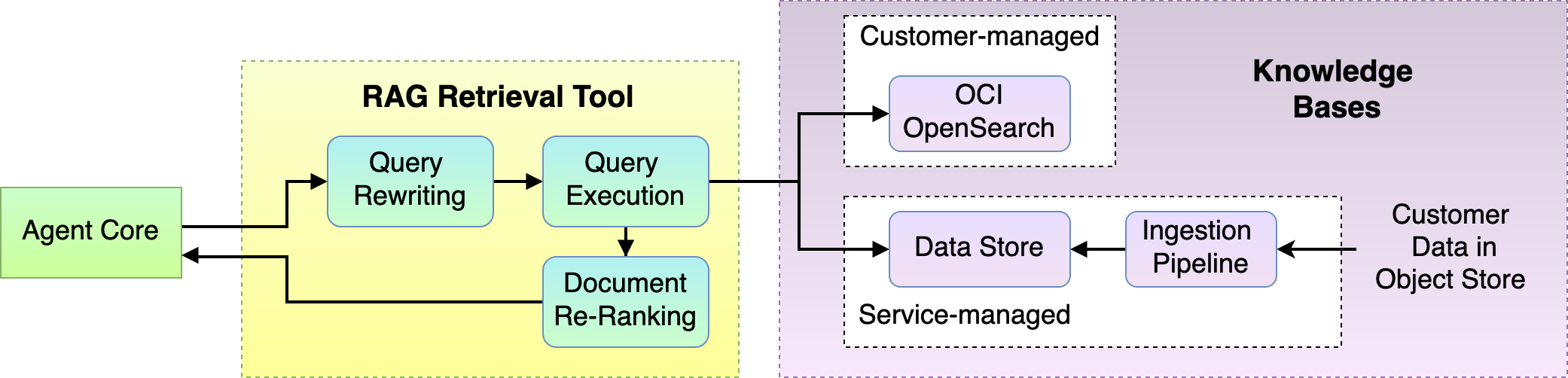

RAG retrieval tool Internals
A RAG agent’s agent core typically plans zero or multiple retrieval steps, optional tool processes, and a final generation step. The RAG retrieval tool is responsible for retrieving the relevant information from various data sources and serving it up for our RAG agent to work on. A generation LLM later uses this information to generate response to the user query.
We realized that RAG retrieval is the most critical portion to boost performance in terms of correctly answering a customer’s question. Knowledge retrieval isn’t a new problem; it has been well-studied and solved in the search engine field.
So, we borrowed the following key techniques from traditional search engines and applied them in our RAG Retrieval Tool:
  • Query Rewriting: It takes the user’s query and converts it to make it just right for search. For example, reformatting and optimizing the user input query for OpenSearch search. Now, the queries are ready for the search showdown!
  • Query Execution: Our RAG retrieval tool sends the prepared query to one or multiple knowledge bases to retrieve top-N relevant documents. It’s like sending out our search squad on a mission to find what it needs.
  • Document reranking: After our search squad comes back with their findings, it’s time to polish the search results, ensuring that they’re sorted according to some complementary criteria.
  • Knowledge bases: Customers can bring their own OCI with OpenSearch instance where all documents are already indexed and ready. They can also hook their data in an Object Storage bucket, which is automatically ingested into a service managed knowledge base.
A workflow diagram of the internal RAG retrieval tool process.
Figure 9: Internal RAG retrieval tool process

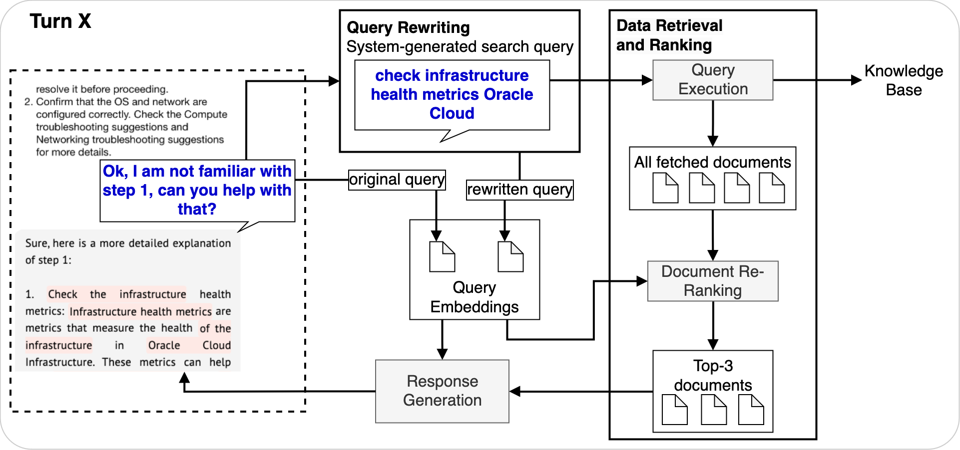

The following diagrams shows how Turn 2 in this example works inside the RAG agent:
  1. The original user query is written to a system-generated search query, which is sent to knowledge base to retrieve relevant documents. The query rewriting step incorporates awareness of preceding conversations into the search term.
  2. The retrieved documents are reranked, taking inputs of both the embeddings of those documents, the embeddings of user query, and the rewritten query.
  3. After reranking, the top three documents and all the context information are fed into the response generation LLM.
The process for multiturn RAG retrieval and generation.
Figure 10: Multiturn RAG retrieval and generation

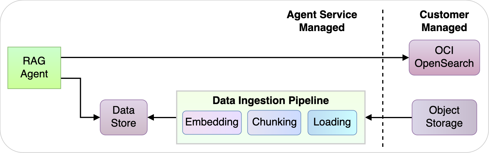

Data processing and protection
Using OCI with OpenSearch, our agent service indexes and stores unstructured data, providing swifter and more accurate retrieval capabilities. With OCI with OpenSearch’s granular access control, a customer has strong control over its data from a management perspective at both indexing and query time.
Customers have choices with their data. They can choose to link the RAG agent to their existing unstructured data in OCI with OpenSearch Cluster or in Object Storage. Their data will be processed in isolated workloads, and the service only retrieves data based on queries and context during a real-time conversation.
Workflow digram of RAG agent data ingestion and retrieval.
Figure 11: RAG agent data ingestion and retrieval

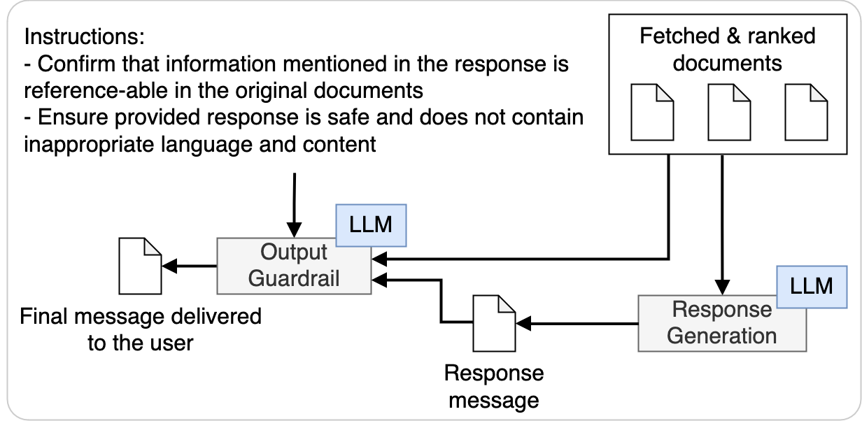

Model accuracy
No LLM will ever have full accuracy.  However, to promote enterprise adoption, improved accuracy can be achieved through a variety of techniques, including RAG.  Our GenAI RAG agent implements data-grounded generation to help reduce hallucinations. We also included an output guardrail to help with the following validations:
  • Takes the input of the user query, the retrieved supporting contents, the generated response
  • Produces scores to indicate the quality of the generated response in multiple dimensions, such as helpfulness, groundedness, and accuracy.
Validation process for RAG agent output.
Figure 12: RAG agent output validation

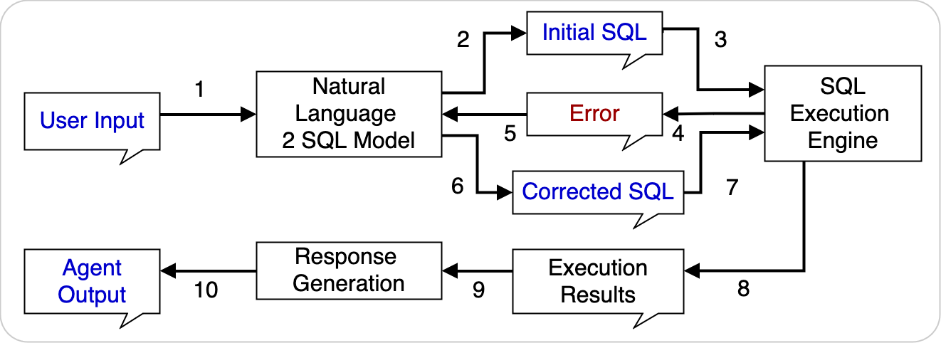

The GenAI Agent framework can also use tools to provide transparent ways to course-correct the behavior, leading to even more seamless interactions.
The following example shows an agent with SQL functionalities, including SQL generation, correction, SQL execution, and response generation.
The setup of an agent with SQL functionality.
Figure 13: Agent with SQL functionalities

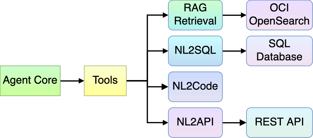

The first extensibility point is tools. We can use more types of tools to achieve various business goals.
Extending tools from the agent core.
Figure 14: Agent extension — Tools

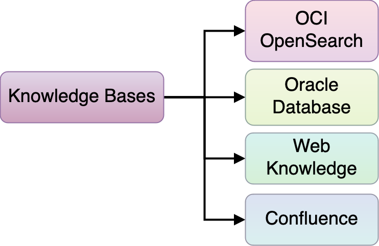

The second extensibility point is knowledge bases. RAG capabilities can be improved with more and better knowledge bases, including from unstructured, semistructured, and structured data to multimodality data. You can use various indexing and retrieval techniques, such as hybrid search, combining the benefits of keyword and semantic search, and various embedding models.
Expanding knowledge bases.
Figure 15: Agent extension — Knowledge bases
