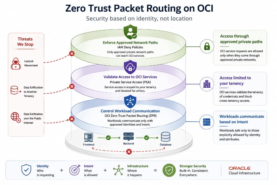

This is where Oracle Cloud Infrastructure Private Service Access (PSA) and IAM deny policies come in. Both are part of the recent OCI ZPR release and are designed to work alongside OCI ZPR as a cohesive set of controls, each operating at a different layer. PSA is designed to validate credentials used to interact with OCI services such as Object Storage at the service endpoint, helping prevent credentials issued in one tenancy from being used to access resources in another tenancy. IAM deny policies let you require that requests to OCI services arrive only through an approved private network path. Without that path, the request is denied, even if the credential itself is valid and would otherwise have permission. This helps address a common risk scenario in which a stolen or leaked API key could otherwise be used from outside an approved network path.
When these three controls are used together and configured as described, customers can strengthen their security posture at multiple levels simultaneously: workload communication governed by declared intent, service traffic constrained to the correct tenancy, and API access tied to an approved network path. The scenarios below walk through each control in a concrete situation, with the policy configuration and expected behavior for each.

Putting It Together
OCI ZPR, PSA, and IAM deny policies each operate at a different layer: workload communication, service endpoint, and request path, respectively. Used together and configured as described, they help make network position alone, a valid credential alone, or access to the right endpoint alone insufficient. Each scenario requires a different combination of conditions to be satisfied simultaneously.
All three controls can produce entries in Oracle Cloud Infrastructure Audit logs. OCI ZPR security attributes are assigned through the Oracle Cloud Console, OCI CLI, or Terraform. PSA and IAM deny policies can be scoped to specific services and rolled out incrementally, starting with the most sensitive workloads.
