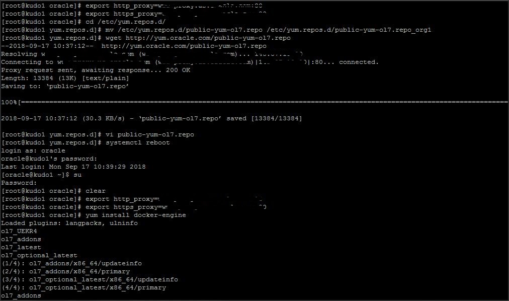

Below are the steps to install docker using Oracle YUM repository:
Step 1. Set your proxy :
Command : export http_proxy=xxx.xxx.xxx.xxx:80
Command : export https_proxy=xxx.xxx.xxx.xxx:80
Step 2. Take a backup of existing public-yum-ol7.repo :
Command : cd /etc/yum.repos.d/
Optional Command : mv /etc/yum.repos.d/public-yum-ol7.repo /etc/yum.repos.d/public-yum-ol7.repo_org1
Step 3. Download the latest public-yum-ol7.repo from Oracle YUM repository:
Command : wget http://yum.oracle.com/public-yum-ol7.repo
Step 4. Make the following changes in your public-yum-ol7.repo file:
Command : vi public-yum-ol7.repo

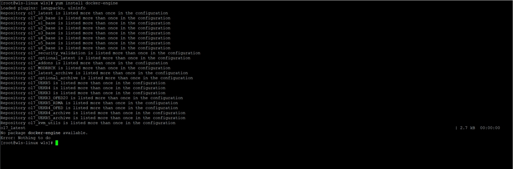

Step 6. Install docker using Oracle yum repository:
Command :  yum install docker-engine

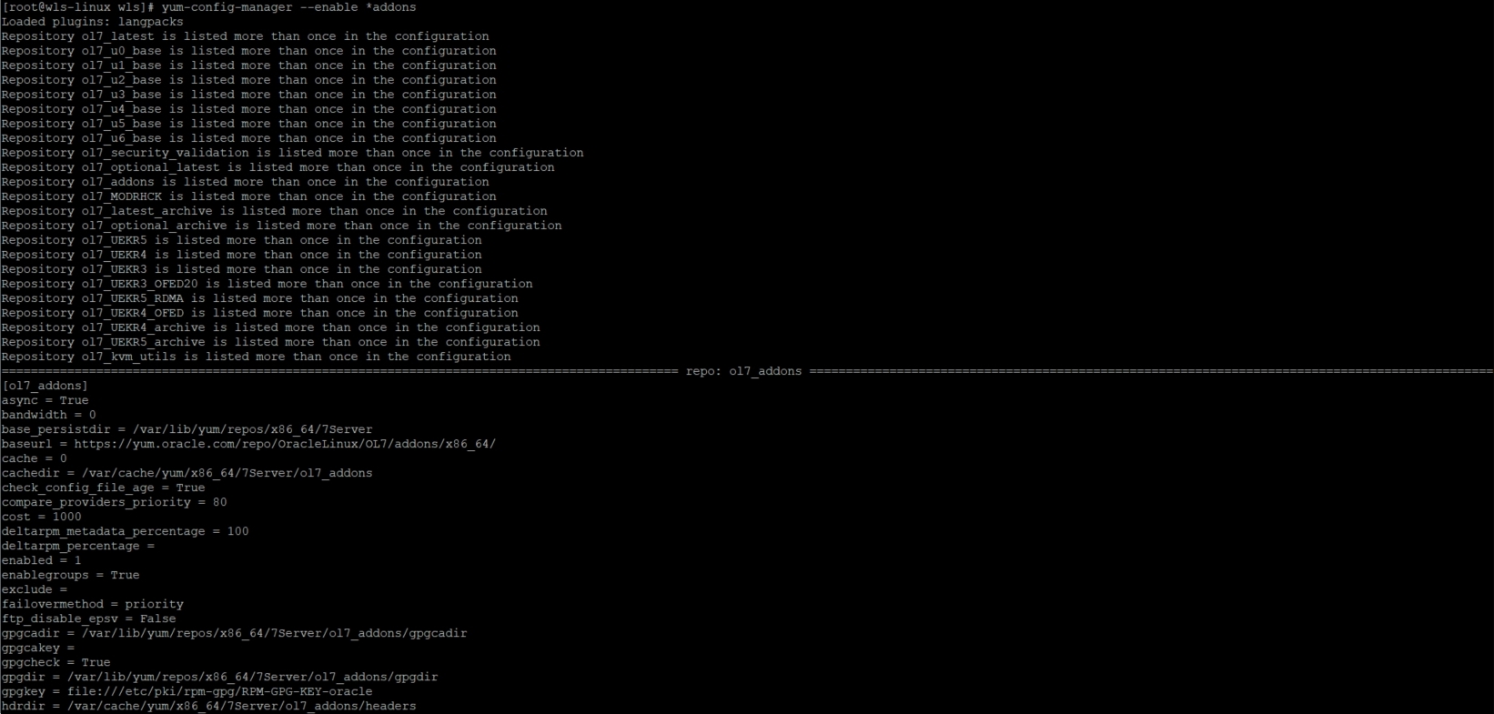

Some users have reported that they see the error “no package docker-engine available” at this stage :
Follow the below commands to resolve this issue :

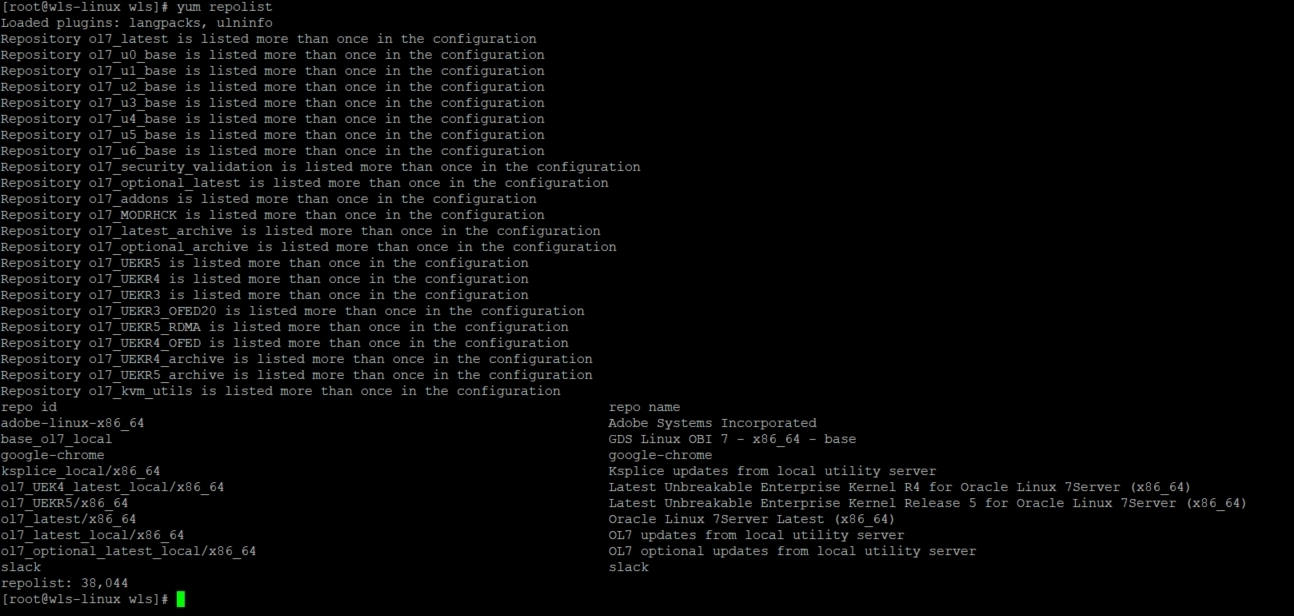

a) Check if the addons repository is enabled.
Command : yum repolist
b) If the addons repository is not enabled then execute the below command :
Command : yum-config-manager –enable *addons

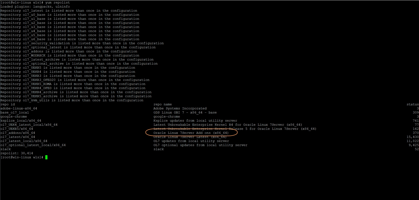

c) Now check if the addons repository is enabled using the command “yum repolist“.
d) Try to download/install docker from yum repository again, using the command “yum install docker-engine“.

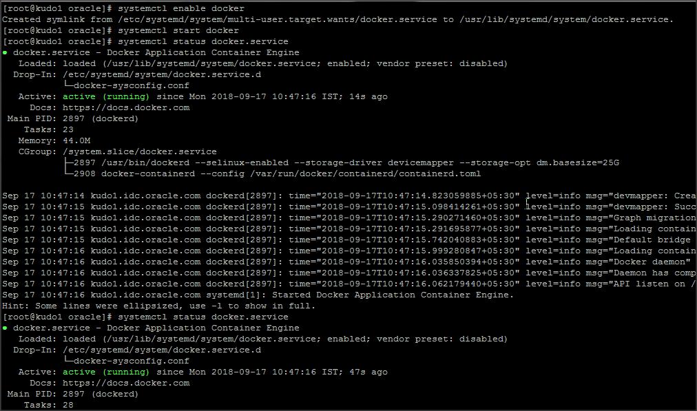

Step 7. Enable docker service:
Command : systemctl enable docker
Step 8. Start docker service:
Command : systemctl start docker
Step 9. Check the status:
Command : systemctl status docker.service
