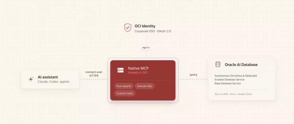

Architecture Overview
The architecture is clean and fully managed:
Figure 1: The MCP Server connects AI agents to Oracle AI Database running in OCI using HTTPS and OCI identity controls.
The MCP server runs as a managed OCI service with Streamable HTTP transport. Authentication is handled by an OCI Identity Domain using OAuth 2.0 with PKCE (authorization code flow). The MCP server connects to the database via a standard Database Tools Connection backed by an OCI Vault for credential storage.
