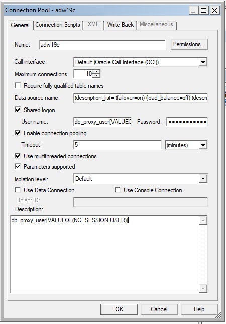

  1. Now you’re ready to set up the metadata repository (RPD). This method of passing the session variable allows the Oracle Analytics session user to be passed to the database proxy user as part of the database login.
    From the Physical panel, Select the Database, Double-Click on the Connection Pool and under Shared logon:  User name, include the session variable as an argument of the VALUEOF function and enclose the NQ_SESSION.USER portion in paranthesis and the VALUEOF session variable name in square brackets:
    proxy_user_name[VALUEOF(NQ_SESSION.USER)]
    In our example, Oracle Analyics will automatically pass user as: db_proxy_user[jchen] or db_proxy_user[ngreene] depending on the Oracle Analytics login session user.
  2. Be sure to UNCHECK the Require fully qualified table names box and click OK.
    Connection Pool in RPD

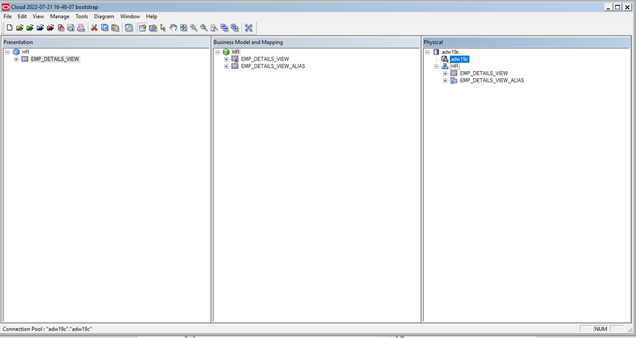

  3. In the Physical panel, select the hr.emp_details_view, Right-click and create an alias called emp_details_view_alias.
  4. Create the join between the two objects on employee_id.
  5. Drag HR to the Business Modeling and Mapping panel.
  6. Drag HR from the Business Modeling and Mapping panel to the Presentation panel.
  7. Remove the employee_details_view_alias from the Presentation layer.
    The metadata repository looks like this in our example:
    RPD Configuration
  8. Save and deploy the metadata repository to an Oracle Analytics instance where you want to test this functionality.

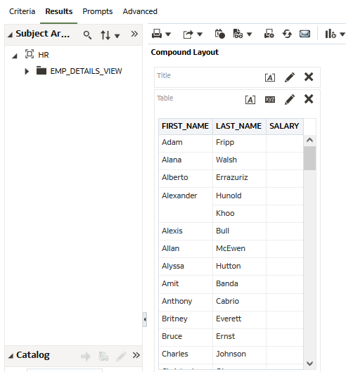

  9. Test creating a report with a user that has privileges to all HR data (for example, the ngreenbe user) and a user that is restricted (for example, the jchan user).
    The report will be the same for all users. If a user without permission runs the report that has a column that they don’t have access to, the data is displayed blank in our example:
analysis_report_blank_column

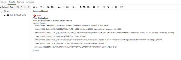

If the proxy user definition is incorrect, an invalid username and password error message will appear similar to this one:
proxy_user_error
