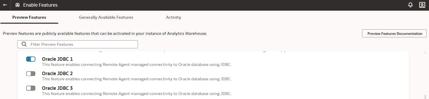

2. Enable the Oracle JDBC Preview Feature
In FDI, open Application Administration, then select Enable Features. Under Preview Features, search for Oracle JDBC and enable the connector you plan to use, such as Oracle JDBC 1.
Figure 1: Oracle JDBC 1 is enabled as a preview feature so it can be used as a data extraction connection.
The Oracle JDBC preview connector is the managed FDI connection type used later to define the source database connection. If the feature is not enabled, the connector will not appear when you create the extraction connection.

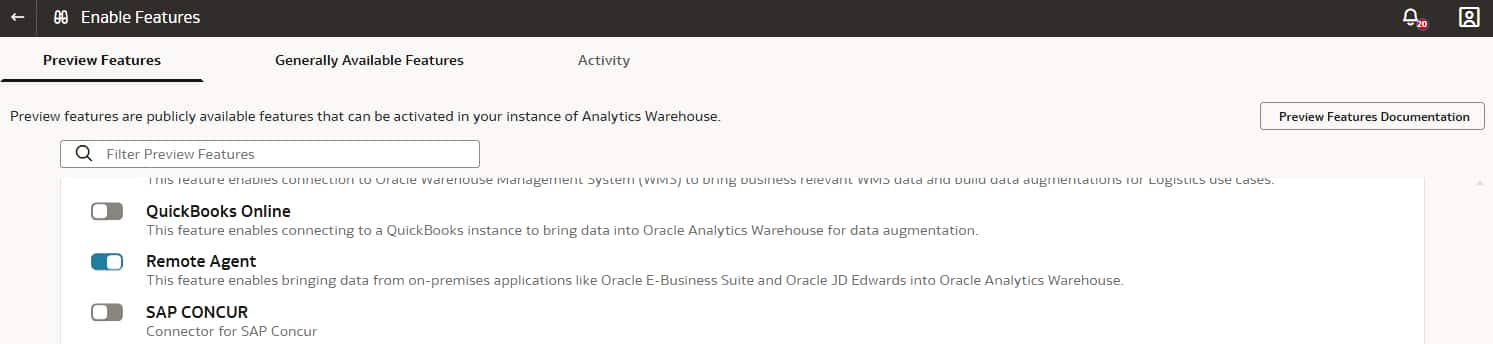

3. Enable the Remote Agent Preview Feature
In the same Preview Features page, search for Remote Agent and enable it.
Figure 2: The Remote Agent feature is enabled so FDI can communicate with a source reachable from the agent network.
The Remote Agent is the bridge between FDI and the private database network. For a private Oracle Autonomous AI Database, install or place the agent where it can resolve and reach the database endpoint on the required port, typically TCPS on 1522 for Oracle Autonomous AI Database connections.

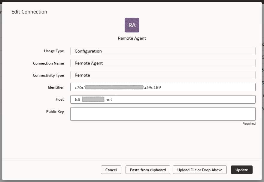

4. Configure the Remote Agent Connection
After the feature is enabled, configure the Remote Agent connection in Manage Connections. The configuration includes the agent identifier, host, and public key. Use values generated or assigned for your environment rather than copying values from a screenshot.
Figure 3: Remote Agent configuration captures the identifier, host, and public key used by FDI to recognize the agent.
At this stage, focus on establishing trust between FDI and the Remote Agent. If the public key or agent host is incorrect, the later JDBC connection test will fail even if the database URL and credentials are valid.

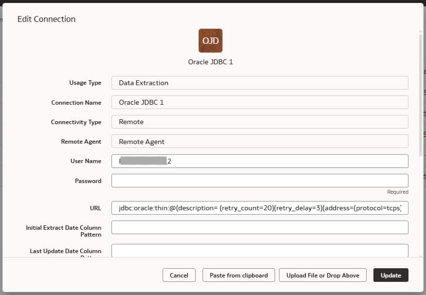

6. Create the Oracle JDBC Data Extraction Connection
Next, create or edit the Oracle JDBC 1 connection. Set the usage type to Data Extraction, choose Remote as the connectivity type, and select the Remote Agent you validated in the previous step.
Provide the source database user, password, and JDBC URL. Update the rest of the fields as per your requirement.
Figure 4: Oracle JDBC 1 is configured as a data extraction connection that uses the Remote Agent.
For data augmentation, use a database account with the minimum required privileges to read the source objects. The account should be able to list and query the source tables you want to augment into FDI.

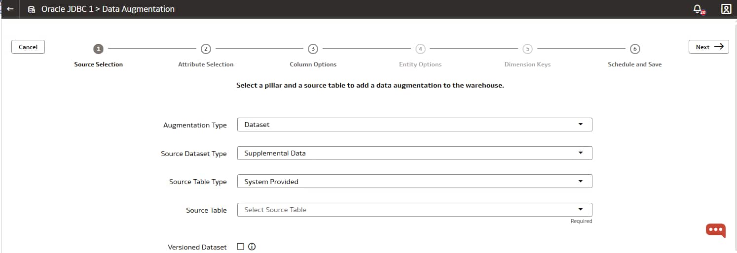

10. Create the Data Augmentation
Open the data augmentation workflow for the Oracle JDBC source. In the first step, select the augmentation type, source dataset type, source table type, and source table. Follow the steps to create Data Augmentation(s).
Figure 5: The Data Augmentation wizard starts with source selection before moving through attributes, column options, entity options, keys, and schedule.
