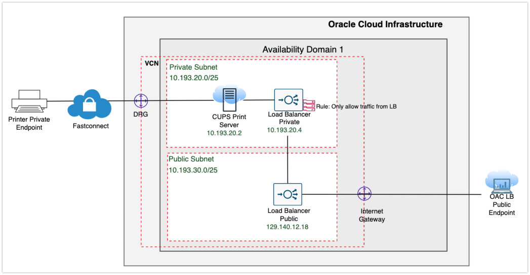

- Oracle Analytics Cloud (OAC) with Private end point is configured and running.
- Private and Public Load Balancers are configured and running.
- Routing tables and Security List rules are updated correctly.
- Private printer configured and running from a CUPS server

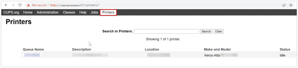

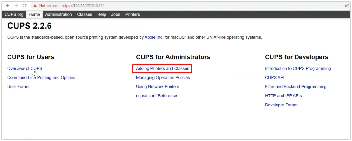

Once CUPS server is configured, you should be able to access it via https://hostip:port

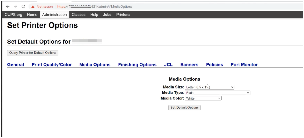

You can also set the options for the printer from Administration tab
Once the printer is added to CUPS you should be able to view it from Printers tab

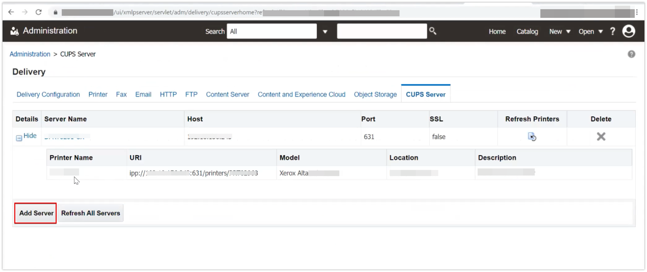

Next step is to add CUPS server at Oracle Analytics side:
To add a CUPS server:
- From the Administration page, select CUPS to display the list of servers that have been added.
- Select Add Server.
- Enter the Server Name and Host and Port for the CUPS server.

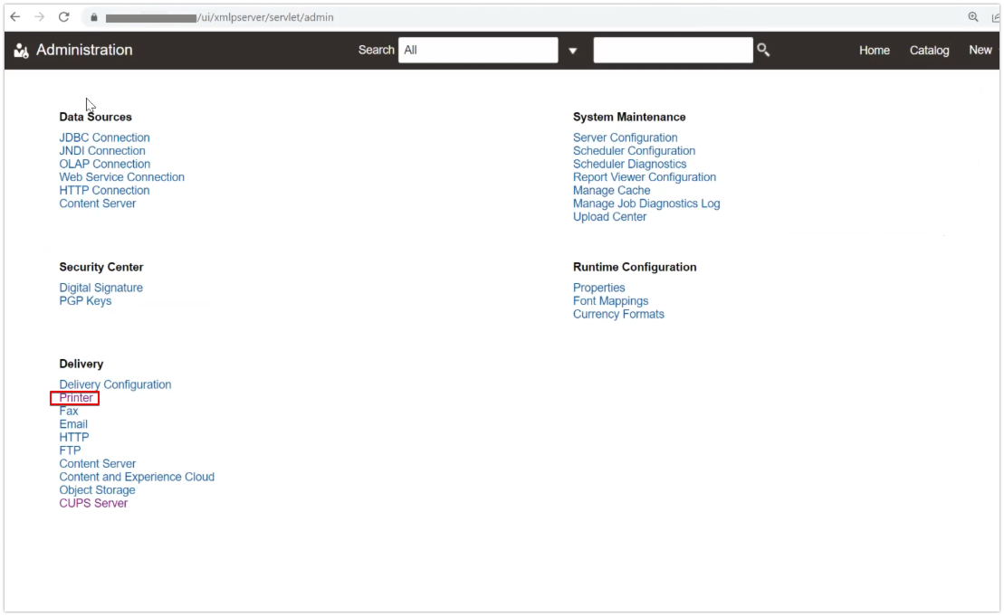

Once your CUPS printer is set up, complete the following:
Log into the Oracle Analytics Publisher console.
- Click Sign In.
- Click Administration.
- Click the Printer tab.
- Click Add Server.

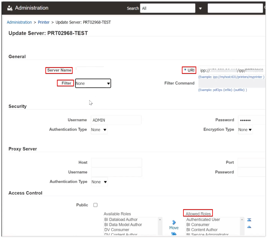

For a CUPS or direct IPP printer:
- Enter the Server Name. You will need to enter this into Transportation and Global Trade Management Cloud later, so make note of it.
- Enter the URI for your server. For CUPS the form is ipp://<CUPS host>:631/printers/<printer name>.
IPP uses the TCP port 631 for printing, so any firewalls between the client and the server must be configured to allow bi-directional traffic on that port. Please consult your network administrator if you think any configuration changes are necessary.
- Check with your system administrator for any Filter requirements.
- It is required to use SSL Encryption. Select SSL for the Encryption Type in the Security section.
- It is also required to protect the Printer/Print Server using User Authentication. Please enter the corresponding details in the Username, Password, and Authentication Type fields. The Authentication Type must be Basic or Digest.
- Click Apply.

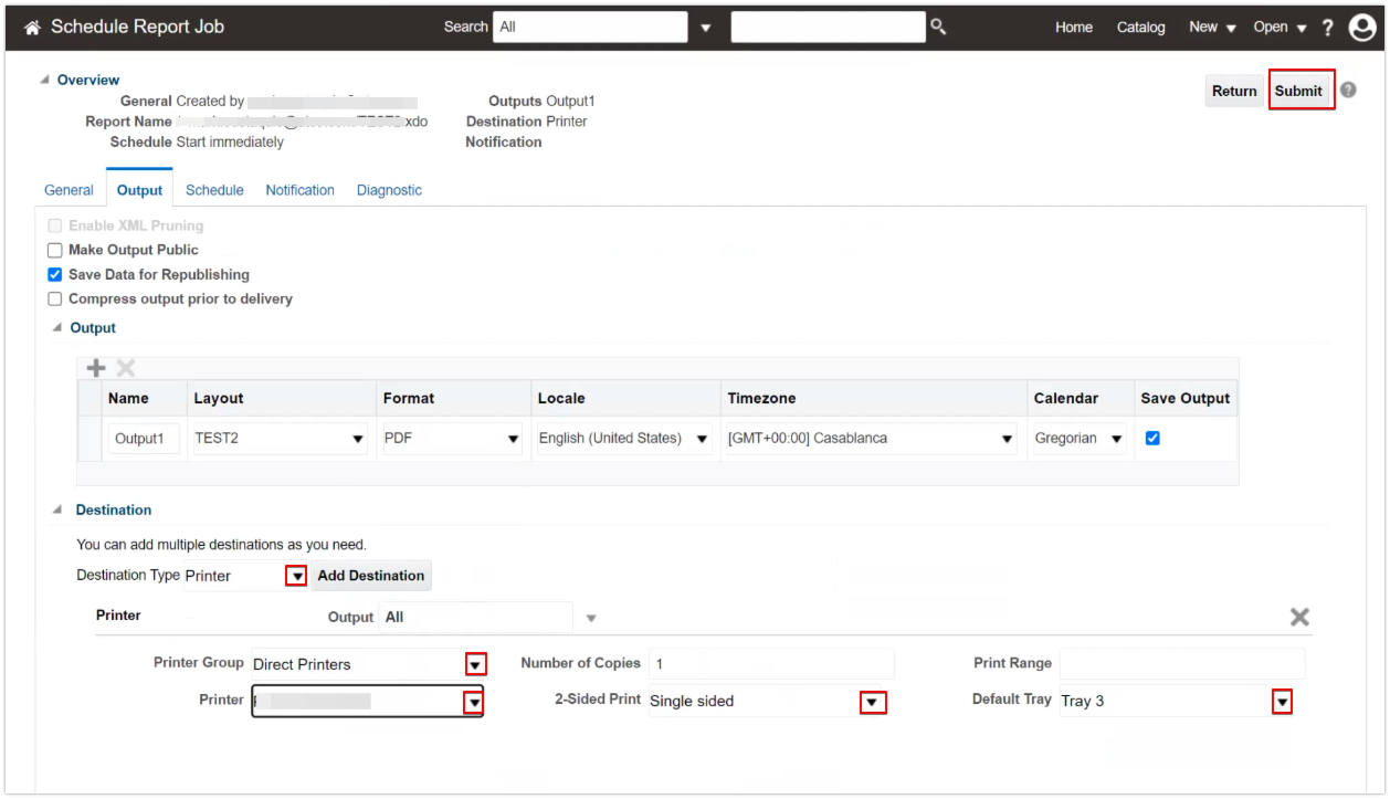

Schedule Report Job and submit it to test if the print operation is successful

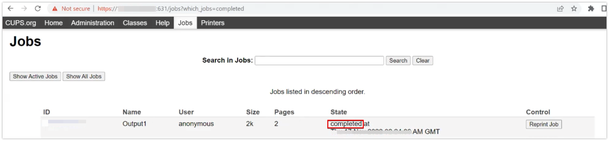

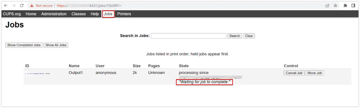

You can also monitor the print Job status from CUPS server
In few seconds, you should see a the state as completed

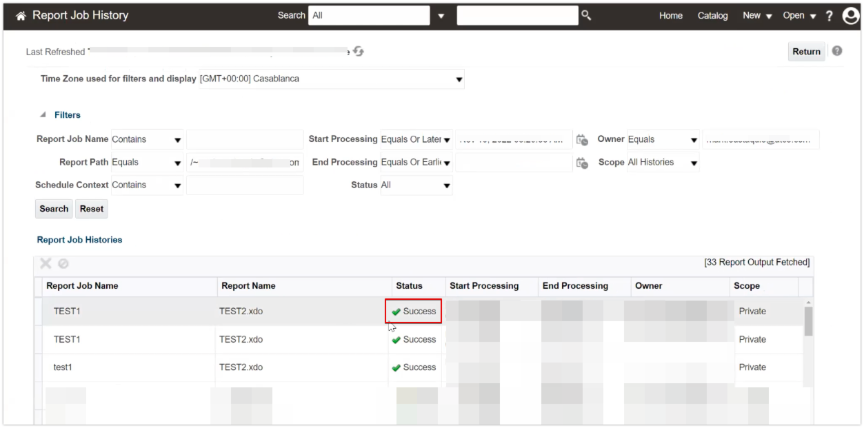

From the Publisher report Job History, you should also see Status as Success
