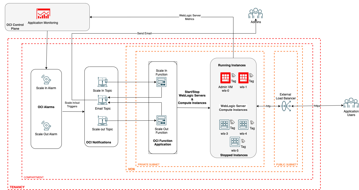

What is the alternative solution?
This article explores an alternative solution for the use cases highlighted above using the auto-scaling framework provided through Oracle WebLogic Server for OCI marketplace offering. Users can provision or scale the stack to the number of nodes necessary to support the maximum expected workload if they can predict the number of nodes required for higher workloads. For handling standard workloads, you can keep a sufficient number of nodes running while shutting down the extra nodes needed for high-load conditions. Since OCI compute instances provisioned in the stack are charged per OCPU per hour only while those run, users can stop the additional instances created for expected high-load conditions. When OCI scaling alarms are triggered, these additional instances can be restarted or shut down.
In the next few steps, you will be able to learn how to re-configure auto-scaling for your WebLogic Server for OCI stack to achieve the solution mentioned above.

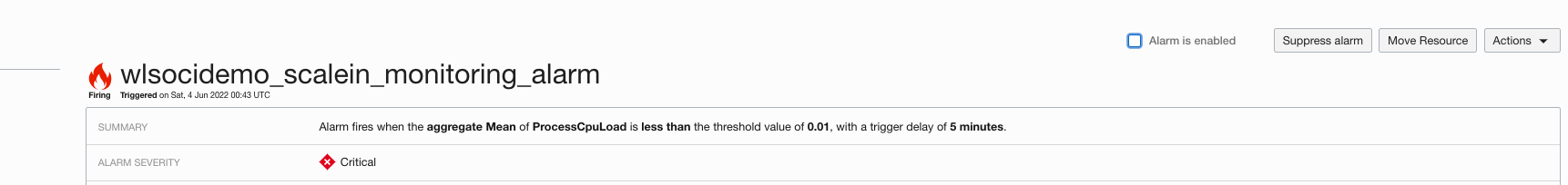

  1. Disabling Monitoring Alarms: To configure the auto-scaling feature, disable the monitoring alarms created during provisioning to avoid triggering scaling events. The alarms can be found in the OCI console under Observability & Management > Alarm Definitions.
    Disabling OCI Autoscaling Alarms

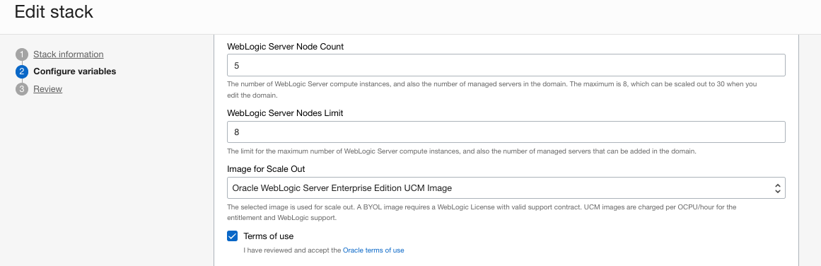

  2. Scale out for peak loads:  Now scale out the stack by adding new nodes to handle anticipated higher workloads. Since the stack created earlier is BYOL, it can be scaled out using either BYOL or UCM images by editing the stack and reapplying. Scale-out to 5 nodes using UCM images for the new nodes.
    Edit Oracle WebLogic For OCI Stack

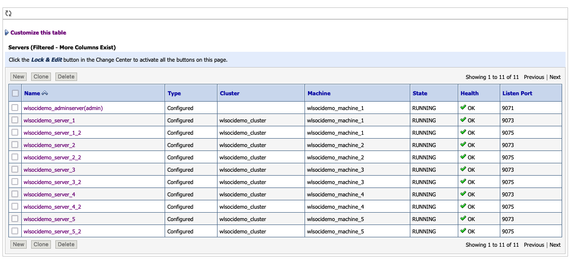

  3. Domain Customizations: Follow the steps below to customize your domain by creating an additional managed server per node in the existing stack created at the time of provisioning. Use the WebLogic console for configuration changes.
    1. Create an additional managed server with a 9075 listen port in the existing wlsocidemo_cluster cluster. Note that the Machine name should be as same as the one used by the existing server on that node.
      New WebLogic Managed Server

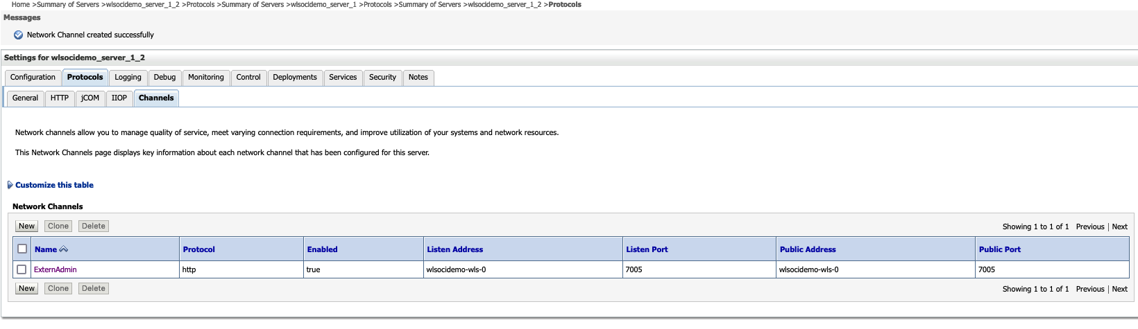

    2. Create http  channel ports under server_name > Protocols > Channels with 7005 as listen port.
      New Network Channel
    3. Ensure that all newly added managed servers are started.

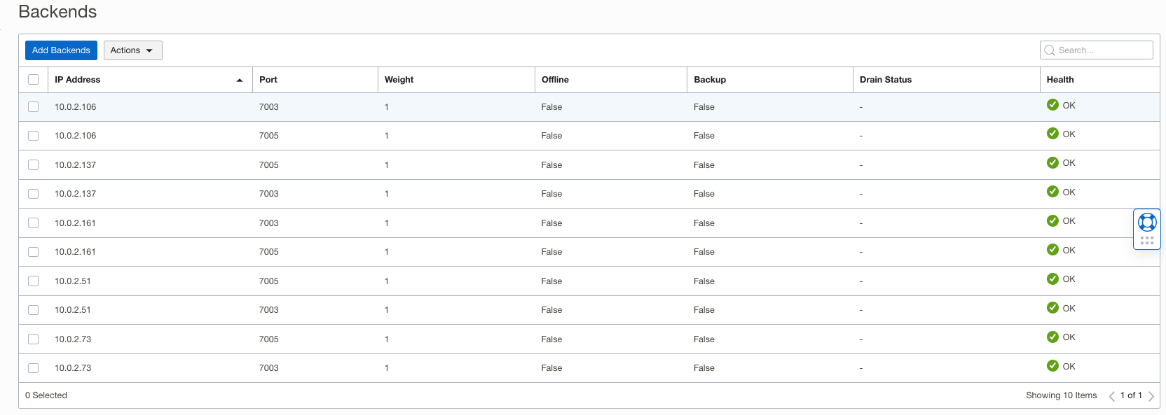

  4. Update Load Balancer Backends: Add the newly added managed servers to the existing Load Balancer Backend set created during the stack’s provisioning. The stack should have two backends per VM node for the two managed servers created in the earlier step.
    OCI Load balancer backends

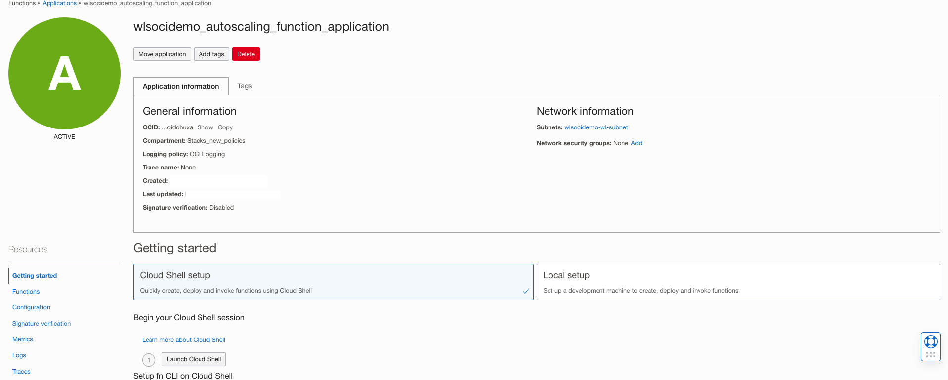

OCI Functions Application
Locate the OCI Functions application at Developer Services > Functions > Applications > wlsocidemo_autoscaling_function_application. Select the same compartment as the stack compartment. The OCI Functions application has three functions configured to support the out-of-box auto-scaling features. We will replace these functions with new scaling functions to start and stop managed servers based on metric-based alarms.

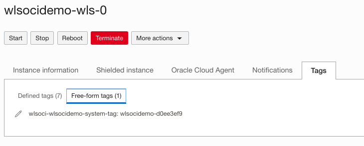

  • Stack Free Form Tag and Tag Value: Locate the compute instances created for the stack under Compute > Instances. Select the stack compartment. Each compute instance has a free-form tag generated by the stack, as shown below. Note the tag name and value.
    OCI compute instance free form tags

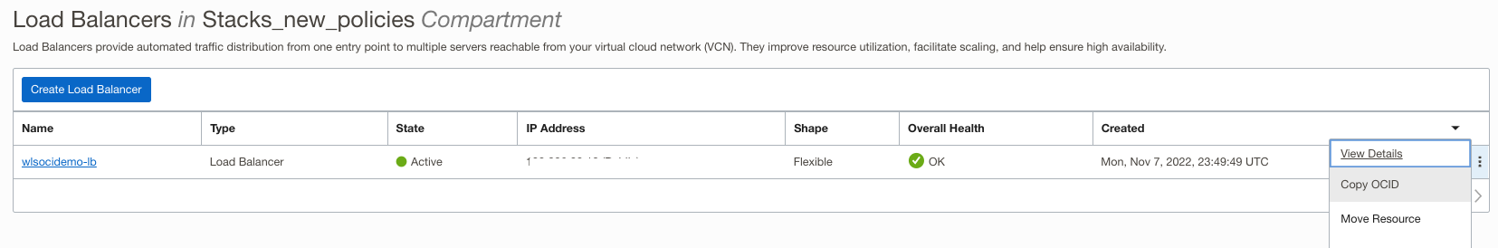

  • OCI Load Balancer Information: Locate the load balancer for the stack under Networking > Load Balancers. Select the start compartment to list the Load Balancer instance. Note the details listed below.
    • Load Balancer ID: The OCID value of the load balancer created by the stack.
      OCI Load balancer OCID

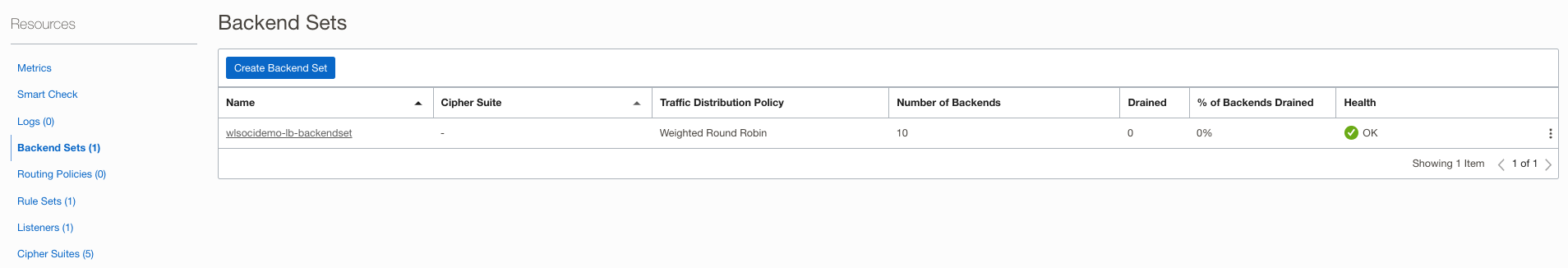

    • Load Balancer Backend Set Name: Name of the load balancer backend set created by the stack. It can be found in the Load Balancer configuration, as shown below.
      OCI Load balancer backend set

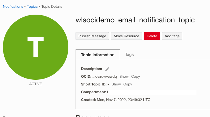

  • Email Notification Topic: The email notification topic for the stack can be found at Developer Services > Application Integrations > Notifications. Select the stack compartment to location notification topics. If scaling notifications are configured, the stack optionally creates the notification topic with the name  <stack_name>_email_notification_topic. Note the OCID of the email notification topic.
    OCI Email Notification Topic

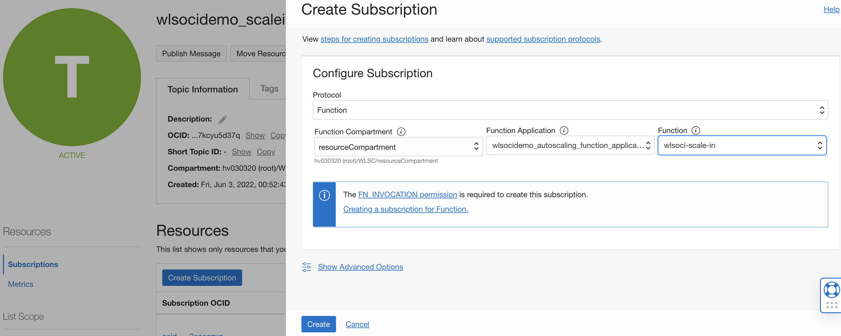

Create New Notification Topic Subscriptions
The notification topic to which monitoring alarms send notifications is using the existing functions in its subscriptions. You will create a new subscription for the above functions and remove the existing ones.
The scale-in and scale-out notification topics are under Developer Services> Application Integration > Notifications. The stack creates three notification topics for scale-out, scale-in, and, optionally, email notification. Add new subscriptions to scale in and scale out the topic, as shown below. Also, ensure that existing subscriptions are deleted so alarm events are not sent to original functions.
OCI Topic Subscription

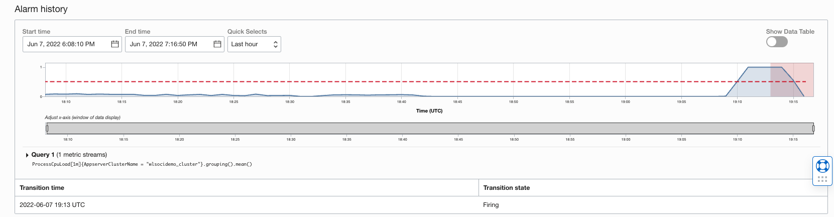

  • Verify that scale-out and scale-in alarms are triggered when the max and min thresholds are breached.
    Scale out OCI Alarm
