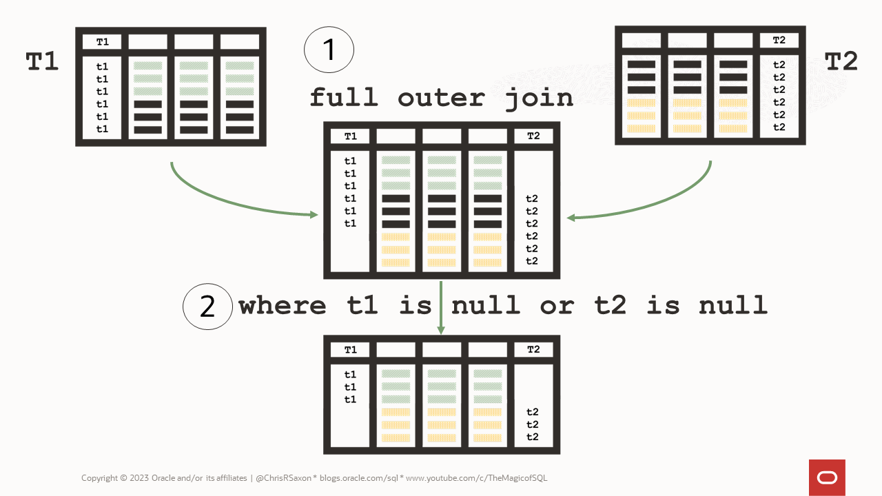

How to find different rows with full outer joins
Instead of using set operations, you can join the tables together on the columns you want to compare.
Comparing tables with joins. Query each table and add an expression adding the name of the table. Then full outer join the tables together. Finish by finding the rows where the table names added at the start are null for either table
The process is:
  • Query each table, adding an expression to each stating its source
  • Full outer joining these queries together
  • Filter the result to show the rows only in one table
To do this you need to list all the comparison columns in the join clause. If the tables have many columns this can be tedious.
Lukas Eder came up with a trick to simplify this: a natural full join! This generates the join clause from the common column names.
Which looks like:
In the query above:
  • The natural full join clause joins the tables, returning the matched and unmatched rows in each
  • The where clause returns only those rows with no match in the other; i.e. the differences
