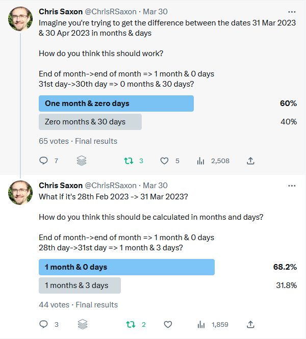

The key is you need to define what a “complete month” is. This a surprisingly hard problem; mindlessly copying code to do it is likely to give you unwanted results.
Consider a start date of 31st March. This is the last day of the month. How many months and days are there between this and 28th Feb (in non-leap years) or 30th April?
Going from 28th Feb to 31st March you could say:
  • 28th Feb – 28th Mar is one complete month, so 28th Feb – 31st Mar is one month and three days
  • Both 28th Feb and 31st Mar are the last day in the month, so the difference between them is one month and zero days.
When it comes to 31st Mar – 30th April the calculation could be either:
  • 30th is before 31st, so there’s no months and 30 days between them
  • Both dates are the last in the month, so the gap between them is one month and zero days
As my Twitter polls shows, opinions are split on which of these methods are correct:
Twitter poll results
There are other ways you could solve this problem. For example, by declaring 28th to be the last day in every month or assuming there’s 30 days in every month. There are pros and cons to every method. Ensure you speak with the data consumers to agree how this should work!
