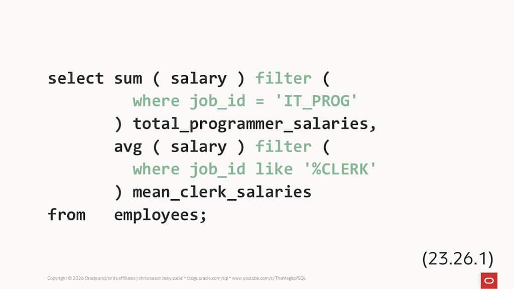

From Oracle AI Database release 23.26.1, you can use the filter clause.
Example SQL query using FILTER
select sum ( salary ) filter (
         where job_id = 'IT_PROG'
       ) total_programmer_salaries,
       avg ( salary ) filter (
         where job_id like '%CLERK'
       ) mean_clerk_salaries
from   employees;
This comes after the aggregation function. It has a where clause that identifies the rows you want to include in the calculation.
